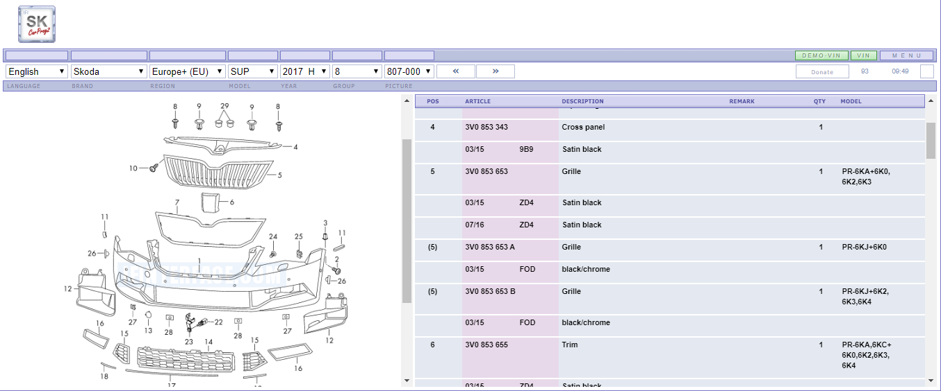

@cronemeister Here is screenshot from ifinterface.com (kind of online ETKA):
I don't know if it helps to remove it.
The grill (#5) is clipped on the cover trim (#7)  (or the contrary... 🤔) They are then clipped and screwed on the bumper.
You'll need to remove the cross panel (#4) to get easier access to:
- the 7 Hexagon socket head panel bolts (#10) all around
- the tabs all around the grill, from the inner side, to unclip them from the bumper.
Finally, be careful when ordering your new honey comb grill. There may be 2 parts to order: #5 (grille) + #6 (trim), which hides the sensor / system for ACC & Front assist.

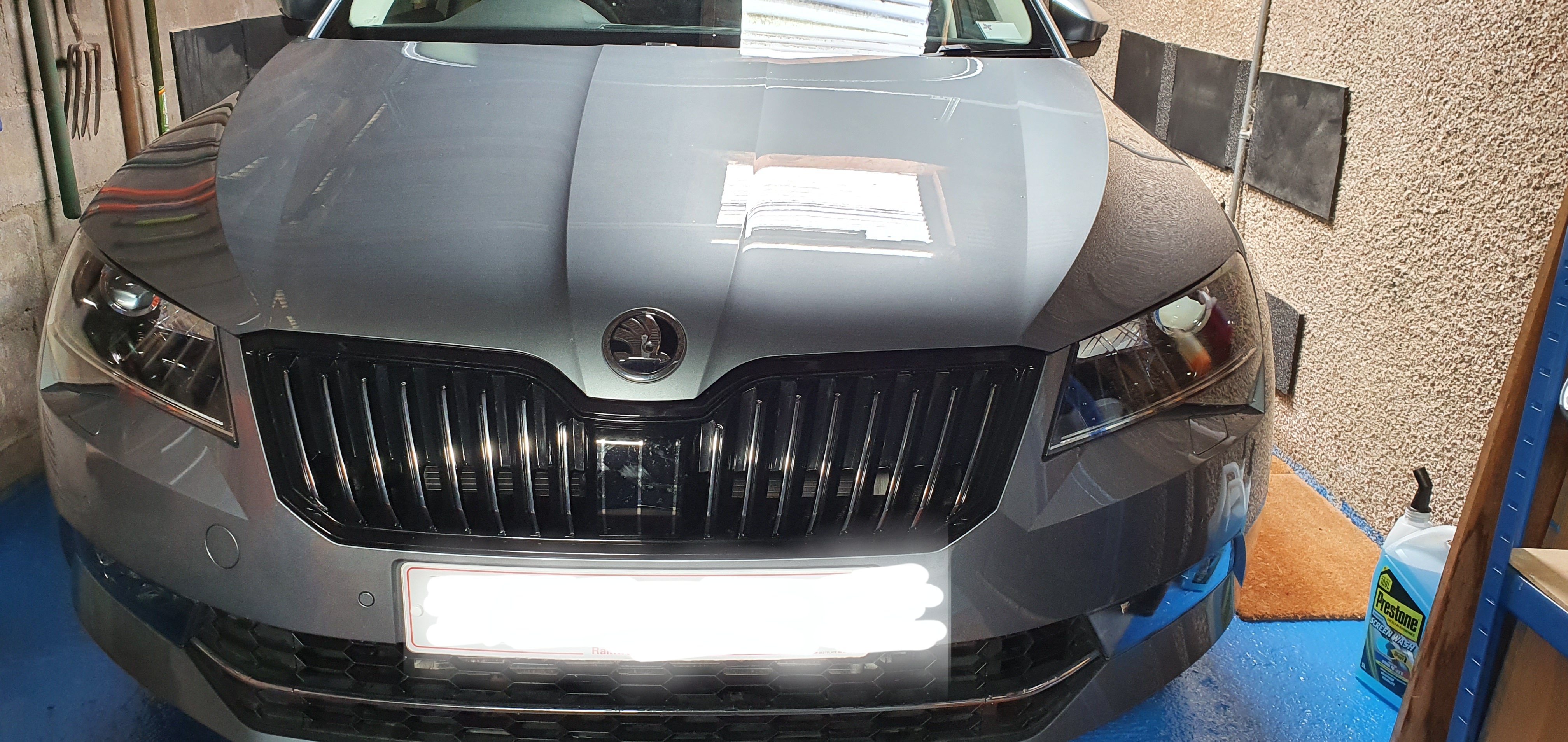

Here is my fresh install.
Otherwise it looks good, but for my taste background is too exposed.
I think I have to mod black mesh behind the grill or something...
The radiator looks really exposed to stone strikes in that picture!

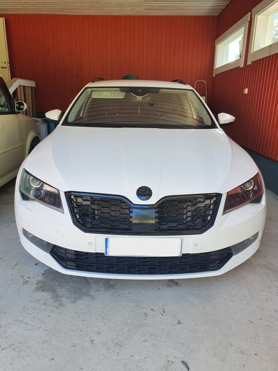

5 hours ago, Xiin said:
Heres another go at it.
Got silver mesh from local auto parts store, painted it black and installed it behind the grill and front lip also found its way under the bumper. Much better now !
That looks way way better and as @NJRJ pointed out before, less exposed n vulnerable now to stones & debri.
Good work.

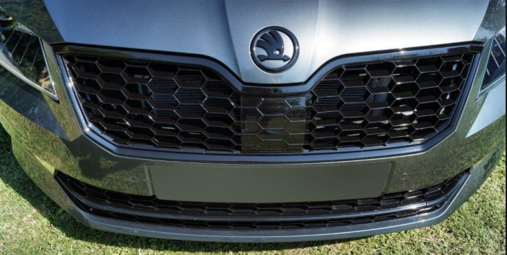

They should have the all black surround for sale. I've bought and fitted it!
Edit. Here it is: http://www.superskoda.com/Skoda/SUPERB-III/Superb-III-grille-frame-SPORT-LINE-Black-magic-metallic-paint-F9R
Edited by boydeee
Link added
1 minute ago, Max M4X WW said:
Did you fit it to a standard grille? How easy was it?
I did yes. It was a bit of a pain. But, once you see what you're up against, it isn't too bad. Just be methodical and don't swear too much!

It's hard to photograph well, but it gives you an idea 👍

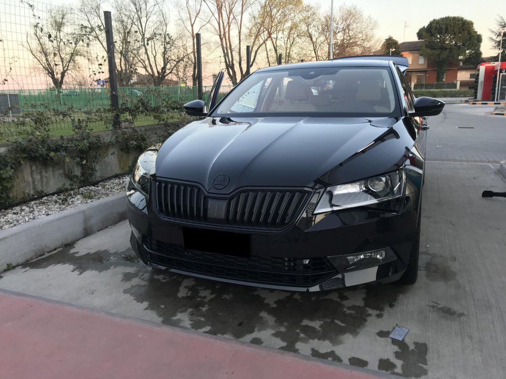

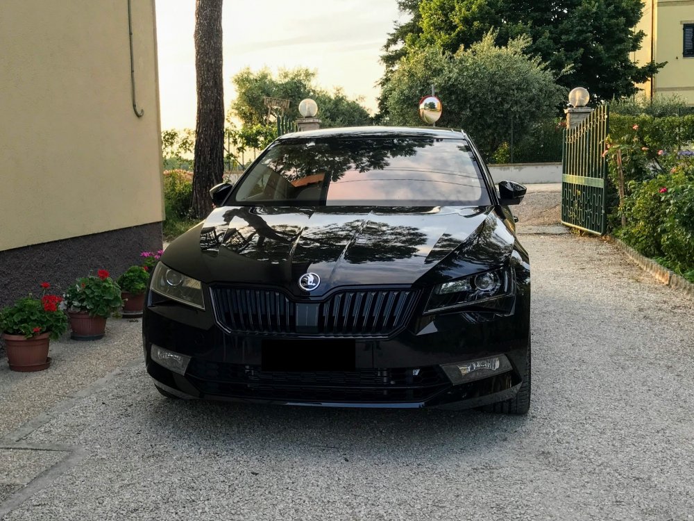

i removed the chrome trim below too, here you can see:
1) stock
2) black front grille and trim
3) black logo
@Roscio u should get the smoked black foglights (sportline version) too if u can 🙂
it will darken the front of ur car even more.
Edited by JR RS
Looks great thanks.
I have not noticed a difference between sportline fog lights before? Do they just have a smaller chrome bit?
2 hours ago, Roscio said:
3) black logo
I like this - I think this is the route ill take - get a sportsline gloss black grill and surround like this - no disrespect but I am not enamoured with the look of the honeycomb grill - mainly due to aesthetics and how you can see all the internals as discussed. I have more chrome on my front bumper ill have to sort too!! Might be going for a full de-chrome at some stage tbh.....
