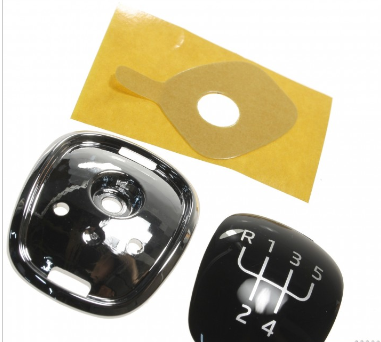

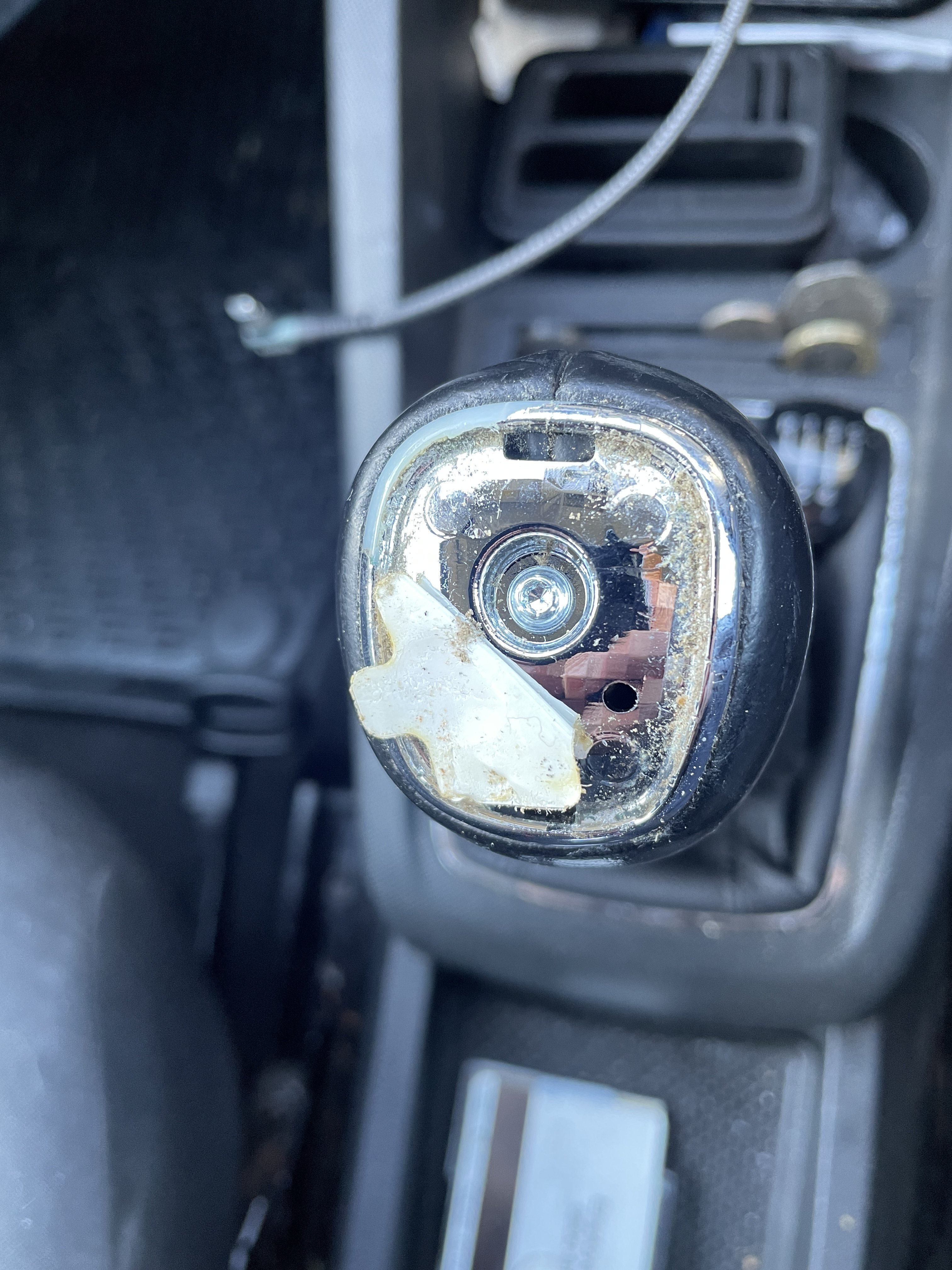

  2. In case anyone needs to change one… carefully lever off top gear insert from adhesive pad undo screw- replacement is a reversal of fitting.
  3. Hi Has anybody changed just the gear marking part of a mk3 gearstick rather than replacing the whole thing together with the leather gaiter? Top of my gearstick is worn and the chrome part is flaking off, not sure how to remove/ replace it? Skoda do sell a replacement... Thanks in advance
