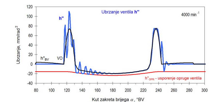

  2. It's not usual around here but I'm a weirdo in many other ways also. It's part of regular maintenance. Valves wear, valve seats wear, lifters wear, pushrods wear, camshaft wears... The valvetrain is one of engine parts that suffer the most abuse, it is critical to engine performance and tolerates no deviation from correct adjustment. You'd be surprised how much just a 0.05 mm difference means. It's not just about valve timing, it also very much controls valve bounce at higher rpms. The camshaft is precisely designed in such a way that upon the moment valve starts to open or finishes closing, the lifter is at constant speed (i.e. its acceleration is zero) thus minimizing valve bounce. Apart from valve bounce, it also minimizes the valvetrain wear. A nice presentation (in extreme conditions, however, just to clearly show the effect) can be seen on this video: This is a plot from a university textbook (in Croatian): X-axis is the cam angle. Y-axis is the acceleration. Red line is the valve deceleration caused by valve springs. Black line is the acceleration of cam-lifter contact point, and is approximately the ideal valve motion one wants at all engine speeds. Blue line is the actual valve acceleration. 4000 rpm is quoted as camshaft speed, corresponding to 8000 rpm crankshaft speed, because this effect escalates with engine speed. You can see the valve is not following the cam and bounces around. It's mainly the cause of "banging" exhaust sound you hear on redlining. So it's one of crucial things for engine performance and durability. The correct adjustment for 781.135 and 136 engines with all iron pushrods is 0.20 mm on all valves. 135B/136B, the more modern engines that have aluminum pushrods on inlet valves, and they should be set at 0.25mm on inlet and 0.20 mm on exhaust valves.

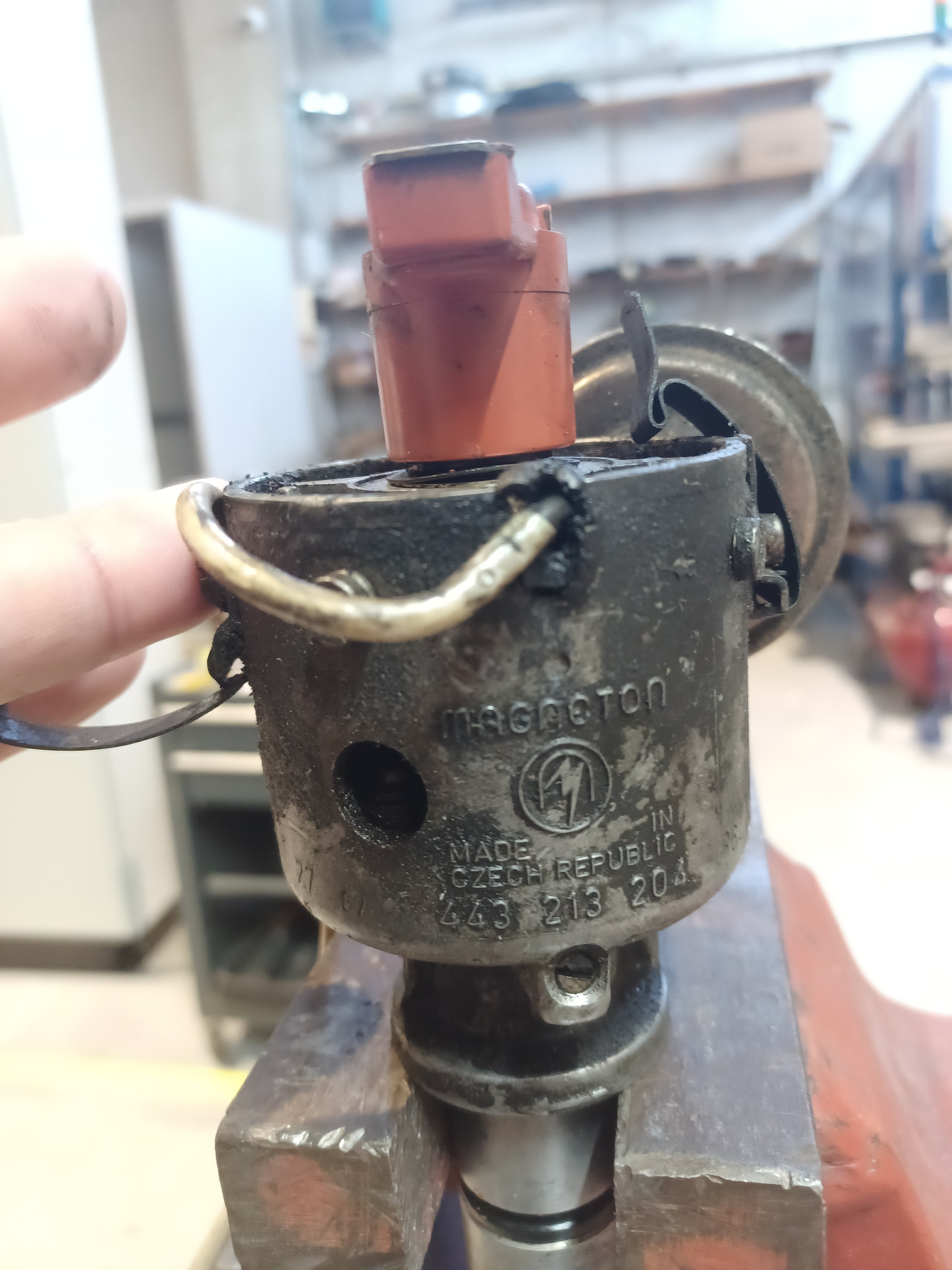

  10. Thank you all for your input. I was right, the problem was in the new distributor. Although they have multiple ignition distributors that would physically fit the 781.135 engine, I quickly abandoned the 123ignition idea as soon as I saw their prices. Searching through my stash I actually found the distributor the car came with, from the factory (mine says MAGNETON 443 213 204, see photo). Cleaned it up, filled it with oil, lubed it where it should be lubed and installed it. I only replaced the original pickup coil with a new one. Works perfectly. I guess the moral of this story is to NEVER trust new parts. Along the steel brackets issue, an autopsy of the replacement distributor found that the field magnet wasn't drilled exactly through its center, and as such rubbed on reluctor rotor. I also found large pieces of the magnet inside the distributor. So, I would recommend everyone to rather visit a junkyard and search for OEM parts, especially for a car this old.

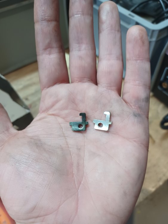

  11. I think I found a probable cause. The brackets that hold the pickup coil are made of a ferromagnetic material (most probably steel), where they should be brass or aluminum (i.e. something paramagnetic). What I'm talking about is shown on the attached photo. Left is a bracket from the original distributor, and on the right is from the new one. These steel brackets are disturbing the rotating reluctor magnetic field and wreaking havoc with my ignition timing. Now I'm trying to find the rest of original brackets in my parts stash hoping that would solve this issue, but I'm not going to assume everything else will be fine with this ****ty distributor in the future. So I'm still open for suggestions about a good and reliable replacement distributor. 123ignition maybe?
