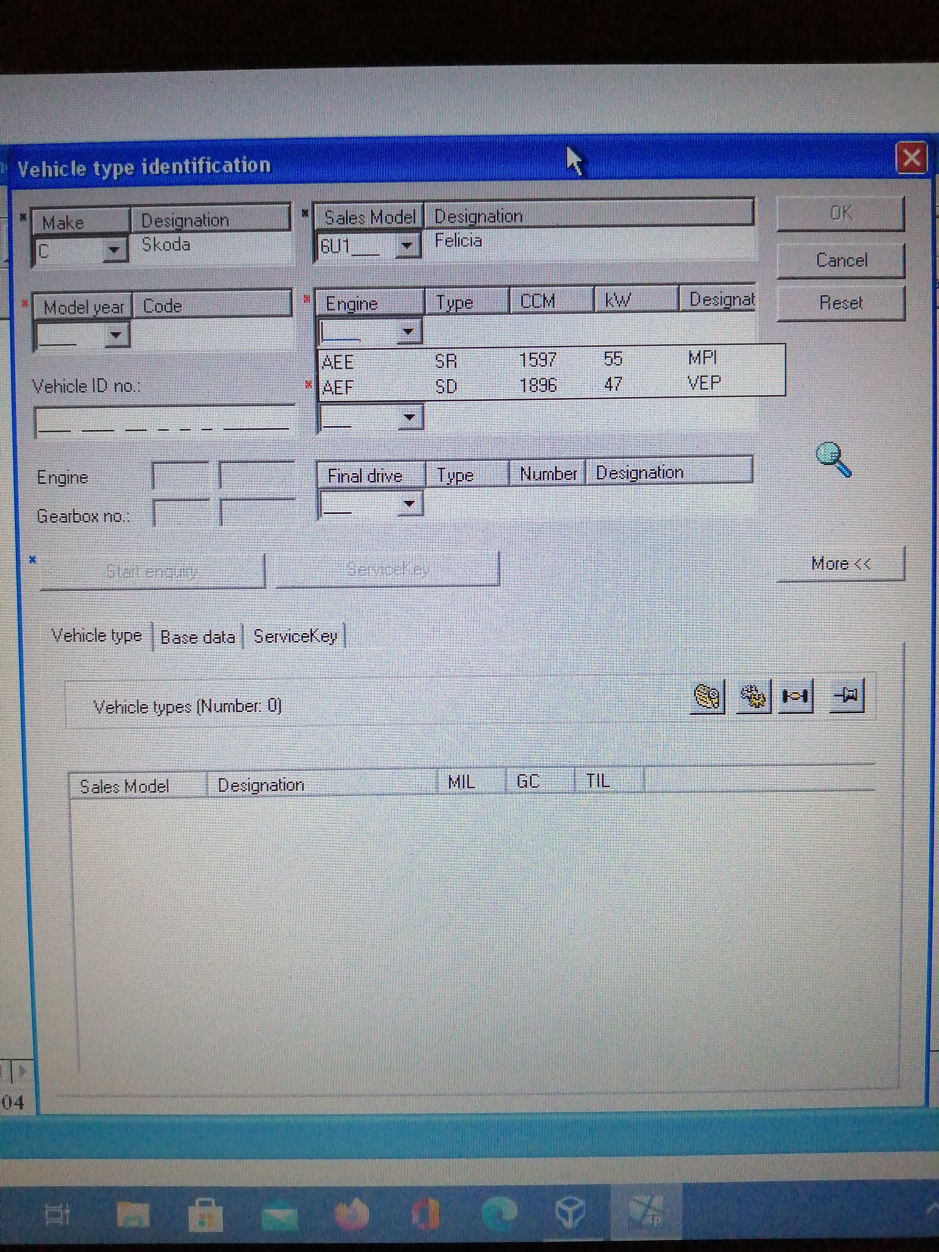

It doesn't appear to have any 1.3 felicias listed?? Only the 1.9 and 1.6? Or am I doing something wrong?

Hmm.. Yes that is rather disappointing haha. I was hoping I had found a less expensive option than vcds... Wishful thinking I suppose :( Thanks for trying it out and posting the pics 👍

Yeah elsawin, that's the one I have

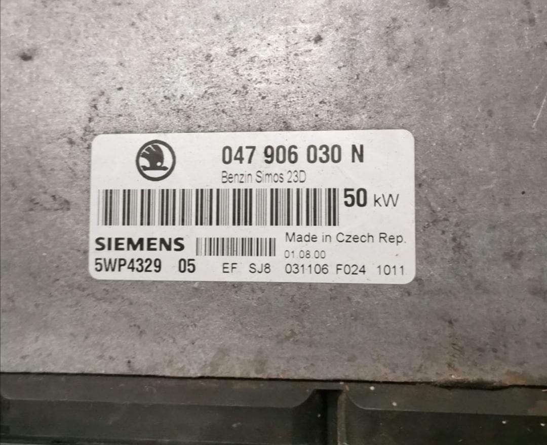

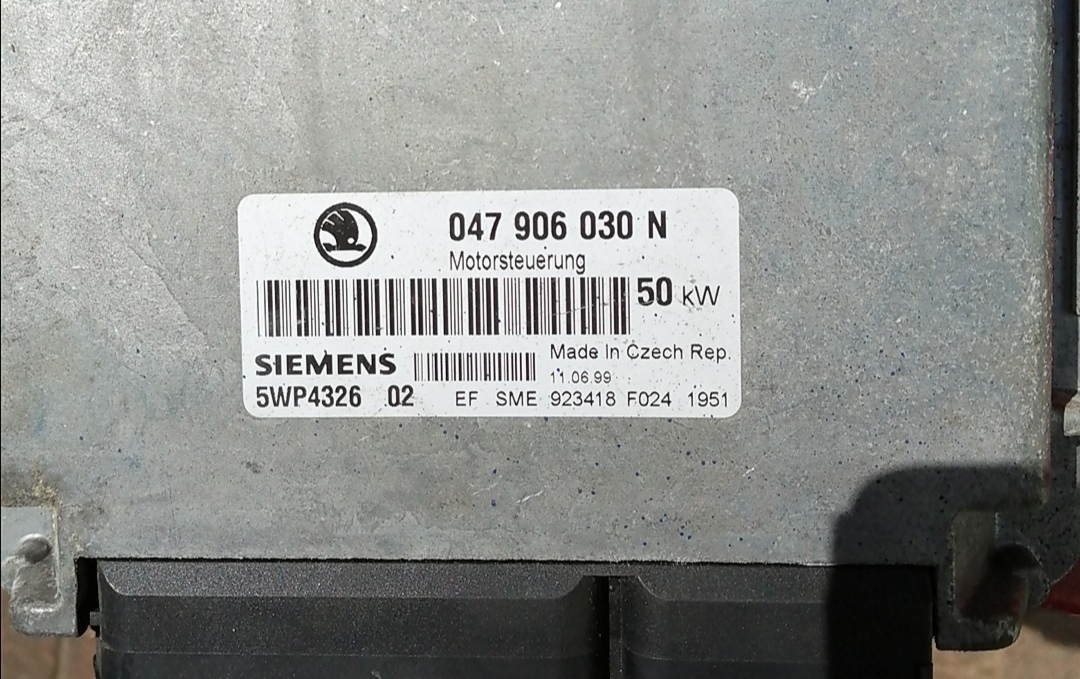

The engine is second hand yes, but I couldn't tell you how many owners it's had exactly. its also been painted so no stickers that I can see. No vin number from the car but I can get the engine number. Would any ecu for a 1.3mpi marked as 50kw work? The pictures are of my ecu (5wp4326) and one that I have been offered to buy ( 5wp4329) are they interchangeable?... Ignoring the Immobiliser issue. Thanks 👍
