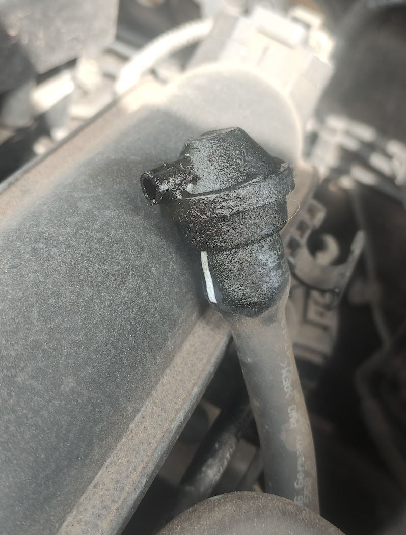

  4. Hi, Drove the Mrs' car to Manchester yesterday (about 40 miles) and noticed a hot oil smell when we arrived. Noticed it on the way back, too, when we stopped off for something to eat. I had a nose around the car this afternoon and found the problem (attached photo). I found this thread relating to it: I guess there are a few questions here: 1. Anyone else had this happen? The car is a 2014 year 1.2TSI 2. Should I be worried about the part of the assembly that must have fallen into the engine? I haven't noticed anything when I drained the oil but, then, I wasn't looking for anything, either. 3. I guess it is OK to drive as it is. It's only the crankcase gas re-circulation...? 3. If you have had this, and have fixed it yourself, where did you order the parts from? Thanks in advance

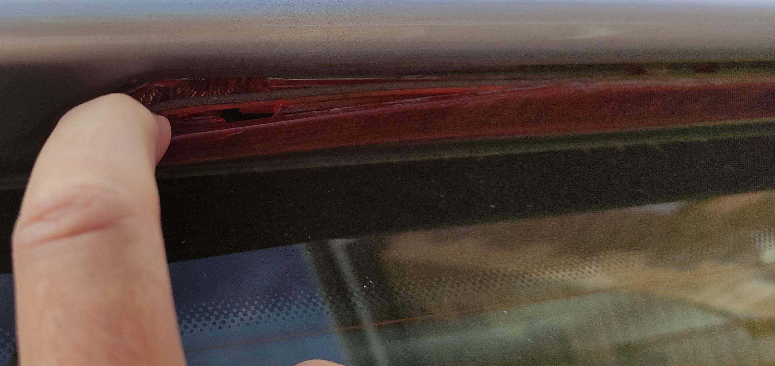

  13. Thanks for the replies and the guide - it's very much appreciated. I do have the technical skills to repair it - I can solder etc, so I'll take a look at repairing it. I didn't notice whether it was LED or filament but it looked like there were small "domes" that could have been LED or bulb...it was tricky to see, though. I wondered what the removable plug was - I shone a torch in there but didn't see much to go at. I'll take another look tomorrow. I'll let you know how I get on...!
  14. Hi, I think I mentioned that, at the last MOT, the car passed with an advisory on the high level brake light. In typical fashion, I meant to get around to it, but the MOT is up again in a month. I took a look at it this evening and it seems that it might be water ingress that has killed it as I was expecting an entire, sealed unit that popped out of the enclosure but it appears that the unit has separated. Maybe this is normal? It might not be easy to see but the face that is exposed to the weather can almost be removed from the back part that contains the LEDs. On the left hand side, it took little effort to pull the unit apart but it wasn't great all along it. In the middle appears to be a bent metal tab which I thought might be the retaining clip. At the far right, the unit separates easily again. From looking into the left hand side, what I imagine to be the seal is intact but inside the unit along, presumably, with some nice water and general grime. Is this how the unit comes apart? Is it easy to replace if I start to take things further? Can anyone recommend a source of a good replacement part? Thanks

  18. I'm not averse to a soldering iron but don't really fancy a DIY repair on a safety critical component. I'll assess the damage that the dealer wants. Thanks for help

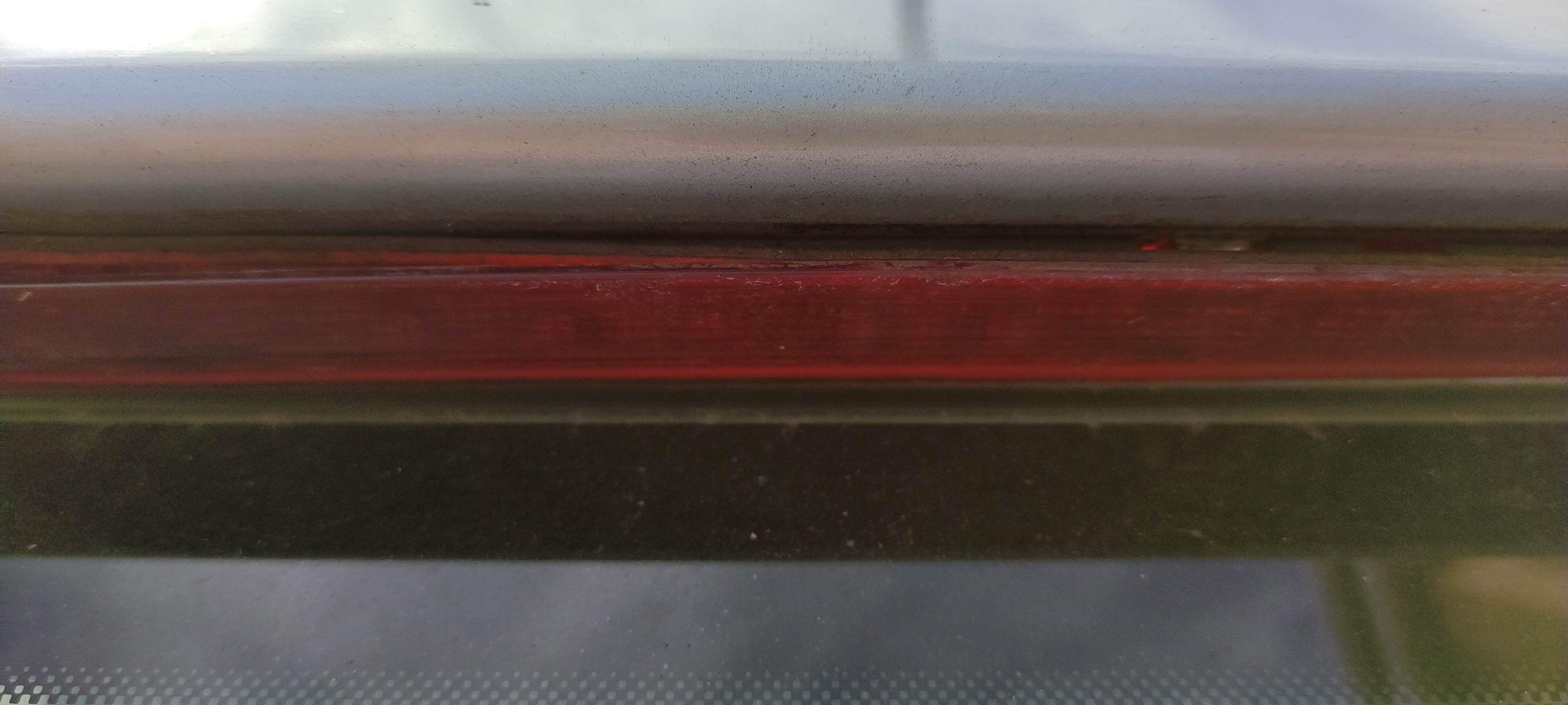

  22. This link https://mattersoftesting.blog.gov.uk/your-questions-answered-should-i-be-failing-defective-stop-lamps/ Says this Before failing an additional stop lamp for not working, you must be able to prove - without dismantling - that the lamp is complete and the wiring to the lamp is connected. The manual states that: β€œWhere extra lamps are fitted and there is doubt as to whether they are connected, the benefit of this doubt should be given to the presenter.” Seems that it is down to interpretation. For an OEM fitment, I'd have erred on it being connected. They know me well at the dealer so maybe they were lenient πŸ€”πŸ™‚
  23. It was a local Ford dealer's MOT station. Advisory states that third brake light is non obligatory. I must admit that it seemed odd - if it is required to be there, I'd imagine that it would be required to be working, too.
  24. Mrs took the MK2 combi for an MOT today. The good news was that it passed again. The bad news were a couple of advisories. First up, the high level brake light is not working. I've had a nose around on the internet and it seems difficult to replace. Through the hole, I can see a small, white plastic clip that doesn't look like it'd take much to snap off. Does this need pushing one way to release it? I also took a look at the wiring rubber boot but I didn't find a way of releasing it. Are there any guides for these? Second item was that the park brake efficiency was "only just met." I had the hand brake adjusted a couple of years ago but it seems to come up quite a way again. The MOT tester said that it was a problem on Fabia models. Is the cable stretching or is it something else? Also needs new brake pads, which I knew anyway. I think the ones on are original and it's done 56k.. Thanks for any advice.

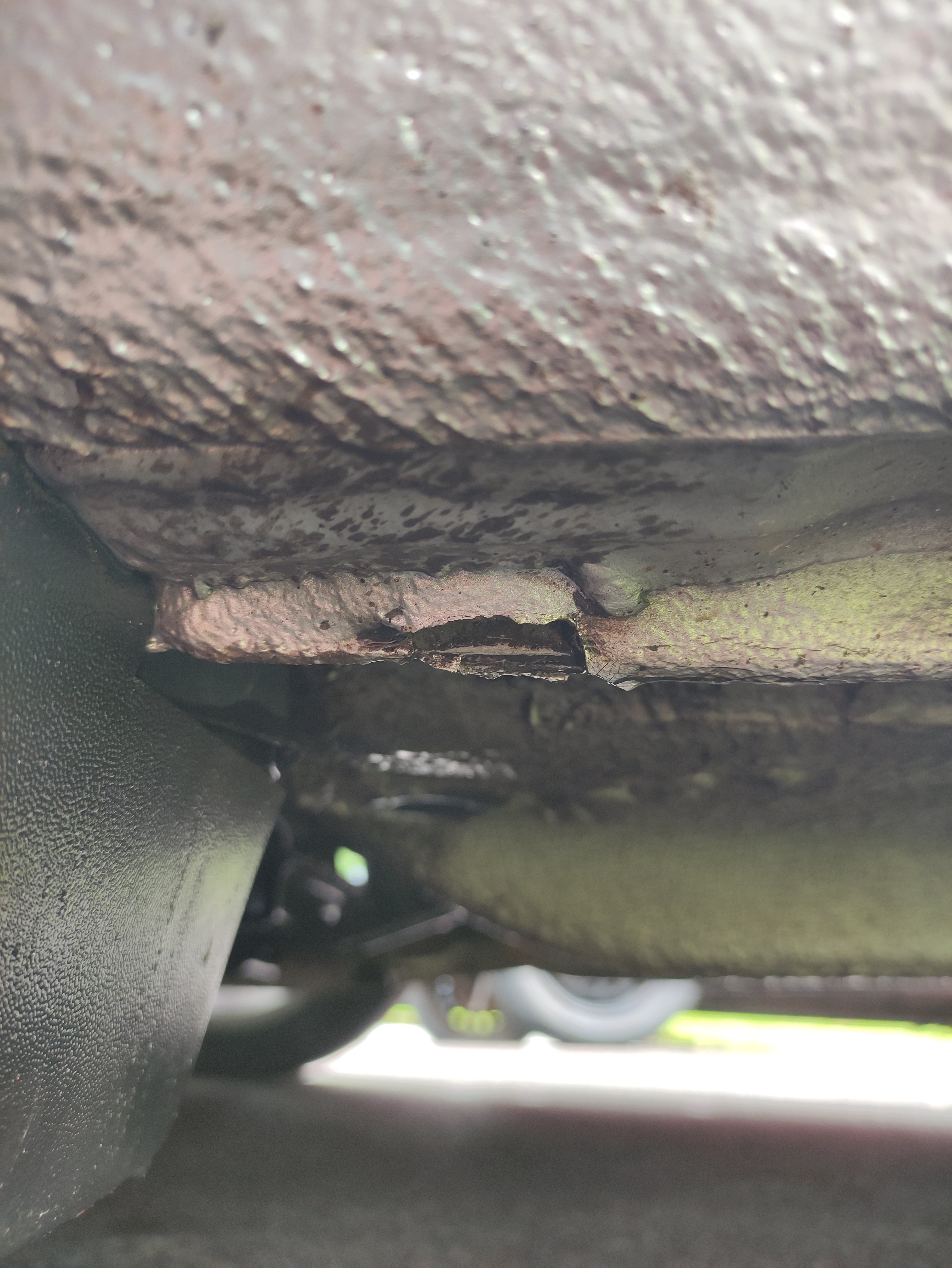

  25. To be honest, there's nothing really loose there. When it's dry, I'll probably spray it with the stone chip then put some underseal over it.
