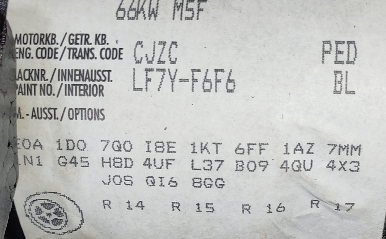

  6. Ok, so I think this sticker is supposed to tell me which brake options I have via PR codes. I think the 1KT means 230mm rear discs but the front discs come up as 1ZE to 1ZG, which doesn't appear on the sticker. Did I get an oddball factory set?
  7. Hi, Had new tyres on yesterday and saw the state the discs and pads are in. Car has done 55k miles so was expecting pads to be worn out but the rear discs, in particular, look bad; one has cracks in afew places. Was looking at some options at Euro Car Parts. I presume I have 256mm front/230mm rear (1.2 TSI 90, 185 R15s) as they look about those sizes if I get the tape measure out. Options seen to be Eicher/Bosch/Brembo/Pagidvand ATE. Out of those, I'd probably choose Bosch for both discs and pads but are they any good? I heard Pagid no longer make/they're just a brand but is this the case? Thanks in advance for advice
