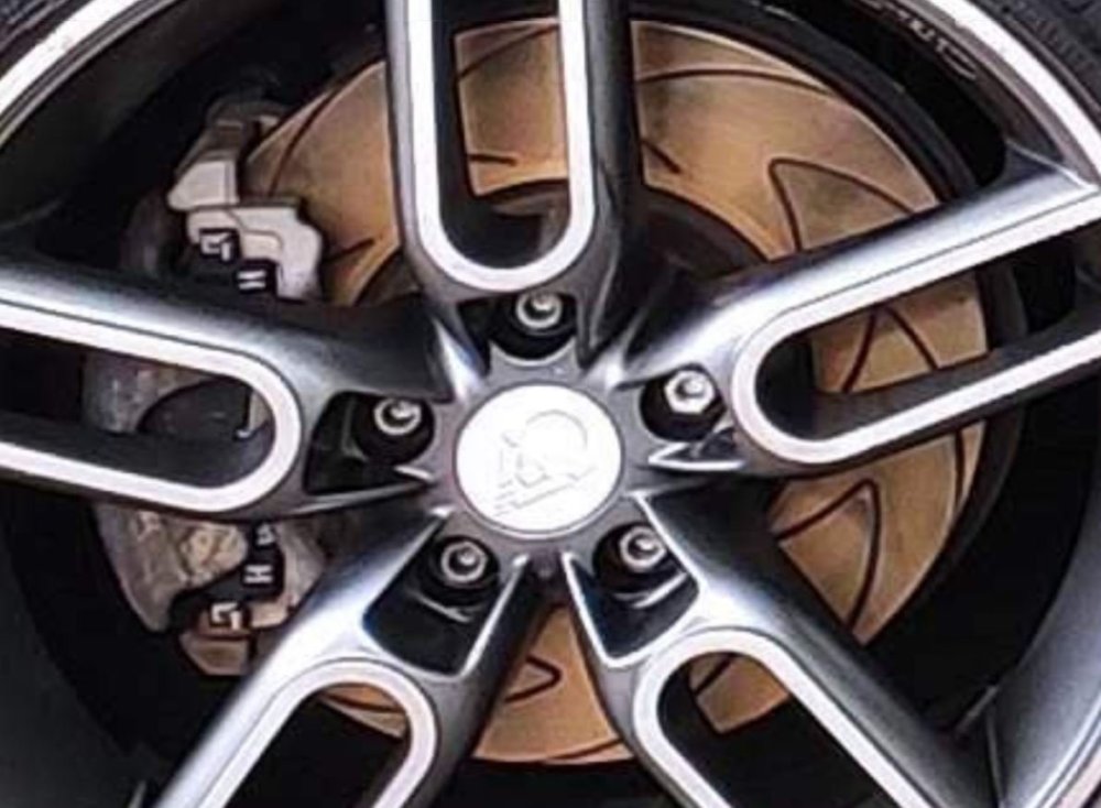

appreciate all the inputs. here's a photo of the slotted rotors when all the grooves were intact. i recall there were from ATE. I did a 288mm to 312mm rotors upgrade by changing to this rotors and by changing the clippers carrier brackets. the current pads have done 15000 miles. the rotors had done about 70000 miles. car drives well, brakes well with no vibration like those of a wrapped disc. so i suppose i could just use it and change to new discs and pads together at the end?- Grooves on Slotted rotors are being grinded away

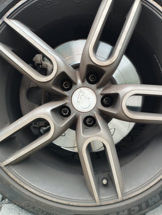

Hi guys, I have been using slotted front rotors on my 2016 Octavia. Using original brake pads. Pads are 50% used. For the last 3 months I have been hearing some screeching sound when braking. Finally I saw the grooves on the rotors disappearing. Is it normal for slotted rotors to become smooth as part of its wear and tear? Would there be other components that I should check for this case?- Flashing glow plug light - error code P0572 brake switch
