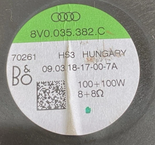

  3. Is there any information on whether 8V0035382C from B&O is also suitable? It also has the same parameters, but it was installed in other Audi models.
  4. Could the part number 8V0035382C also be good? It's also 2x8ohm, 2x100w. As I see it, these are different in that they went into different series of Audis.
