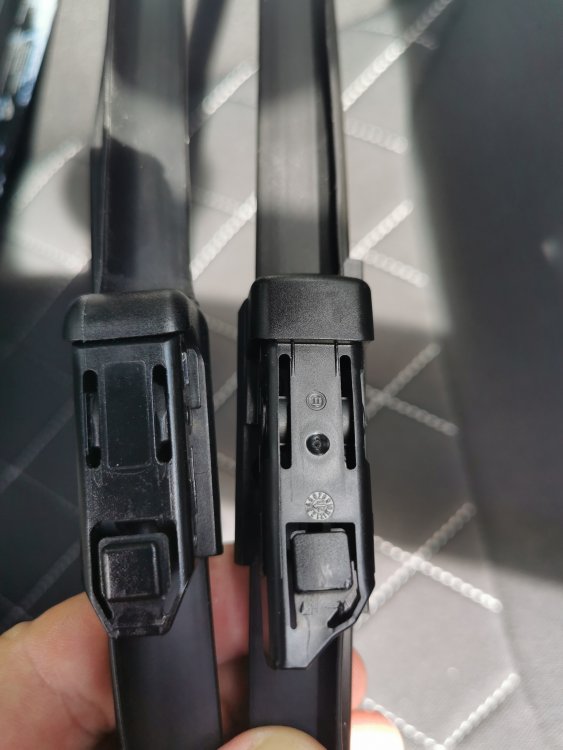

  3. If I search for A864S then Amazon wants to ship from the UK so must be a LHD/RHD thing.
  4. Hmm, I'm starting to wonder if A863S is the left hand drive fitment and that's why they don't fit. Amazon says they're the correct fitting and that A864S isn't. I'm working in France and bought them from Amazon.fr rather than amazon.co.uk I hadn't thought of that one.
  5. Interesting. Mine are A863S but the Karoq is listed on the box. I can see me taking the Dremel to them.
