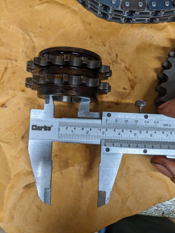

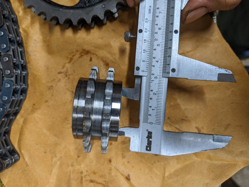

I am in the process of changing the timing chain on my 1.3l 1999 Felicia. The first kit I bought (BGA TC0560FK), the small sprocket had an inner diameter of 32 mm when the original was 30 mm:

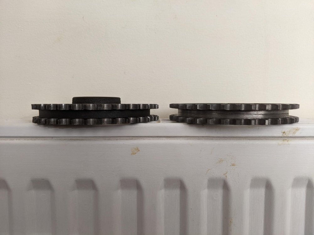

I therefore returned the kit and ordered a replacement from a different brand (FAI TCK64). The small sprocket from this kit appears to be correct, however the large sprocket is missing a boss on one side and so will not sit in line with the small sprocket (original on left, replacement right):

Yes, because you have a facelift car with a 30mm sprocket, and pre-facelift was 32mm...
BGA does not produce a facelift timing chain
The part number you need is 6U0198026A
NOT 6U0198026

Thanks for the reply. Do you know if a kit matching 6U0198026A will also have the boss on the large sprocket? The FAI kit I have at the moment does have the 30mm sprocket, but still doesn't fit because the large sprocket is wrong.
It should

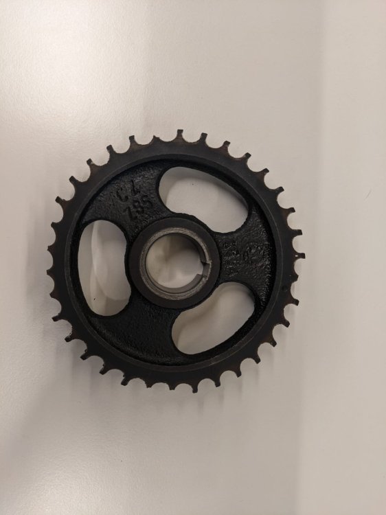

For what it's worth, at 195,000 miles my timing chain looked like this:
The large sprocket has lost ~14 teeth, probably not far away from catastrophic failure...

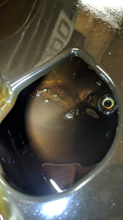

And the oil pan is full of teeth and metal shavings:
Shockingly, the car was still running fine before I took it off the road to start this maintenance. Hopefully the metal shavings haven't caused further damage to the engine, we'll have to wait and see.

WOW, the amount of slop is fine, but the missing teeth are not! Judging from the color of the varnish, I would say you were doing 10.000km changes and using mineral or semi-synthetic (i.e. glorified mineral) oil.

Nah don't stress about it, they cannot get past the pickup and if they do they will be caught in the oil filter, the worst thing is causing some marring on the pump gears

And my engine does indeed seem to be running OK despite all the metal shavings, fingers crossed it stays that way!
Yeah, I am happy its working. Again don't care about the shavings. The larger ones will not get past the screen, the smaller ones down to 20μm will be stopped by the good quality oil filter. Anything smaller is smaller than bearing clearance so it will just float in the oil without causing damage. It can only damage contact-based systems like camshaft followers (flat tappets).
