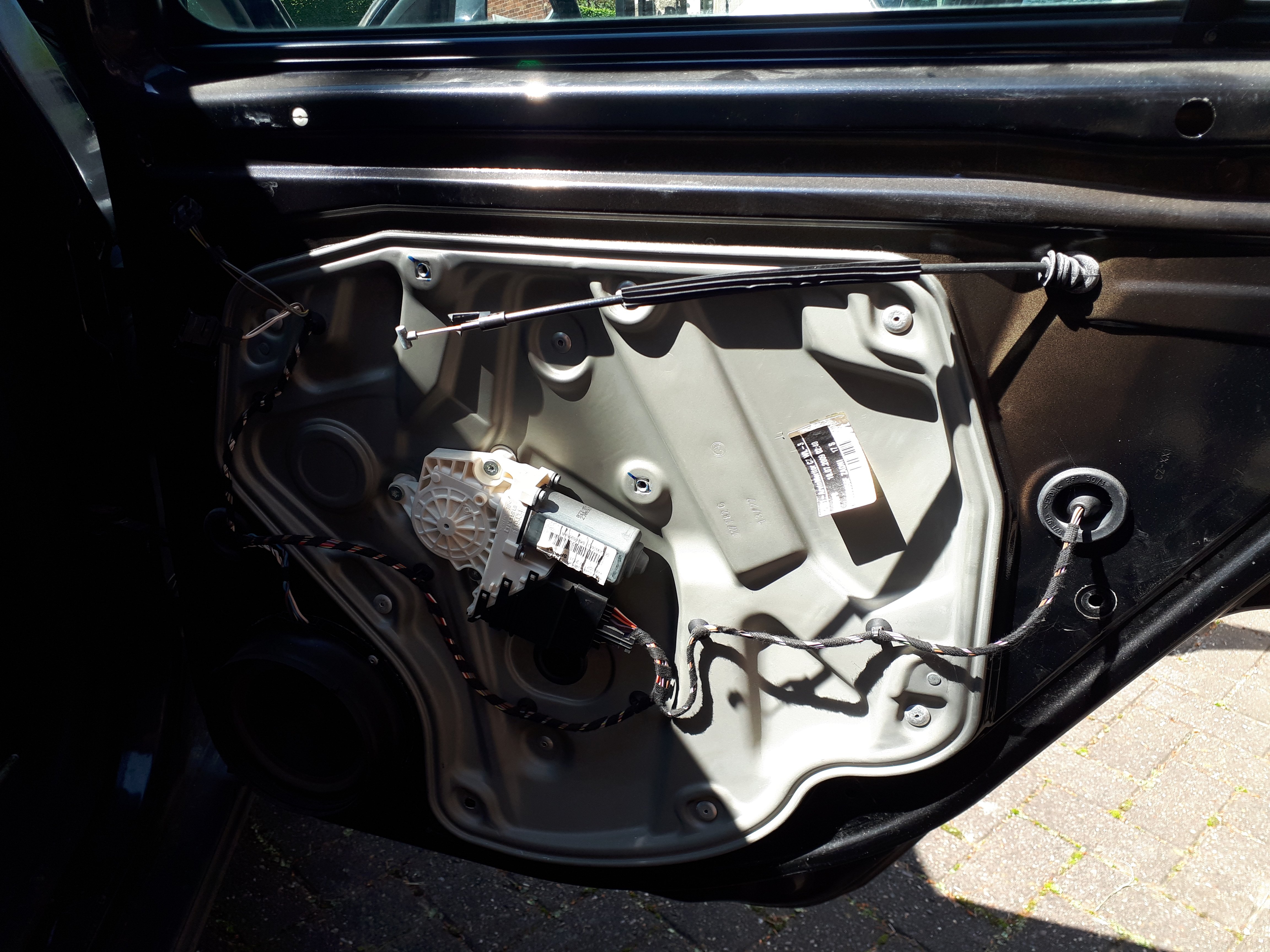

  5. I think it's a common problem. When I bought mine, half of the speedo leds weren't working, then they came on for a minute, then went off. I have been gradually losing the leds on the whole binnacle since then. They still flash on and off occasionally, but mainly off. There are companies out there who specialise in repairing the binnacle, fitting new LEDS etc. I found one about an hour and a half away in Leicester, they repair the binnacle for about £185. Not going to bother with it now because I'm selling the car.
  6. I was going to replace the brake lines myself, we have the kit to do it, but after having a look at the state of the connection to the brake hose, I decided to let my local garage do it. It only needed a small piece putting in where it had corroded, they tried to flare the original pipe but it kept splitting so they ended up replacing the whole pipe and hose. It cost £140 but it was worth it for not having the hassle, plus he lent me a car for the Day!
  7. All done, I figured the spool/reel window mechanism out, put it all together minus the little spring/clip on the door lock, and re attached the external door pull cable which had never been connected since i bought the car, and now it all works perfectly. The door opens from the inside, outside, locks, unlocks, the window goes up and down. Pleased with myself!!

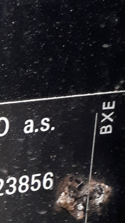

  12. Would this be it? BXE? Its on the chassis plate, didn't notice it before.🙄
  13. Thanks Gaz, that seems a lot easier than taking off the exhaust from the turbo as I've seen in the You tube vids. Still wondering how to find out what my engine code is though.
