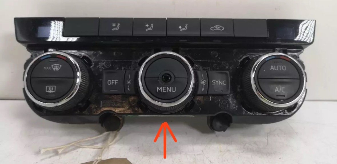

  4. Hi, No, there is no button on the HSW that was made for the mk3, albeit the mk4 wheels DO have a button, it’s just a bit more involved to get it working. However, the HVAC menu is accessed by pressing the ‘menu’ button in the middle of your climate control module: Once the HSW is installed and coded then you press that button to access the menu for it 👍🏻
