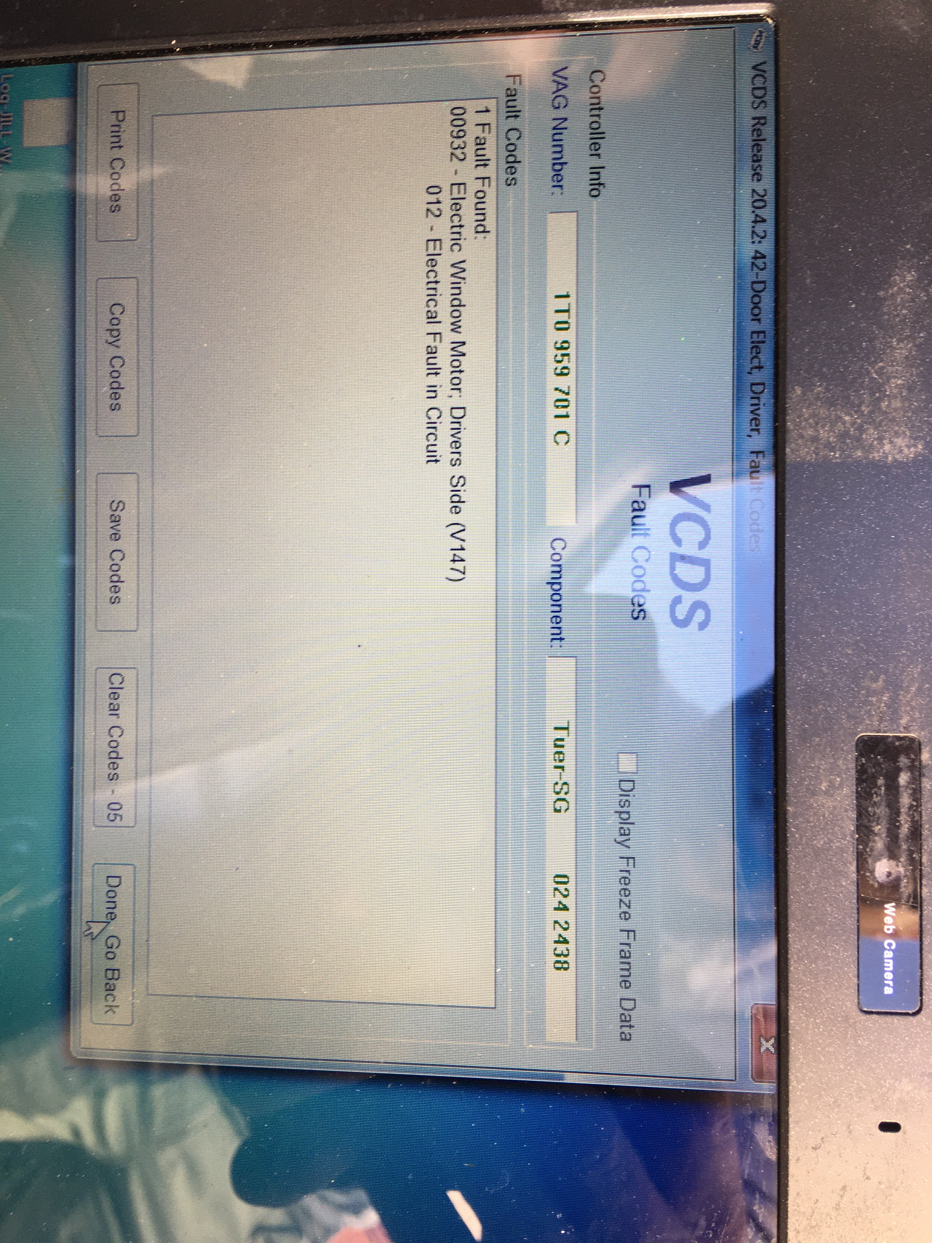

Hi all The driver window on my Octavia 1.6 FSI L&K was intermittent then stopped working. However I can still control all other windows from the driver door switch panel. Not sure how or why but does. I had an auto electrician diagnose it as a faulty motor (regulator) by plugging it in. He checked all electrical plugs that meet the body of the car, which looked ok. I got a replacement window motor, which I changed myself watching YouTube videos. I was pleased I was able to change it, as once I had the panel tools it wasn’t a hard job. Unfortunately this hasn’t fixed the problem, which suggests it wasn’t the motor/regulator. I then had a good look at all the door plugs and discovered the big red wire was loose. I have had the auto electrician come back and he resoldered the red wire to the black plug. However this still hasn’t worked. The error now shown on the diagnostic is attached. 00932 - electric window motor (v147) 012- electrical fault in circuit I was wondering if anyone has had this before or can suggest what I could try to fix it. the auto electrician suggestion is to get a secondhand wiring harness and then use the black plug to resolder all leads to the existing harness, as better than trying to replace the whole harness in the door panel. Also do you think there is possible corrosion within the plug wiring on the car frame side? Any suggestions welcomed. thanks

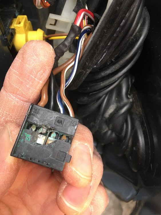

Hi there Found this post and photo, I was wondering what is the middle black plug with the thick red and brown wire? my gut says it Is power to the window motor? How would I go about repining the thick red wire as mine looks like oxidisation (blue) and is loose? Or do they sell the black pin block? Any info on part number or size of pins would be really helpful Many thanks
