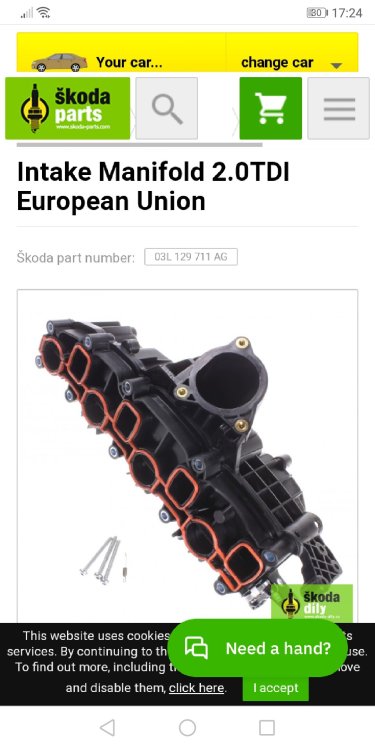

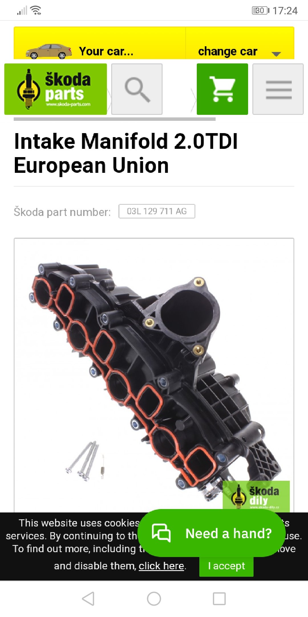

  8. So 2010 2.0 TDI 170 Superb engine CBBB. Have code 2015, swirl flap motor fault, have read all about it, and know that my plastic intake manifold has to come off to fit modification bracket. To remove manifold I need to disconnect and move fuel rail/fuel injector pipes to gain access to a couple of the manifold bolts. My question is on reconnecting fuel pipes will I need to prime diesel system to remove air using VCDS? Is this necessary? I don't have this software so is there an alternative method other than VCDS? Anyone in Edinburgh area who has access to software by any chance? Anyone done an intake removal before on this type of engine and could offer any advice it would be much appreciated. Cheers
  9. This is the manifold I have fitted, the motor fits behind the black plastic lug on the RH side of the manifold
  10. Hi, yes I've seen that video but my manifold is all black plastic. The 3 mounting bolts face rearwards and look like that even when undone the motor will not be able to be removed. If anyone has done this or removed the manifold with motor attached that would be really helpful. Cheers
