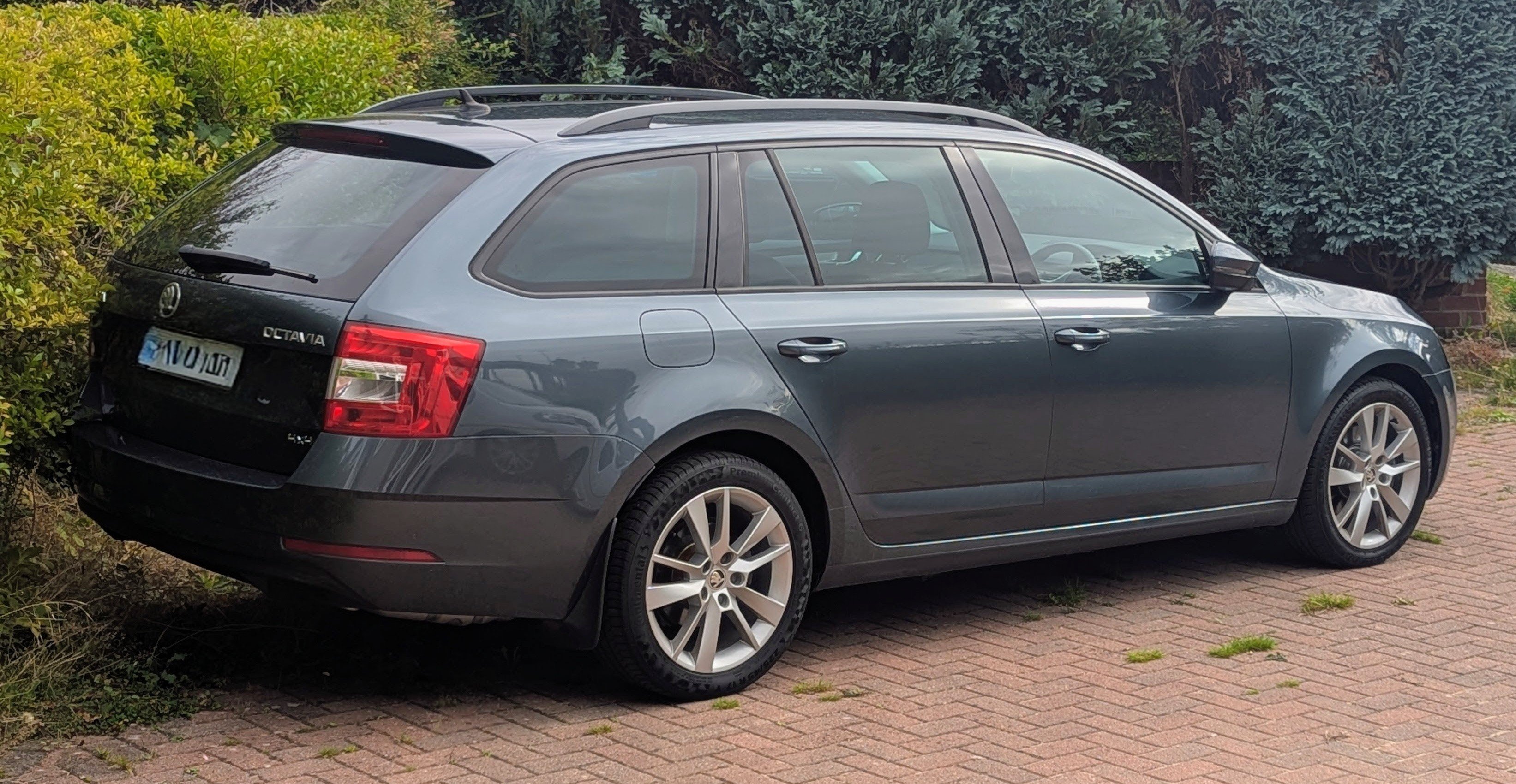

  1. They've replaced 2 coil packs and spark plugs, getting it back soon....
  2. Independent. I'm in the 30 days right to reject. The dealer has offered to put right any repairs free of charge and offer 12 month warranty up to 2k
  3. Got a code: P0304 Cylinder 4 misfire. Simple repair?
  4. P0304 cylinder 4 misfire detected
  5. Engine number is DKZA050876
  6. Think this was registered in Hampshire / Dorset area number plate is HX19
  7. Nothing to support it being a scout and the cylinder capacity is 1984
  8. RAC check says it's 4x4 petrol and hasn't been written off
  9. Also the 4th character of the VIN is M - Combi, right-hand drive, 4x4
  10. How can I check? It's 100% a petrol. Fuel cap says E5, engine says TSI and I've been running it on petrol
  11. MOT check on gov.uk says it has 1984cc engine. Door pillar has code of DKZA It's a petrol facelift Octavia with a 4x4 badge on the back. Fuel economy and handling also suggests 4x4 (it's not a scout) Can anyone help me get to the bottom of what car I have??! Thanks
  12. MOT check says cylinder size of 1984cc. How do I find out what it actually is please?
  13. Sorry, don't know... Just having a moment I guess. Worried that I've put a lot of money to a car that's going to give me grief.
