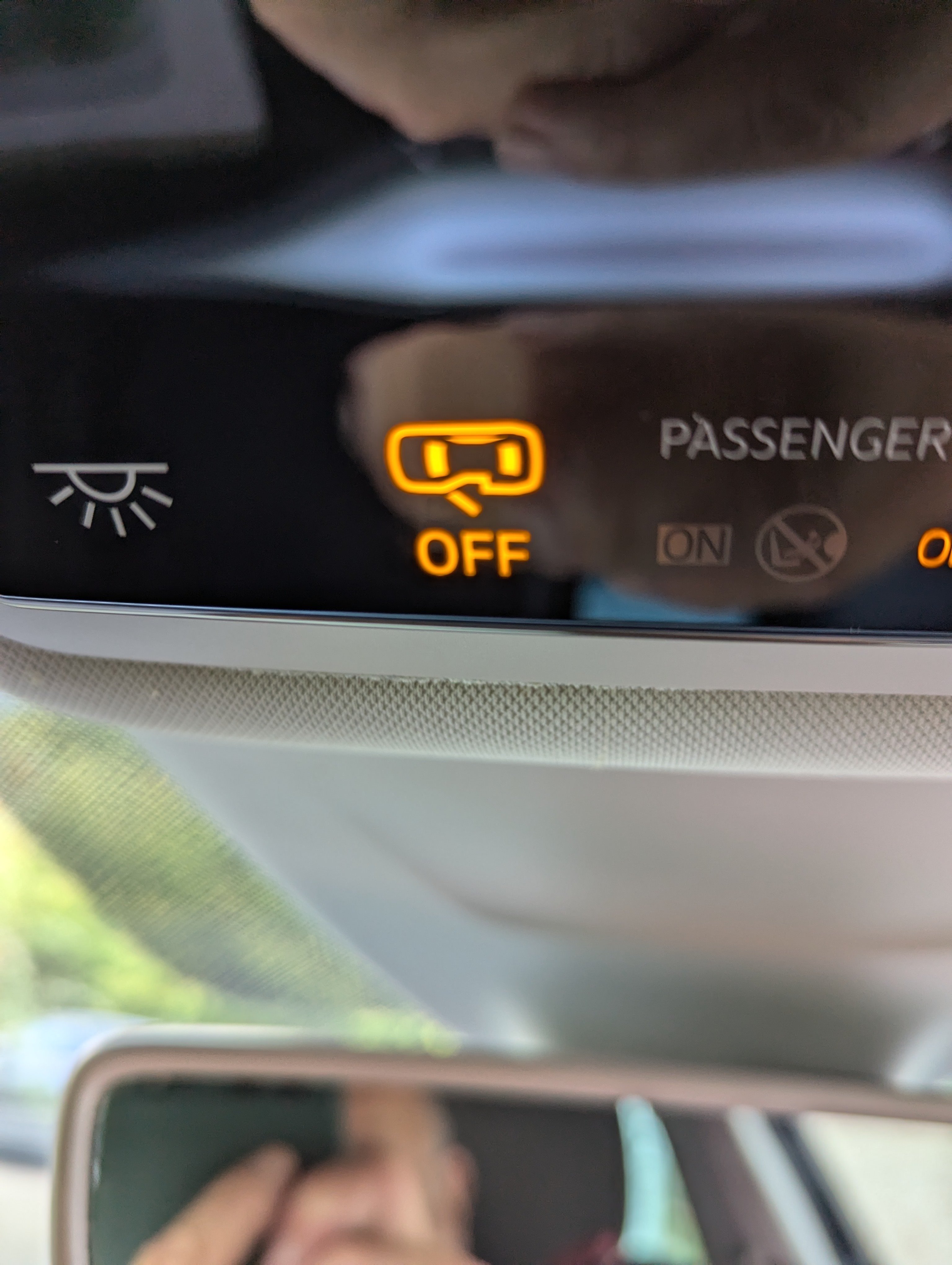

  11. Wife’s car, Octavia Mk4 hatch, but I’m curious. In the overhead display, to the left of the passenger airbag warning, is a lit yellow symbol. Looks like binoculars or an open car door or something, with the word OFF. I haven’t a clue what it means. Pressing it turns off the light but it still reads ‘off’. I’ve searched this forum, I’ve googled it, (reverse image search, lens, the lot) but I can’t find anything except a reference to ‘Active Driving Display’, which may or not be attached to that symbol. If that means a HUD, then the car doesn’t have one. Anyone enlighten me? I need to know or I can’t sleep. Thanks.
  12. Ah, OK, Mk 3 and Mk 4 must be different then. Thanks.
