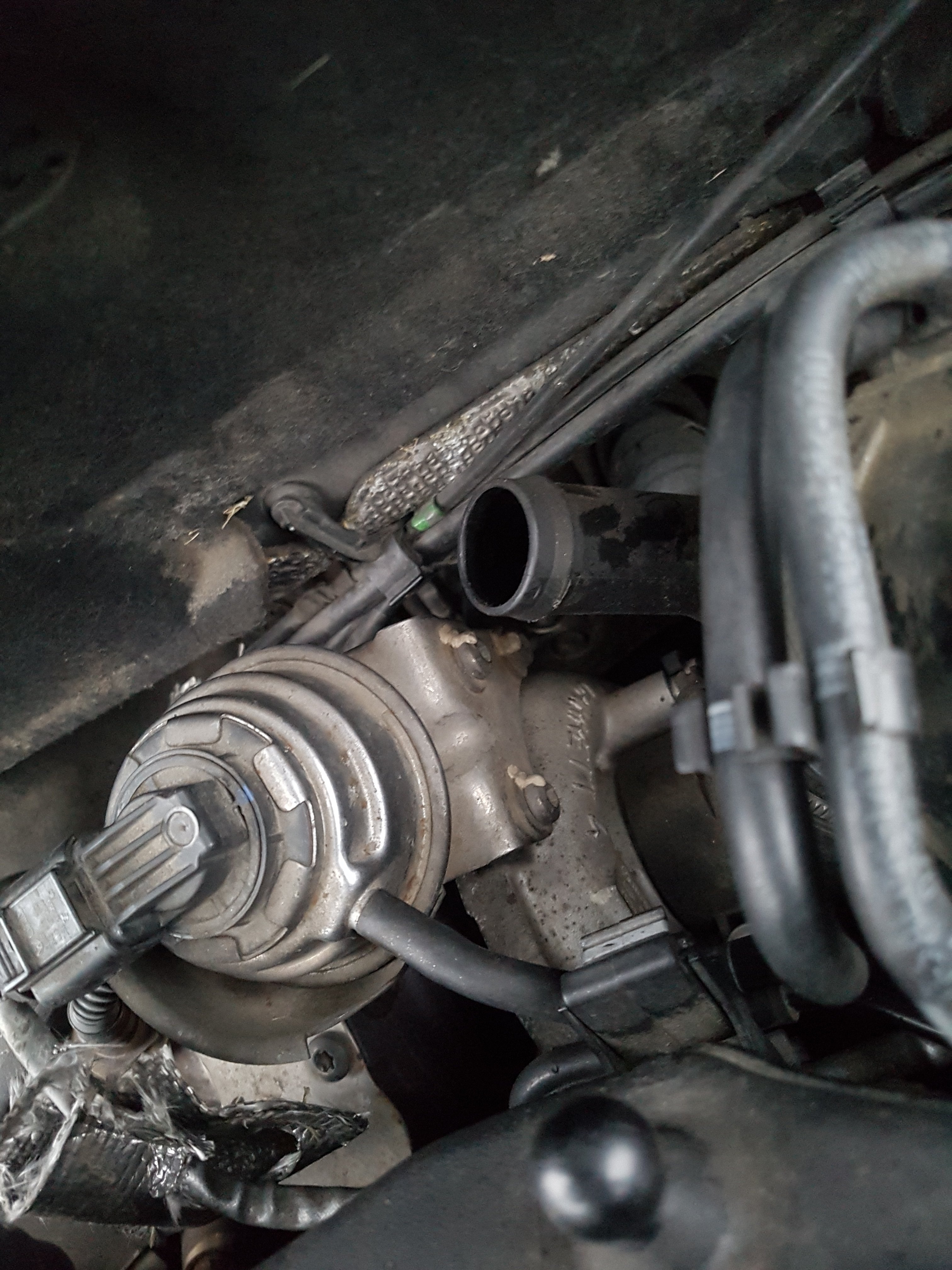

  17. Ok so it's still saying the actuator is stuck and flashing the glow plug light, however it's always on now from about 30-50 seconds after start-up. It sometimes throws up an implausible signal code from the actuator position sensor circuit. I've put a new actuator on it (does it need to be adapted?) I've followed the wires all the way back to the ecu and removed the ecu and cleaned everything around it, unplugged it and checked for corrosion, all good. There's an earth connection near the ecu where the cabin air intake is and I've cleaned that! I've cleaned another couple of earth points as well, one behind the washer bottle filler neck and the other in the left hand side of the chassis in front of the wheel well, all were pretty good. I've replaced the N75 solenoid as well. None of these have made a blind bit of difference! I now have 2 working actuators and 2 working n75 valves! The egr valve diaphragm is leaking a bit and doesn't allow the flap to fully open it leaks above 10mmHg. This egr was replaced a few years back and it's a pig of a job to do and expensive so I'm not looking forward to that but in the meantime, thinking that the leak here was causing the turbo actuator to fail I blocked the vacuum pipe going to the egr but this also made no difference. As an aside, in case it matters, the satnav isn't working because the antenna is saying short to ground and the parking sensors have decided to give up as well saying the inner left one is kaput! Any Sherlock Holmes out there able to deduce anything from all this? Quote Reply Report •••

    Hi, yea, it's a relatively easy job. Getting the e-clip off is the hardest. I put a t shirt down behind it so it wouldn't fall down behind the engine. Didn't cure my issue though and I'm still trying to sort it, See my post about the actuator limp mode. Mines a 2.0tdi with a garret turbo.
  23. Hi, mines a 2012 2.0L tdi 170bhp yeti and it's going into limp mode on just about every journey, especially when cold! It keeps saying in vagcom that the actuator is stuck or else, but less often, it's saying "turbocharger boost control position sensor circuit, implausible signal". I've replaced the actuator and the turbo vane lever moves freely without any restrictions, I've checked the lines using a vacuum gauge/pump and all were fine except there seems to be leak in the line going down behind the engine to the egr. I blocked this pipe to see if that changed anything but it neither showed an egr problem or cured my actuator problem. So that seems to be just another problem to sort at a future date!!! I've swapped the n75 valve as well with a working one and that didn't fix it... any suggestions or anyone experienced this before? It's cfja engine, thanks.

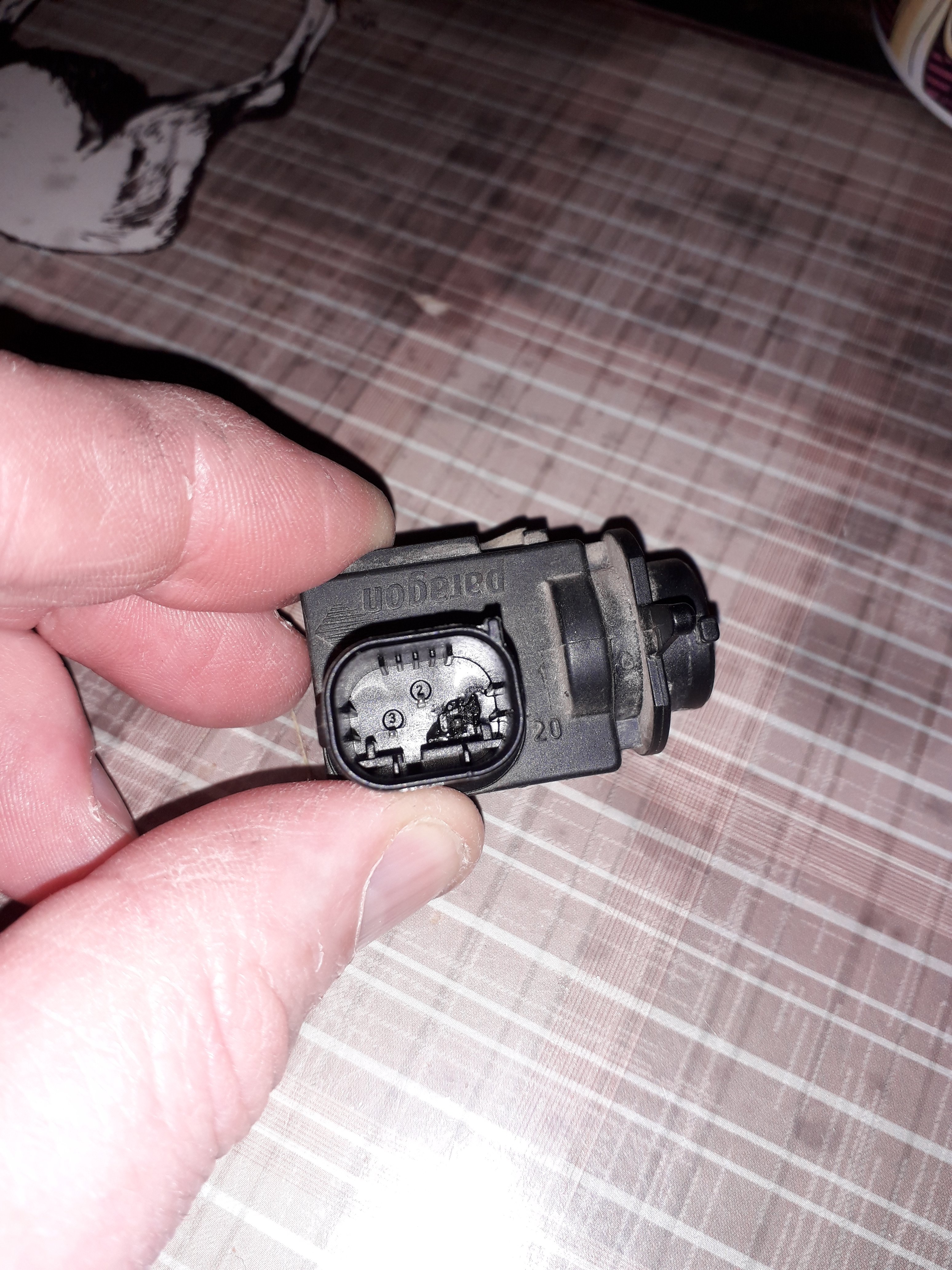

  24. I just had the same happen to my yeti. I was driving along and got an awful burning smell. I thought someone was burning tyres or something but discovered my oil temperature wasn't showing any more, then the oil sensor warning after I stopped later. It wasn't until after it'd bought a new sensor, which didn't fix the problem, that I noticed the reversing sensors weren't working either. Finally I had two problems to search and one mention to Google brought up this thread and I went straight for the air sensor and sure enough I could smell it before I even unplugged it. You can see here where pin 1 had melted and burned out the fuse (which is the second 5amp down in the middle column of smaller Fuses located at the driver's door side of the dash. Ordering a new one tomorrow! Thanks everyone!
