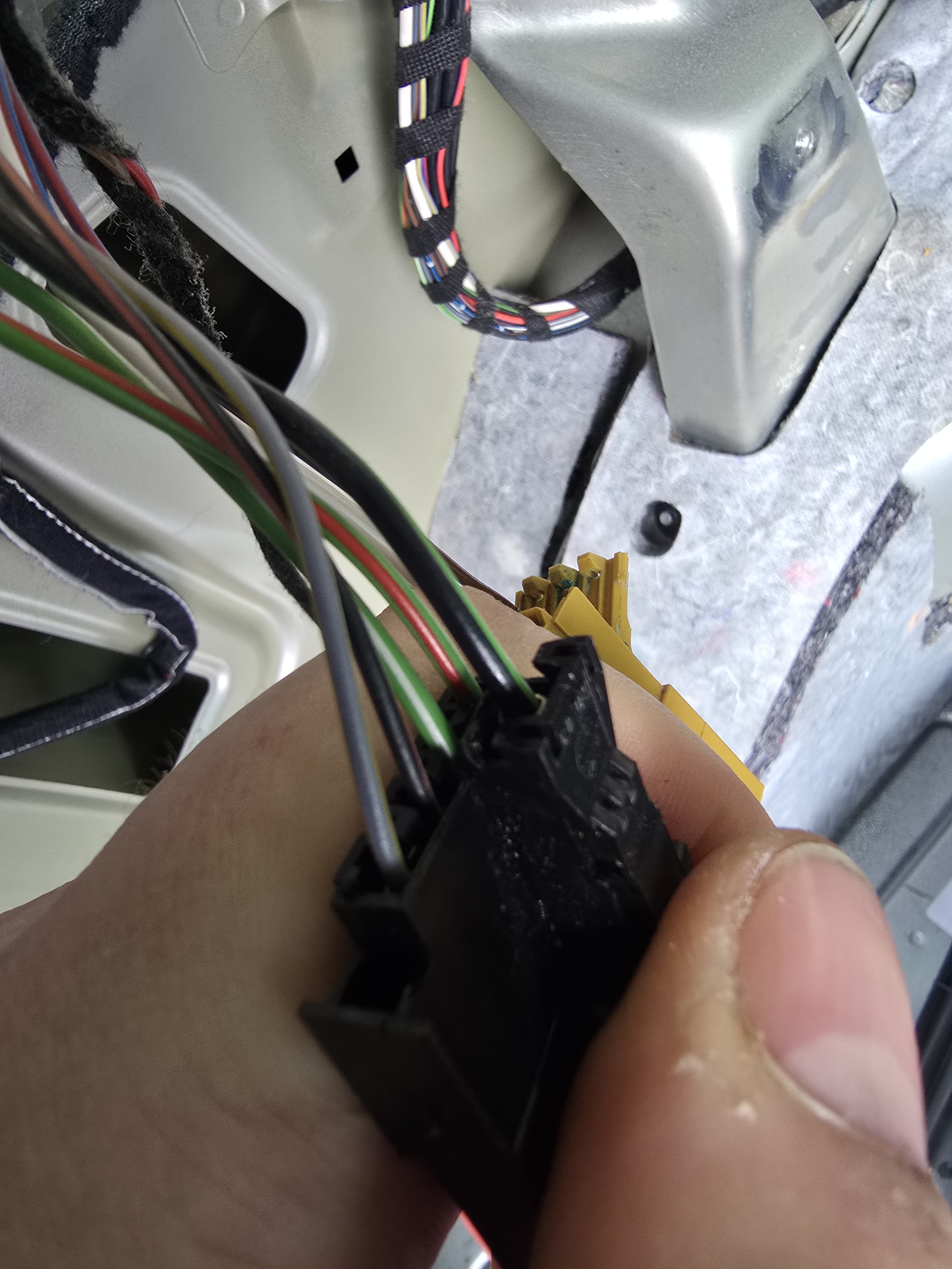

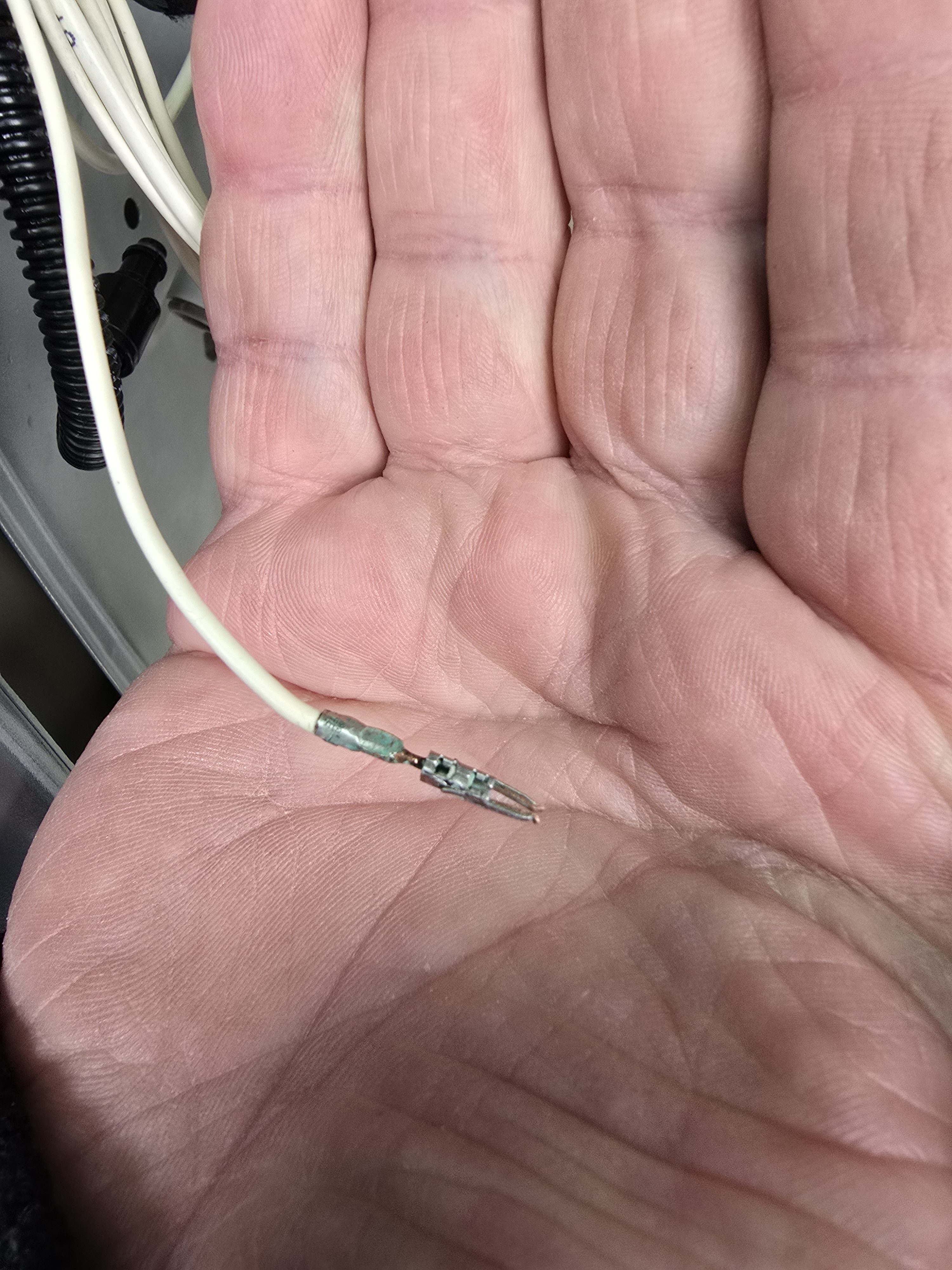

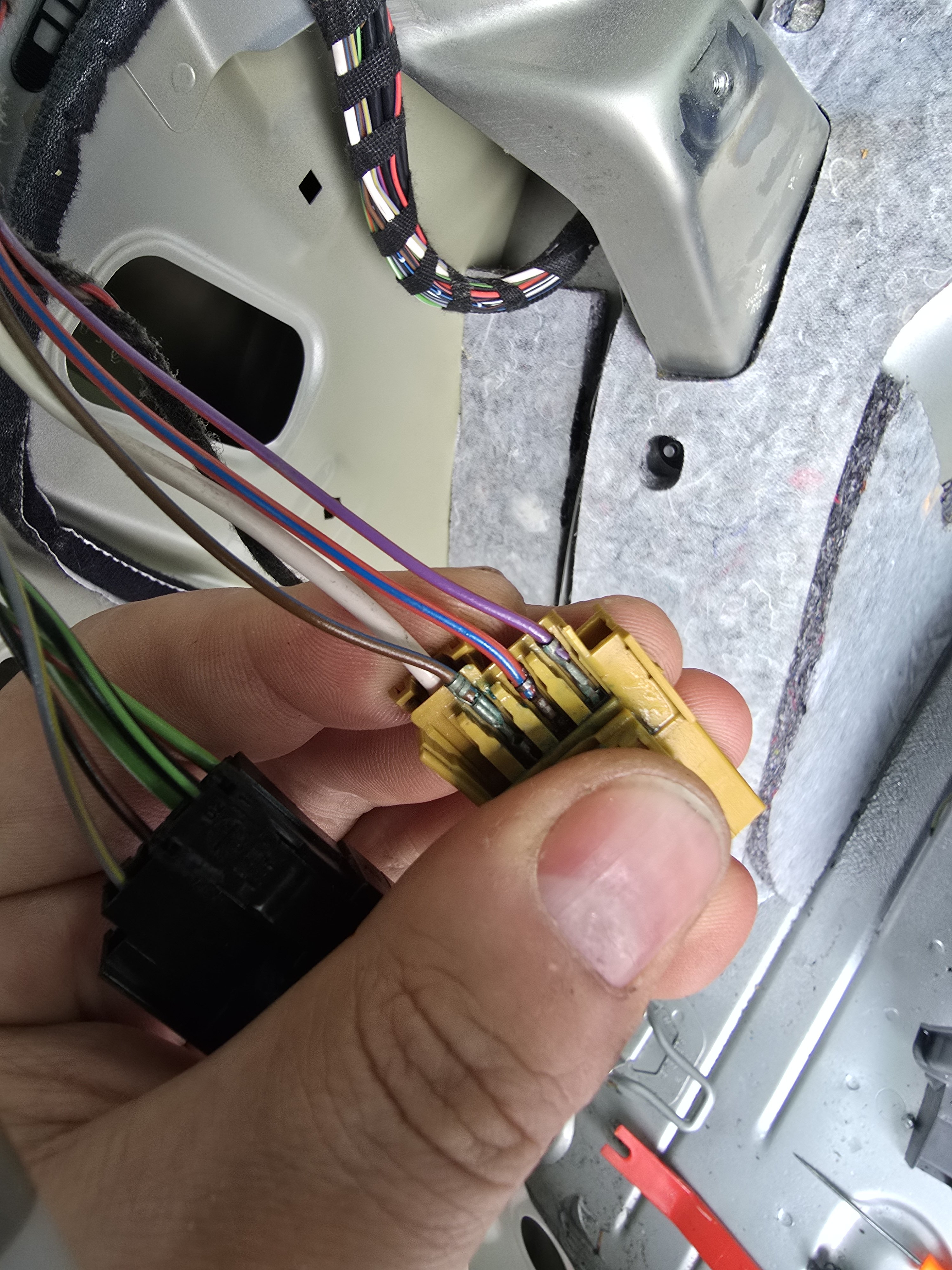

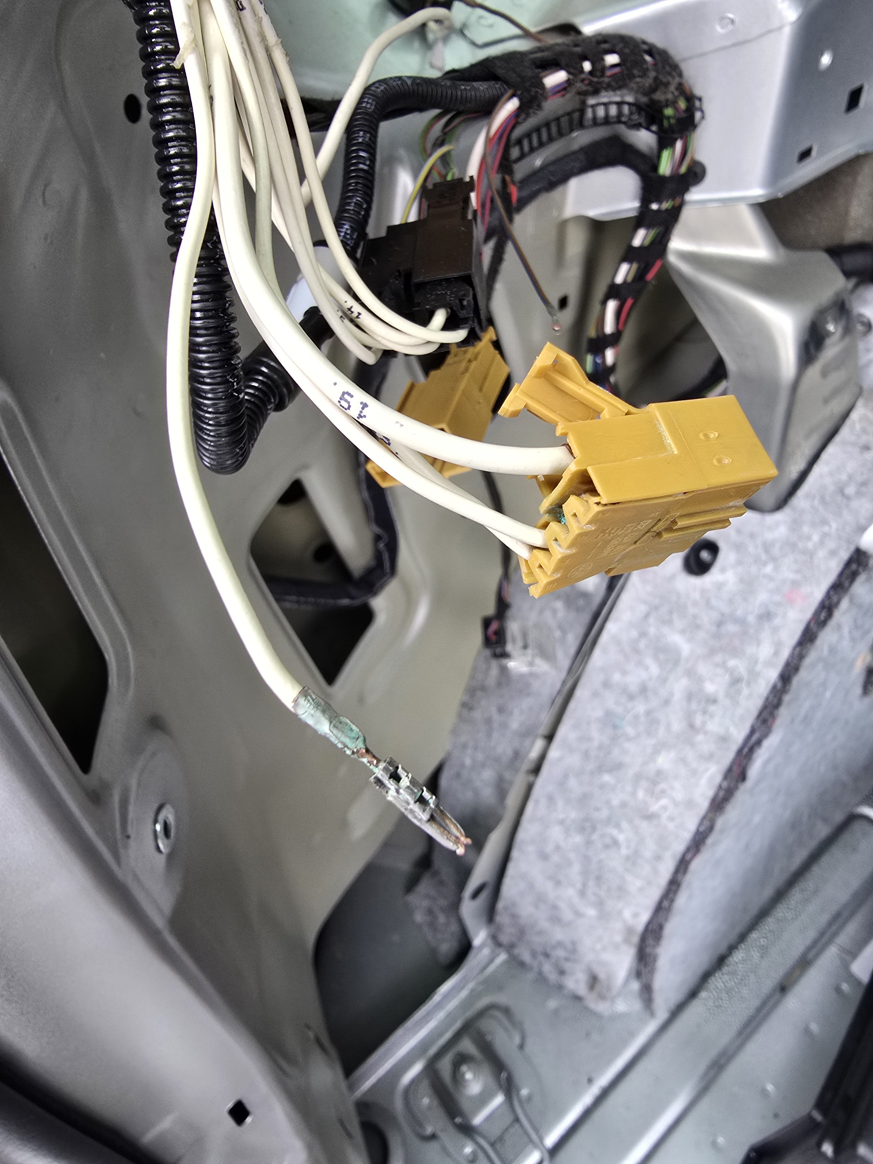

  3. It's not just these wires between tailgate and car, in the left rubber. They also having trouble in connectors behind left plastic between c and d pillar. It shorts there and causes to sign that tailgate is open etc. There you need to clean it and maybe change connectors.
