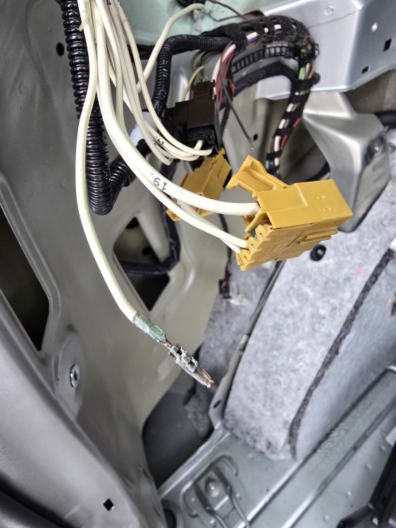

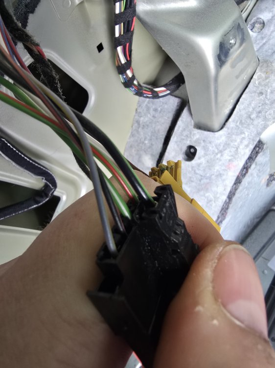

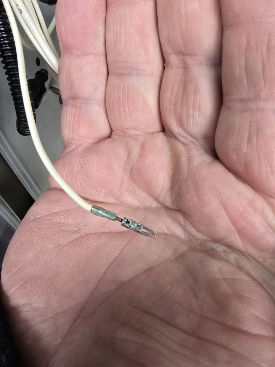

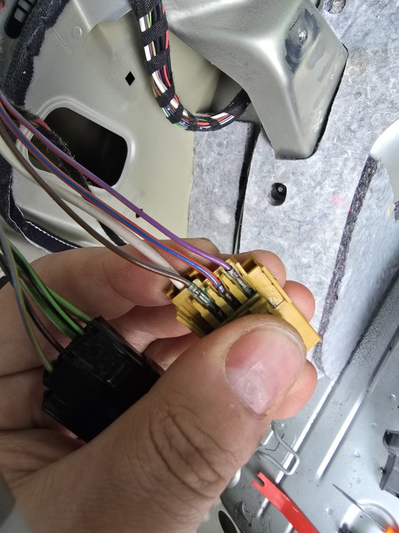

It's not just these wires between tailgate and car, in the left rubber.
They also having trouble in connectors behind left plastic between c and d pillar. It shorts there and causes to sign that tailgate is open etc. There you need to clean it and maybe change connectors. 20250301_123903.jpg20250301_121238.jpg
Also while you are there check hose for window washing fluid. Because it happens that it breaks and fluid leaks over these connectors.
