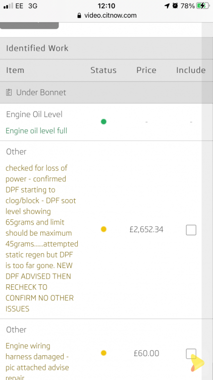

  4. Well I've had a productive day went to Dpf Doctor in Glasgow this morning and after 3 hours they confirmed my dpf is full of soot but may not be my main problem as my Charge Cooler is badly blocked and as its only £165 suggested replacing it so Monday we will see if my problems are solved. for a fraction of the £2650 skoda quoted for a different part

  6. Well Henrey’s Skoda Glasgow had it a couple of hours and say my dpf has 65 grams of soot and 45 grams is the max allowable. Ststic re gen of dpf failed as it’s too far gone and have advised to replace dpf........ costing £2652. not going to happen at this time as. Move house in a few days and don’t have the funds. Need to put some thought as to my next step.
