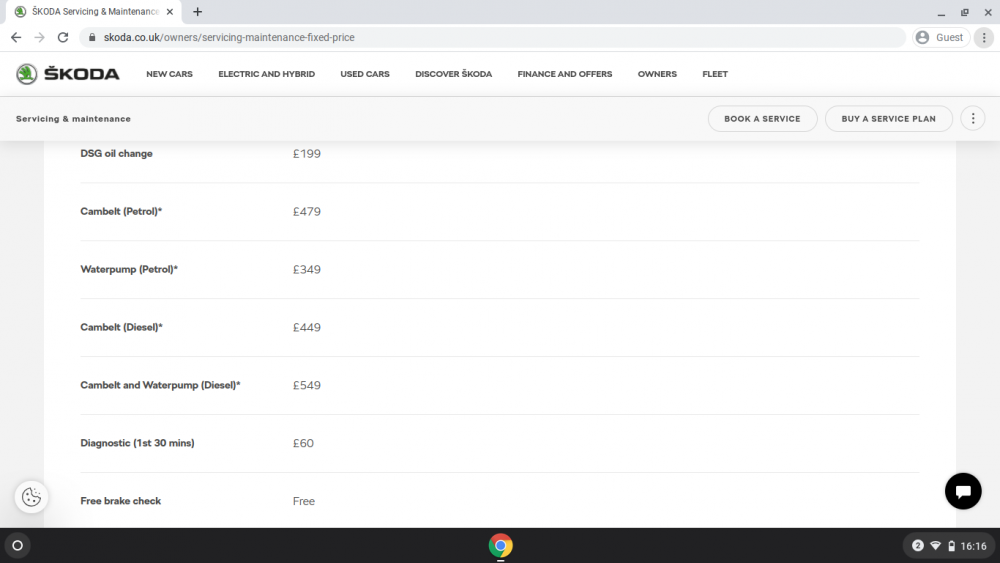

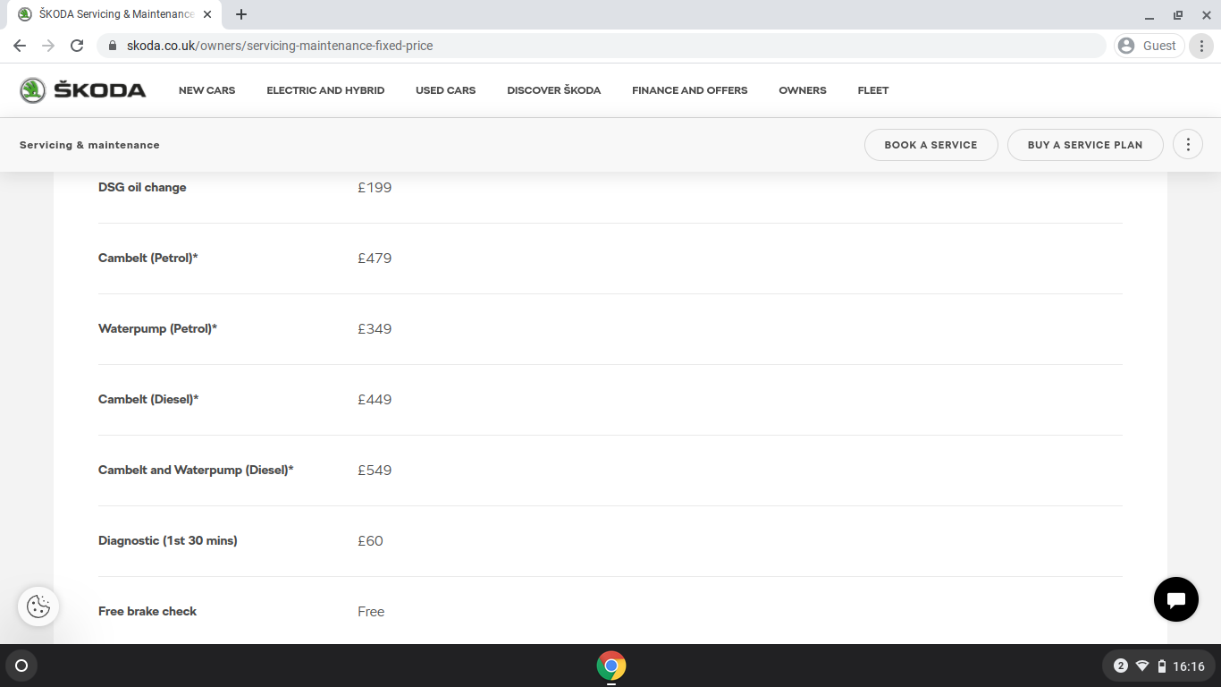

If Ingrams Ayr are getting it in they maybe said it could be 2 hours to do a diagnosis.
But then the Fixed Price Servicing and Maintenance is the first 30 minutes for £60.
Maybe the person with all the gear and more than an idea does not need 2 hours and can pin point the problem within 30 minutes from setting down the work sheet
and plugging in.
If fault diagnosed within 60 minutes then a bit of a fraud to charge for a 2nd hour.
If they get the job to do even charging the 2nd 30 minutes is taking the pIth.
