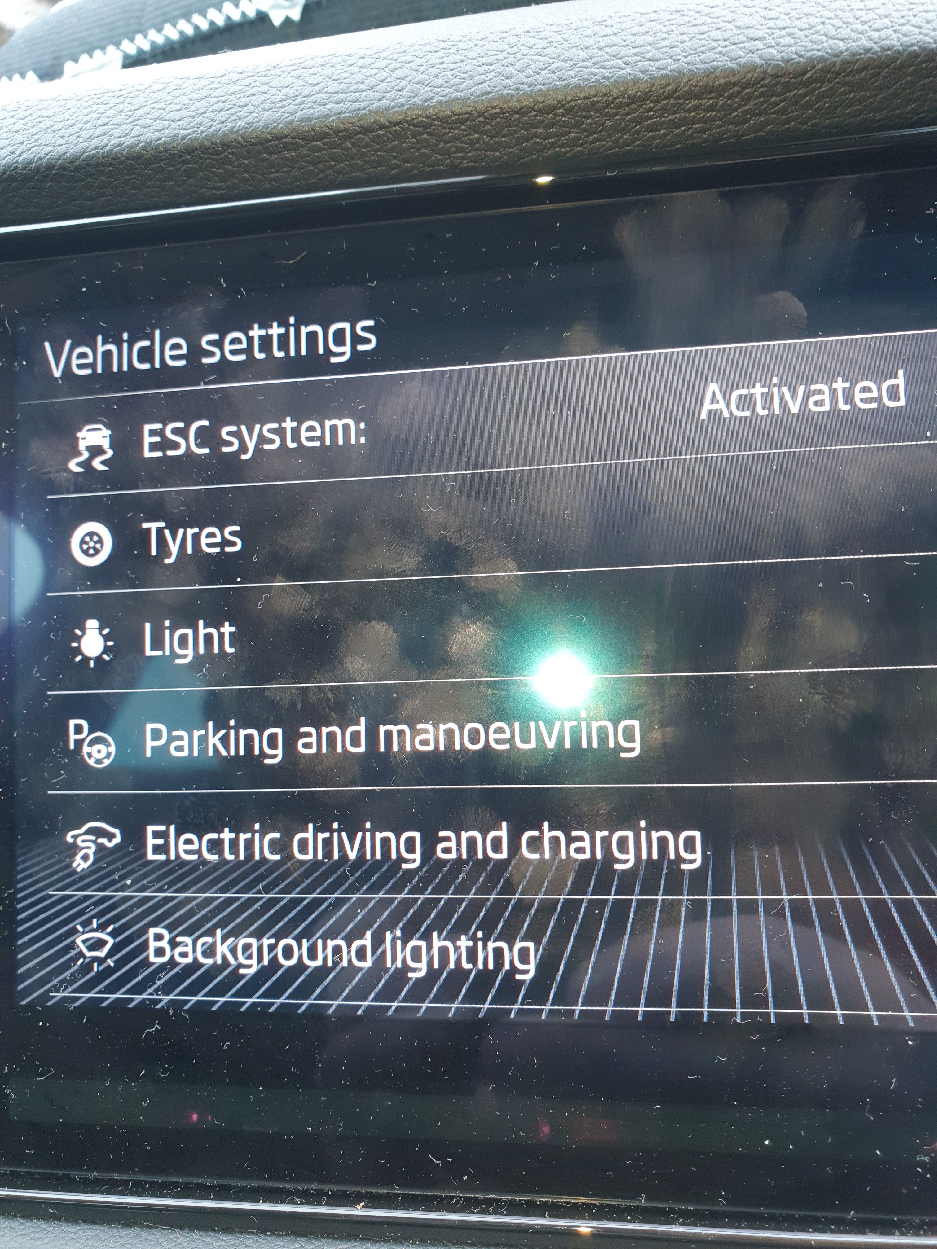

  3. Hi anyone here using OBDEleven with prefacelift Karoqs. I seem to have inadvertantly enabled the "Electric driving and charging" menu on my Columbus even though obviously my car is neithe electric or hybrid
