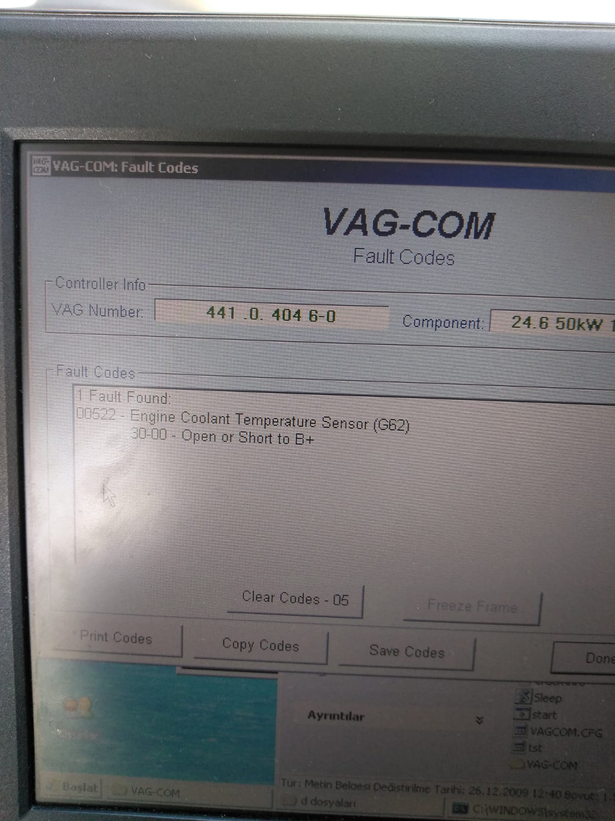

  8. New temperature sensor arrived. The problem went away as expected. Thanks for your help
  9. Thank you my friend, I could not understand from a wrong translation. I will do what you say now. I'll change the sensor first, act according to the result

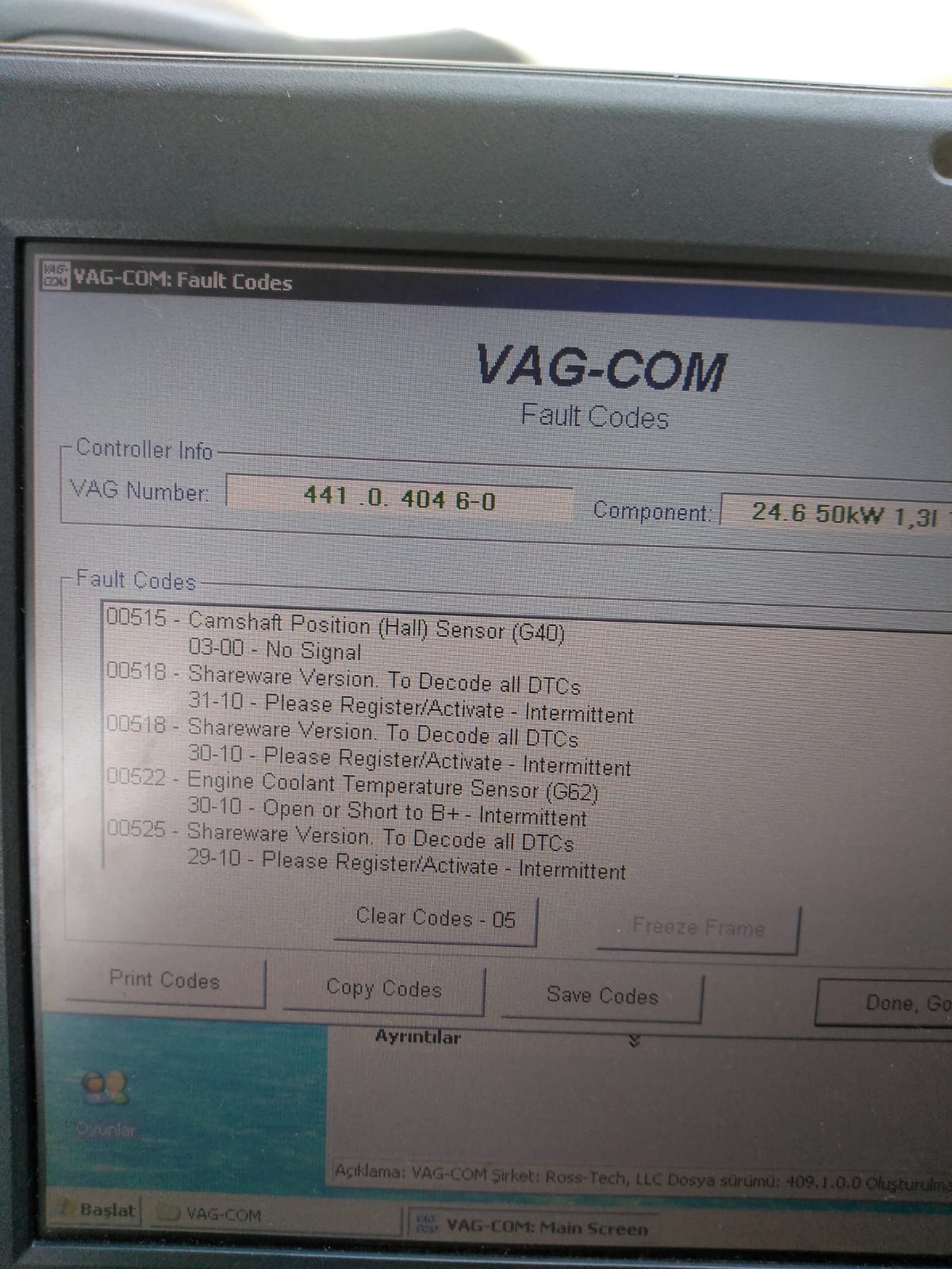

  10. new spark plugs new spark plug cable new distributor "all 1 year" So where else should I look for errors? Ignition coil flywheel sensor charge dynamo
  11. temperature sensor socket not plugged in. Temperature sensor socket plugged in.
  12. Errors before starting the engine. Error remaining after engine starts.
  13. First of all hello everyone. My car has a startup problem recently. I have to do about 15 to 20 cycles for the cold engine to start, Of course with a very intense smell of petrol, and I have to keep my foot on the pedal for a while. Once it works, there is no problem until the next day. As far as I can see with the vcsd the problem may be with the temperature sensor. Does this sensor affect the engine not starting?
