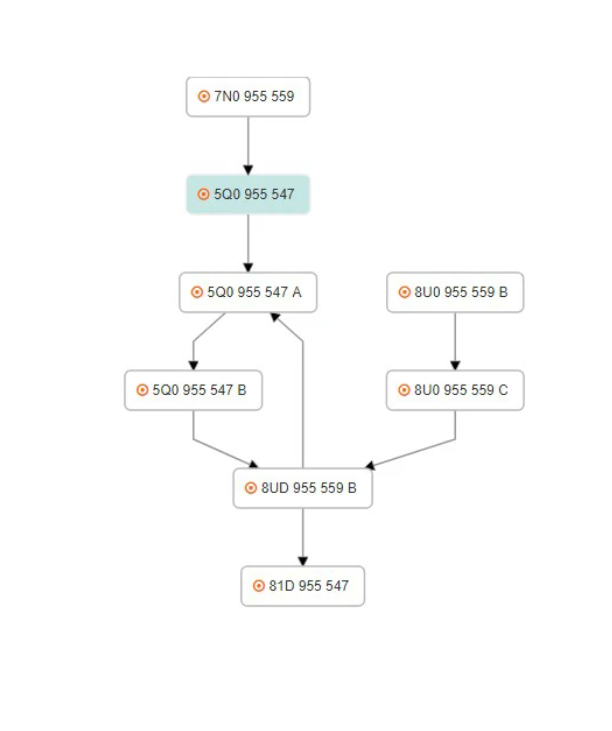

Hi there Looking for some advice please. I've got a Octavia mk3 2013 elegance 1.4 tsi Its fitted with auto headlights auto wipers and climate control. Recently was getting "fault automatic headlight control" on the dash. This only popped up when i started the car in the dark or when i entered a tunnel (went from light to dark or dark to light).But the headlights and wipers seems to work automatically ok. After a bit of research decide to swap the windscreen sensor (the one behind the mirror). The sensor fitted on the car was part number 5q0955547. I was informed its been superseded with 5q0955547b. Skoda main dealer (Marshalls Gillingham) wanted £281 +vat supply only As quite expensive decided worth a punt so got one from ebay from a car that was breaking. £25 including delivery. The seller assured me the part worked fine and the car was being stripped for unrelated reasons. Swapped over the sensor and also fitted it with a new index match gel pad (no bubbles just lucky i guess). The error has gone away and the headlights work automatically perfectly. But now the auto wipers dont work. Auto wipers are set in the car info screen menu. I tried togging on/ off. A friend scanned the car for OBD DTC codes and nothing found. He selected clear codes anyway. Any thoughts advice please. Anyone know If I can i just replace 5q0955547 with 5q0955547b and not have to code the new part. Also friend of mine says he has a spare sensor from a vw golf mk 7 part number 81D955547 and its does look identical to mine. He says he's happy to let me have it cheap. It was swapped on his car under warranty but did not fix his issue turned out to be his light switch so he's confident it works fine Maybe i was just unlucky and got a faulty replacement sensor from ebay ? Cheers Steve
Rain / light windscreen sensor advice please
Thank you do you happen to know if the vw version will also work 81D955547
Hi All Looking for help/advice please I have an issue with my Octavia mk 3 (2013) I'm getting automatic headlight control fault flash up when i have the lights set to auto and it gets dark either when starting the car in the dark or going from light to dark (tunnel) whilst driving. The error does not appear when its not dark. The auto lights and wipers seems to work fine. The screen is super clean in front of the sensor so not a dirt issue. I managed to removed the sensor and replaced the gel pad (index matching gel i believe) worth a try. I made sure everything very clean no air bubble etc. but made no difference So looks like i need to replace the sensor. My current sensor is a 5Q0955547 my car has auto wipers auto lights and climate control. So i believe this is a tri sensor. light/rain and humidity. I called skoda and they want £281 for the sensor (supply only) so looking for a cheaper alternative. The Skoda parts guy told me 5Q0955547 is no longer supplied and its been superseded but said he's not allowed to give me the new part number. I see 5Q0955547A and 5Q0955547B on ebay / aliexpress etc. But also see the vw golf mk 7 forums talk about the same issue and quote 81D955547 and the sensor looks the same. I found the diagram below on aliexpress but cant really work out whats it all means. was hoping the kind Briskoda members could maybe throw in there comments / experiences. Thanks in advance Steve
