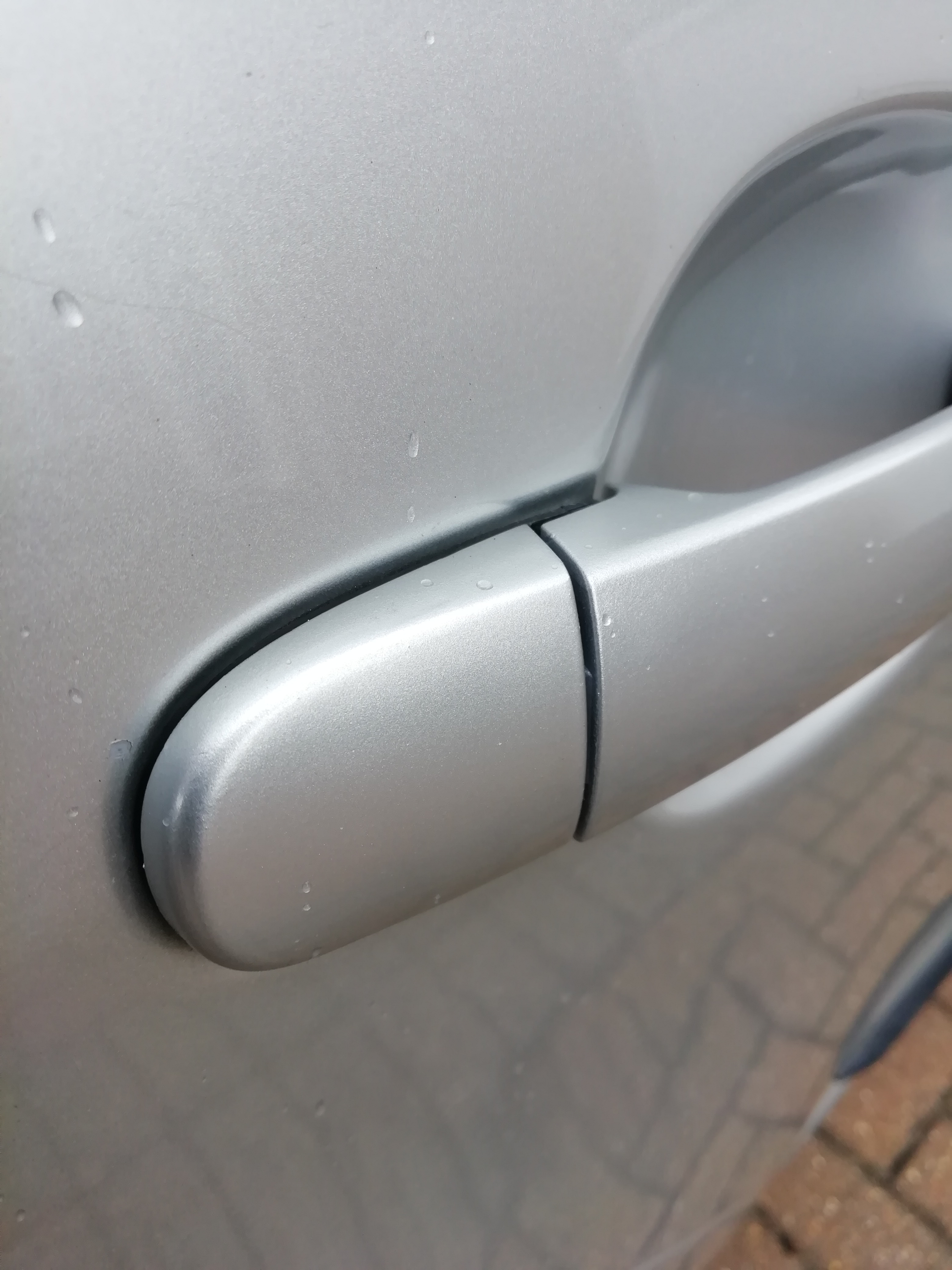

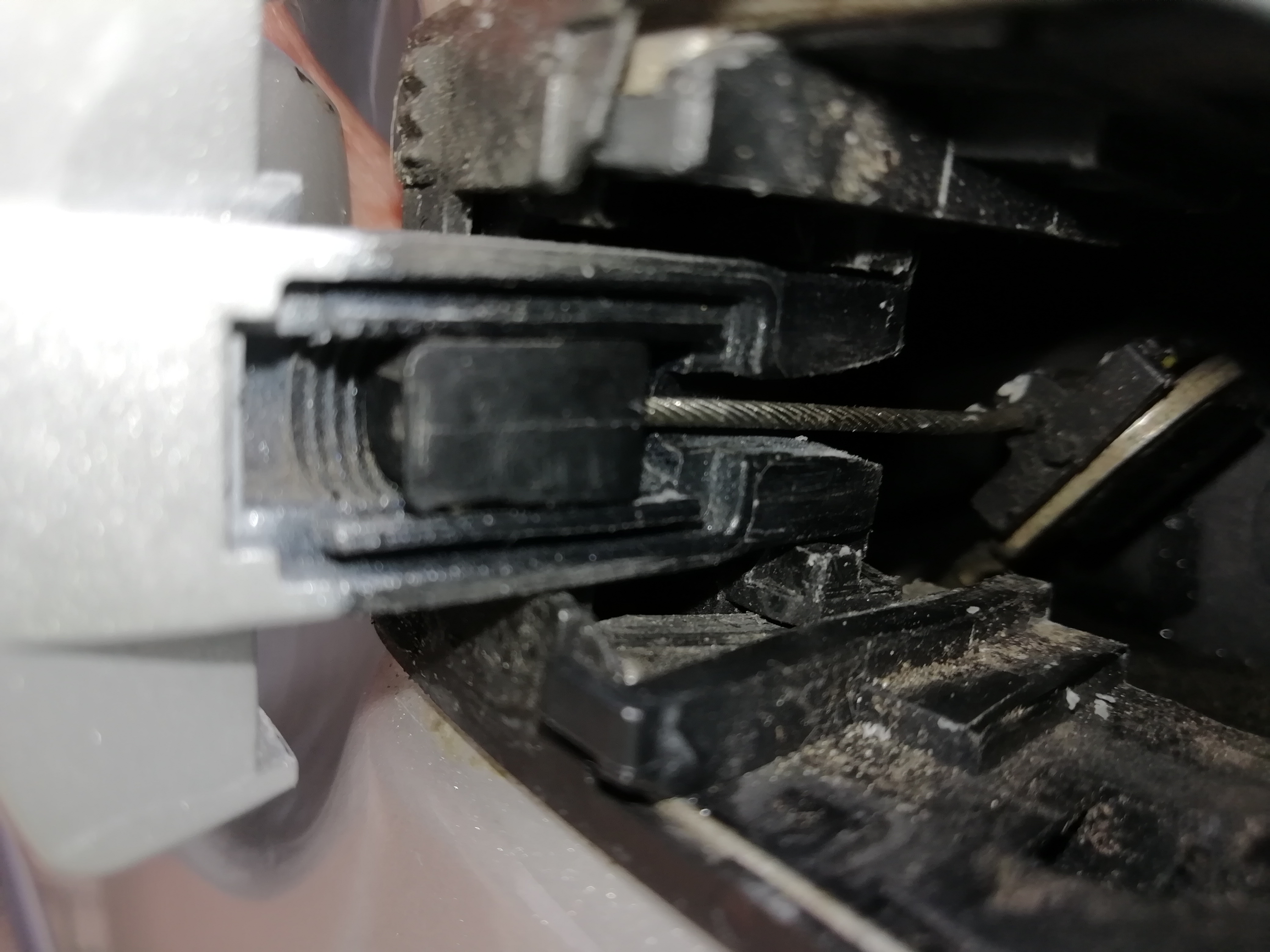

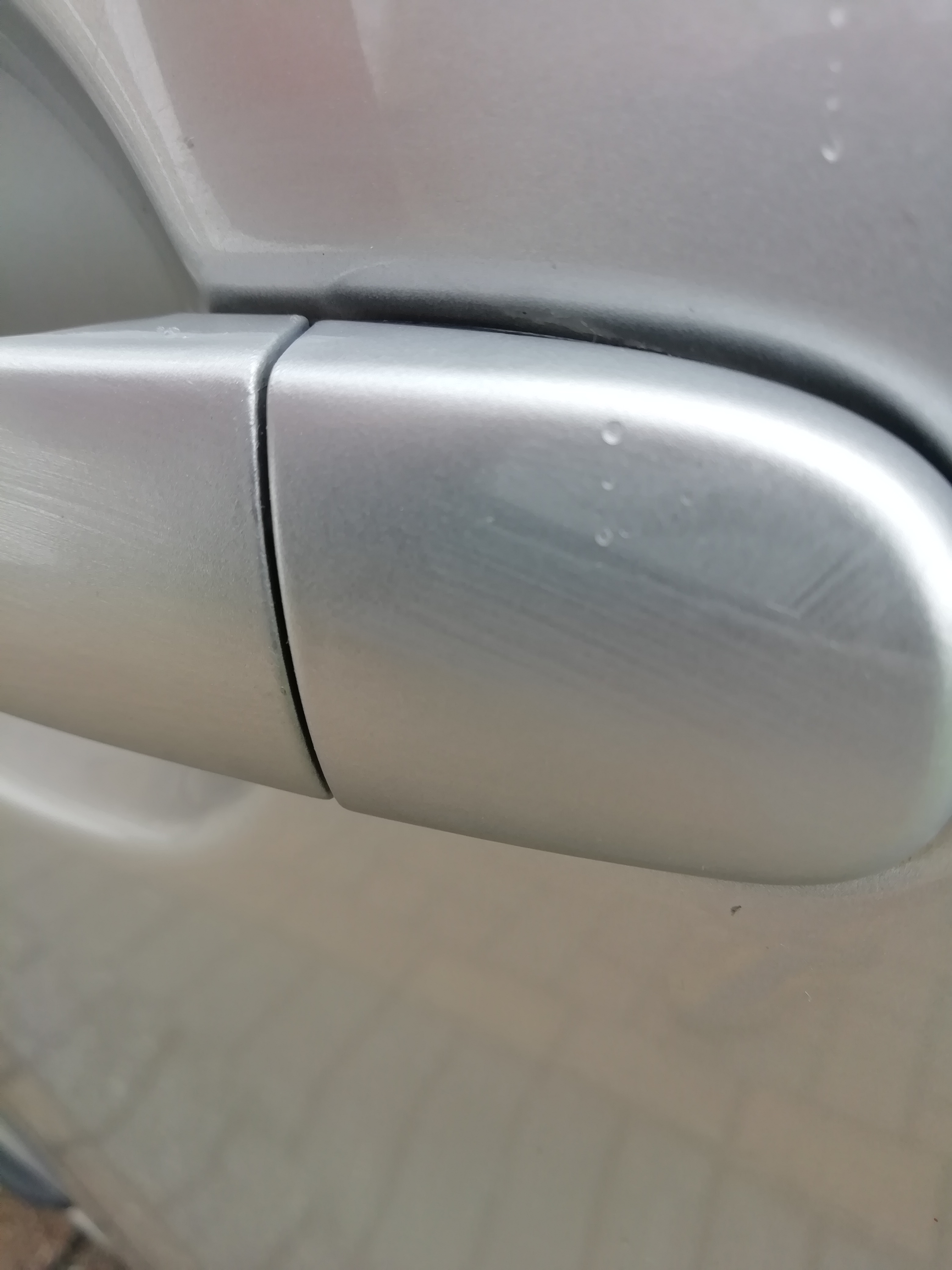

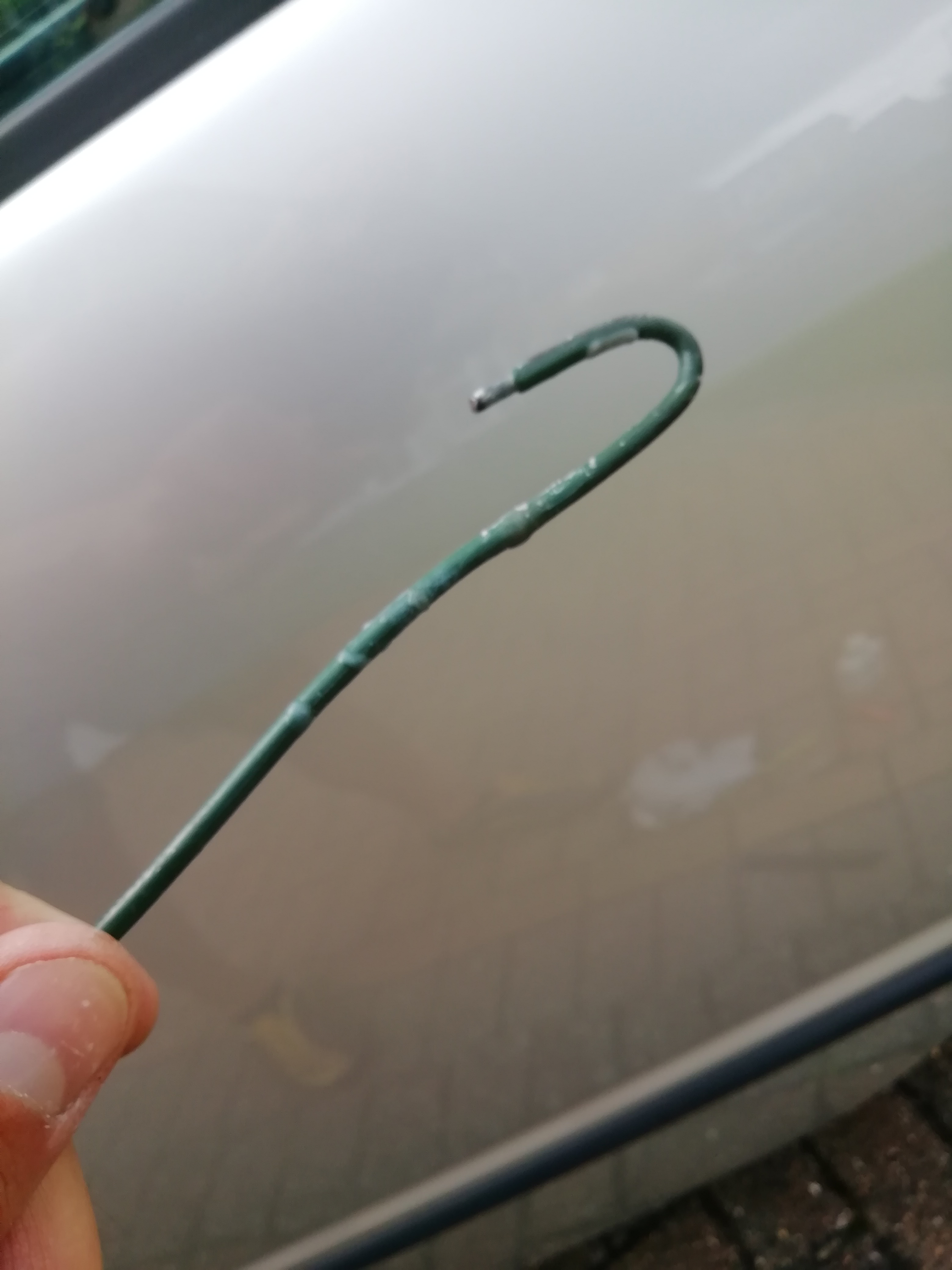

  8. Okay... Sorted. Basically the rear fork of the exterior door handle was the wrong side of the door catch fork so when operating the handle it was pulling the cable to open the door but not fully pulling the catch. I fashioned a U' bend in a piece of wire (difficult to pull the catch fork forward with a screwdriver) to enable the door catch fork to be held outward whilst locating the handle fork correctly to sit behind it. It's a bit of a fiddle but the handle now sits tight against the door and feels nice and tight to pull. Thanks for the Vids above, this enabled me to view the operation inside the door to see that I had located the rear of the handle incorrectly. I've added some pics. The lower two show the difference between the two handles. (First pic of the handle is showing it incorrectly fitted and protruding slightly, the second is showing it correctly fitted) Hope this helps anyone with a similar issue. Thanks to TMB and Wino for the great advice. 👍 Still love driving the Vrs even though she's getting on a bit.

  12. Hi All, I have just replaced both exterior rear door handles on my Mark 1 Fabia Vrs. However, both now feel as though they have lost some tension and they seem to sit outward slightly leaving the rear of the door handle protruding a little. Does anyone have any idea what might cause this? I'm wondering if I have missed a trick whilst locating the new handle?
