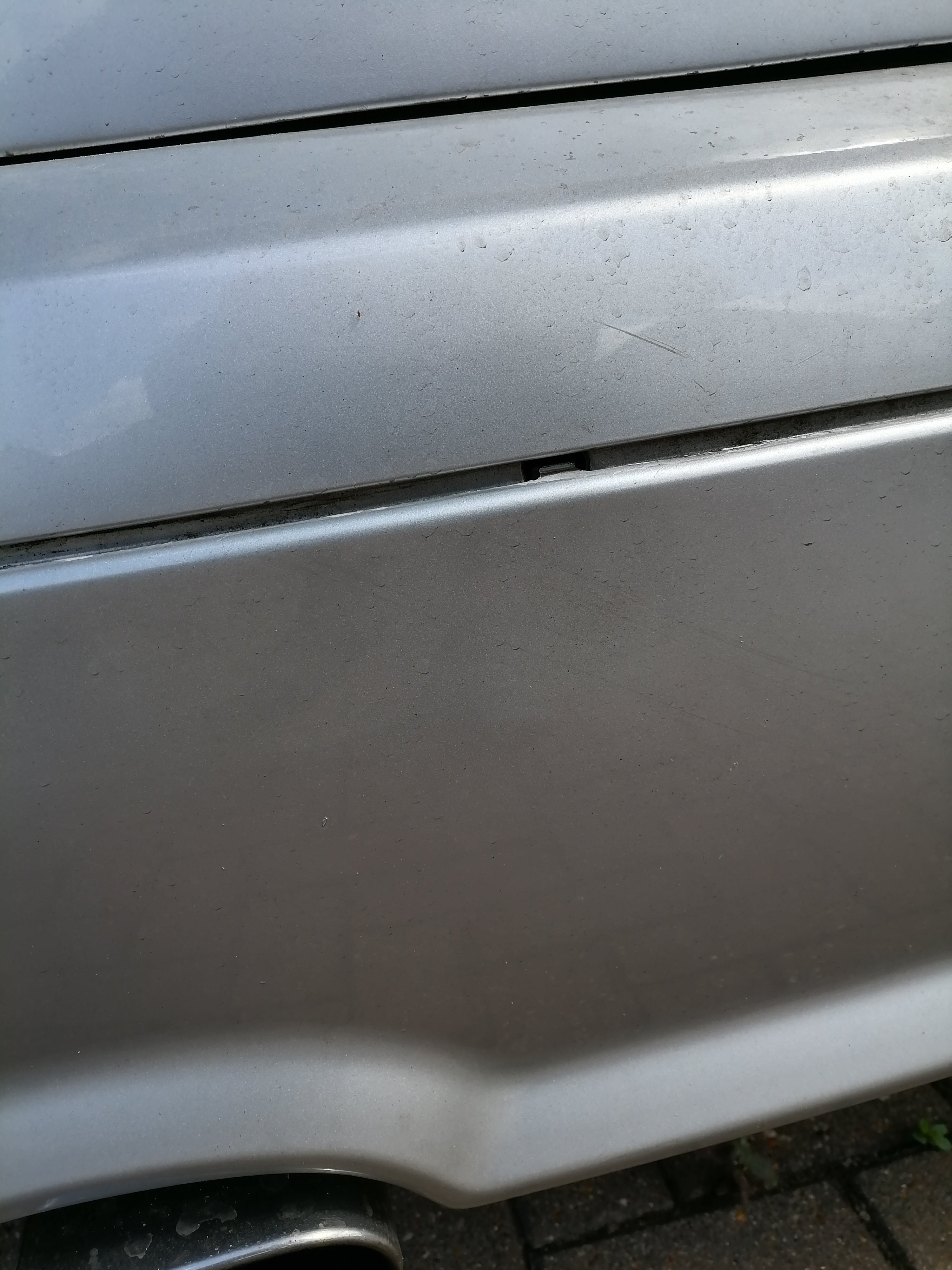

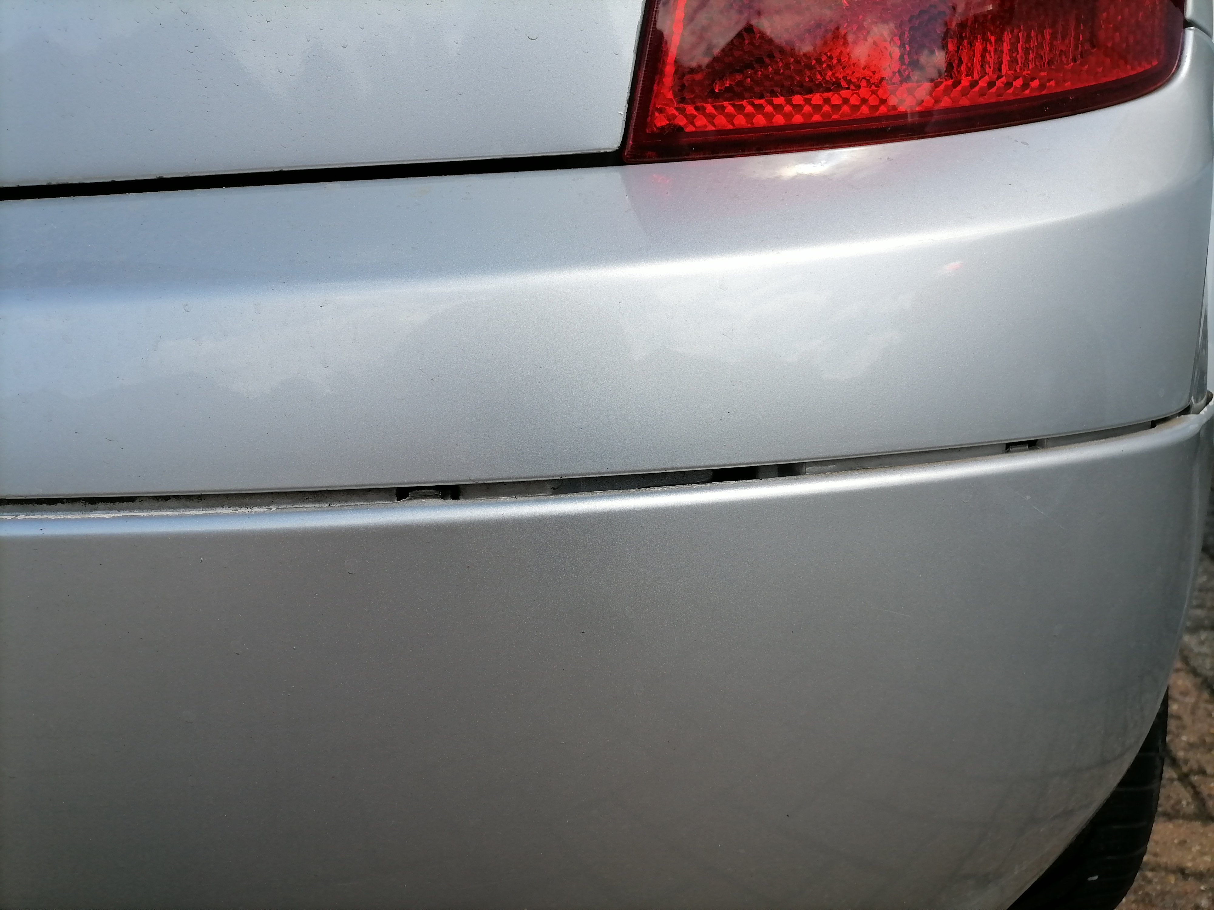

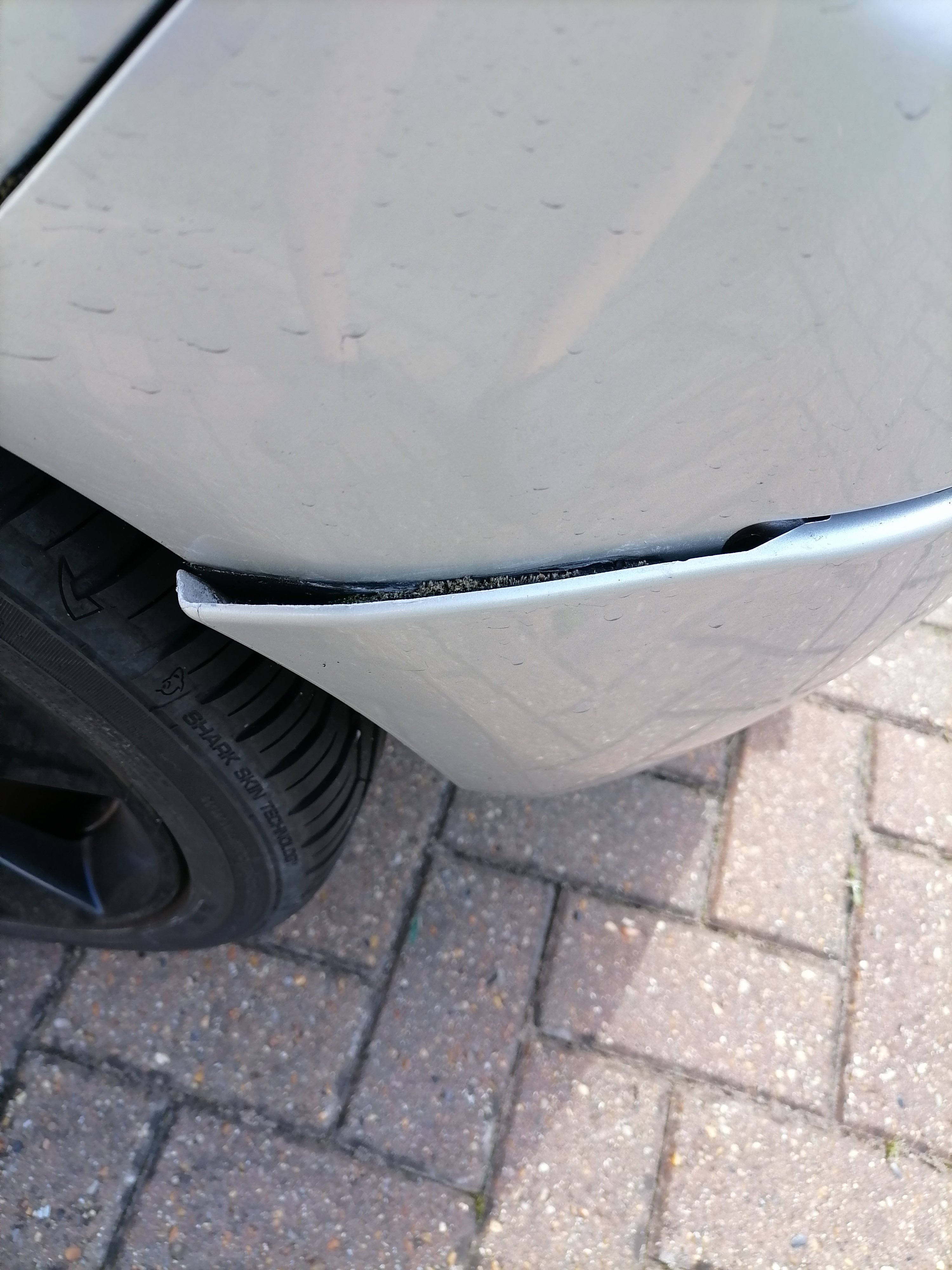

  19. Top bumper section part number is: 6y6807421 Lower section part number: 6y6807741A
  20. Thanks Vindaloo, this is exactly what's happened. I removed the bumper and separated the two halves. I painstakingly removed all the bonding and refitted the two halves together but it will still not fit properly. (Lugs won't fit into the locations as the the lower section is too low/tight) Not sure what the answer is apart from a new bumper? Both section have Skoda VW part numbers so look genuine. 🤔
  21. Great. Thanks guys I will do this. I wasn't sure if the lower part was just an external spoiler..
  22. Hi All. My Fab Vrs rear bumper has an unsightly gap between the upper and lower sections of the rear bumper. I looks like the lower section clips into the top section half way up the bumper but mine doesn't seem to want to fit far enough upwards to clip into the top section, hence the gap. Does anyone know how these sections fit together, can they be adjusted or are they bonded together? I need to try and find an answer as it's been like this for some time and I'd like to get it sorted. Any advice appreciated.
