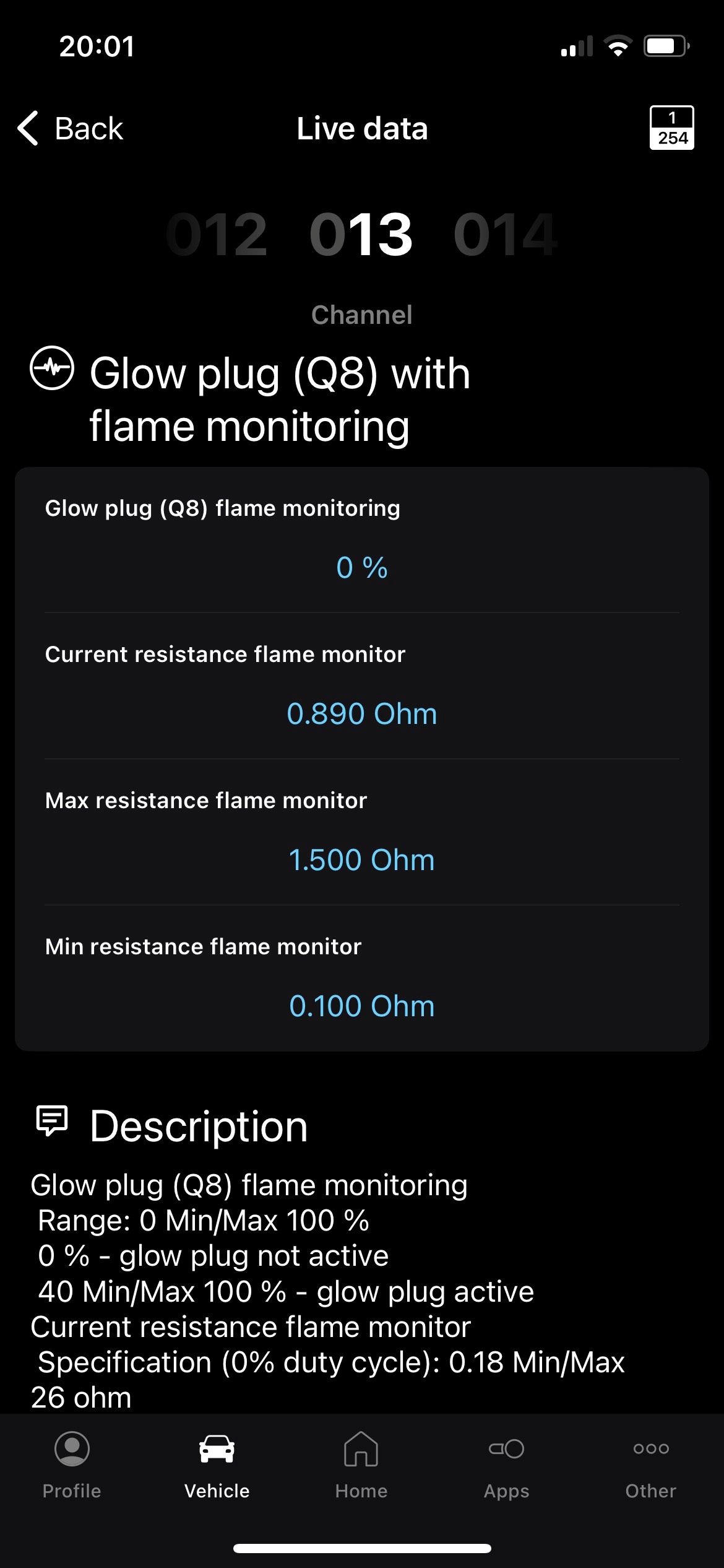

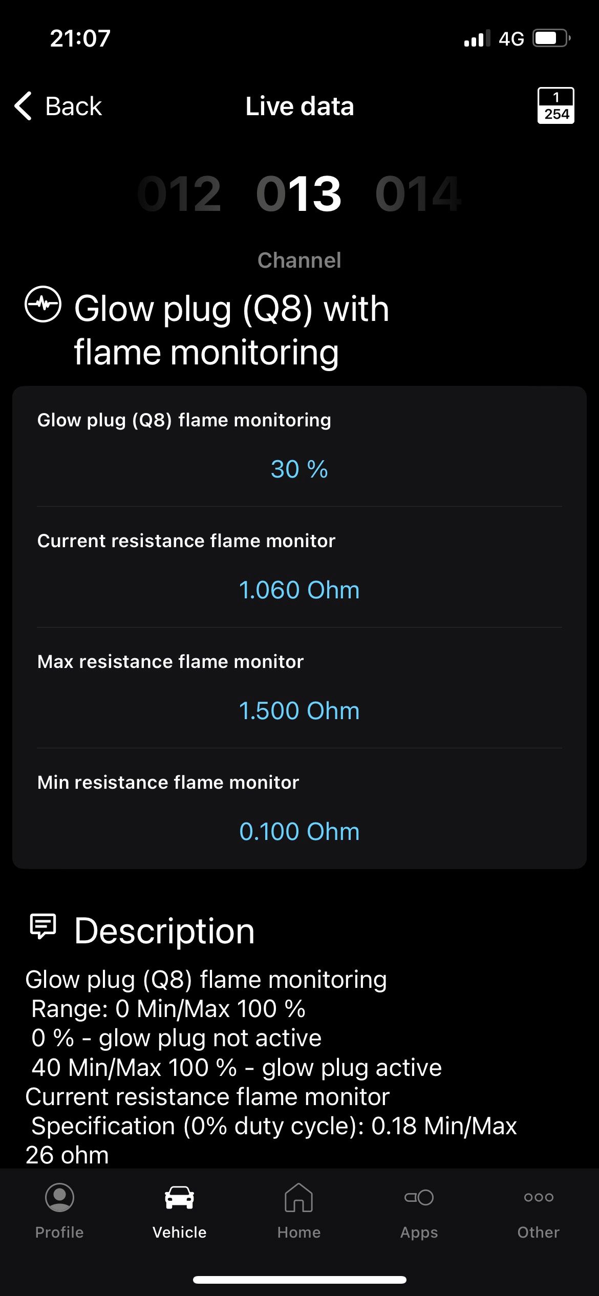

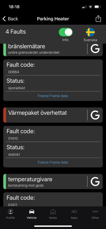

  7. Hi, Something is wrong with my heater, Superb -2013. 3-4 years ago I changed the circulation pump, after that it has run without any problem until now. First it went into block state. The result of reading faultcodes (see picture, felkod.jpg). I cleared all faultcodes and unblocked the heater. Now when I run the heater it starts, it runs for 20min (as expected according to preset value). But there is no heat in the car. The fan inside the car is running. NO fault codes are found now, everything seems ok. I can read a lot of live data from the heater but difficult to say if some value are wrong (se example of position 13, livedata1_13.jpg and livedata2_13.jpg). Can it be a problem with the glow plug? Strange that there is no fault code now. Anybody have any idea how to make the fault finding? Any idea is welcome. BR

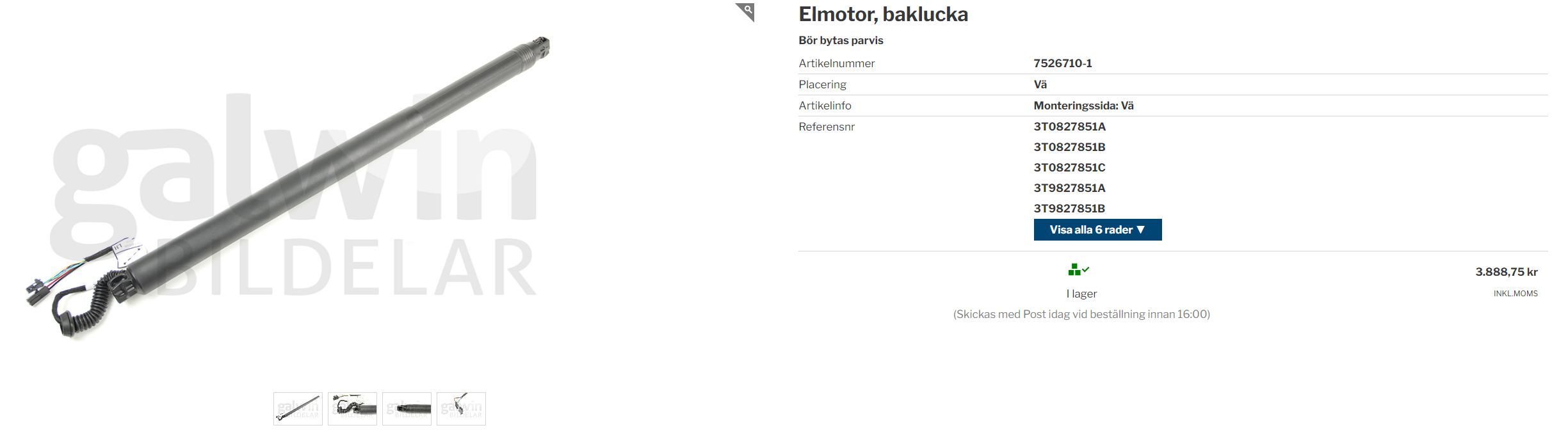

  13. Hi! The boot on my Superb -13 wont open or close anymore. Some problem with the electrical motor. At first it failed once a week but now it always fail. I think it is the electrical motor that is failing. There are two of them right and left. They are very expensive to buy. Has anyone succeeded to repair one of those? Or is it just to bring up around 7-8000SEK and change both? BR
