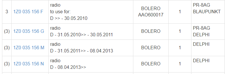

  1. Hi! I've upgraded from factory Swing to Bolero and unfortunately if I enter to the Tone menu the HU reboots: My car is from 02.2012, the Bolero is 08.11.2010, so 1Z0 035 156 G (SW0029 HW015). According to ETKA my car should have 1Z0 035 156 M by date, so I've checked the behavior on table with only Pos, Neg and Acc wires. The behavior is the same 😞 According to Google there might be a newer sw, namely 0030, I also found the flash file (1Z0035156G_DE2_0030.sgo), but I don't have ODIS, neither VCP to update it. The Version info from the hidden submenu is also missing. These are the fact. Has anybody encountered this behavior? What could be the fix?
