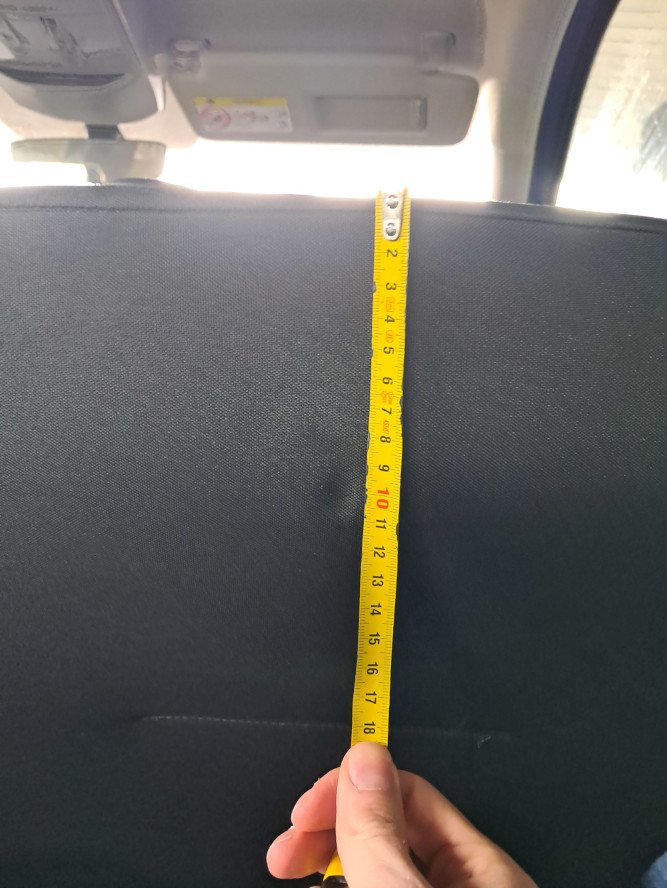

  1. The seats in which I successfully tried are also very padded in the back, and indeed finding the button was by far the most difficult part. To find the button I pressed up and down around the centre line in that area with both thumbs trying to feel for what was under the padding, until I managed to find something that felt like a round raised circle of around 3-4cm. The interior code for this Fabia with the buttons at 10cm from the top is "NE - Black". (The indent you can see in the fabric in the picture I attached was the result of my thumbs stretching the fabric when pushing with both thumbs to depress the button.) (The pictures you tried to attach did not seem to get attached)
  2. This worked in two Skoda Fabias MK4 (from 2024 and 2025), "Essense" trim. In this trim the button is centred approximately 10cm (4") from the top. The button is around 3cm in diameter. To me it seemed easier to find the button by feeling roughly its circular perimeter. Pressing quite hard with both thumbs down in its centre I could hear a faint "click", and then keeping one thumb pushing, using the other hand to push upwards from under the headrest the metal studs slide up. Like in this video: You may need to tilt a bit back the seat to be able to slide the headrest with the studs all the way up.

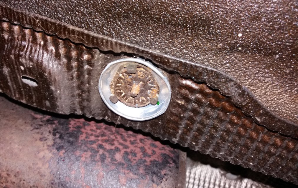

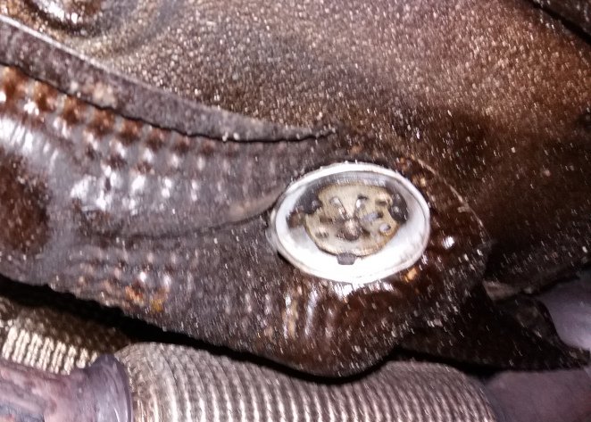

    I have had this issue in my Citigo too after around 4 years, and I have read about it being quite common (also in VW Up's and Seat Mii's) I would not remove the heatshield, but I would also not replace it for a new one, as that is quite a lot of work and I'd expect a new one to fail again in the same way. The heat shield seems to be quite thin aluminium, and due to corrosion and vibration it eventually breaks around the washer/clip that holds it. What I ended up doing, which has held so far for more than 5 years surprisingly well, was to improvise my own aluminium washers, from the bottom of aluminium cans (any beer or soda can). The bottom of the can is quite much wider than the original washer, and has a nice dome shape, which fits nicely, specially in the front of the heatshield. Note that I reused the plastic spacer between the new "aluminium washer" and the metal clip, to prevent the metal clip from touching directly the aluminium. The "aluminium washer" does touch directly the heatshield. I had tried first with a bigger steel washer but that only held for less than a year. I think the problem is that the steel corrodes the aluminium very fast, and due to vibration cuts thru the heatshield in its edges. I just added today another 2 of these "washers" in another 2 of the original clips which broke recently. Now only 1 out of the 6 supports is holding on the original heatshield and 5 are helped with these aluminium can bottoms. The exact way I did the washer out of the can was to cut it with a bit off the can bottom ridge, bend the ridge a bit inwards so the rim of the washer was a bit "reinforced", bored a 4mm hole in the centre for the car body stud, and did two perpendicular cuts centred in the hole (so there is 4 flaps that can catch in the stud a bit on their own). Note that even though this new washer holds a bit on its own, I still used the VW clip to hold it in place, as I'd expect it to otherwise corrode around the stud and fall off quite fast. You can see here 2 photos, one of a fully newly installed one and another of one that has been holding there for ~5 years: (The brown color in the car body and heat-shield is just an extra anti-corrosion sprayed coat)

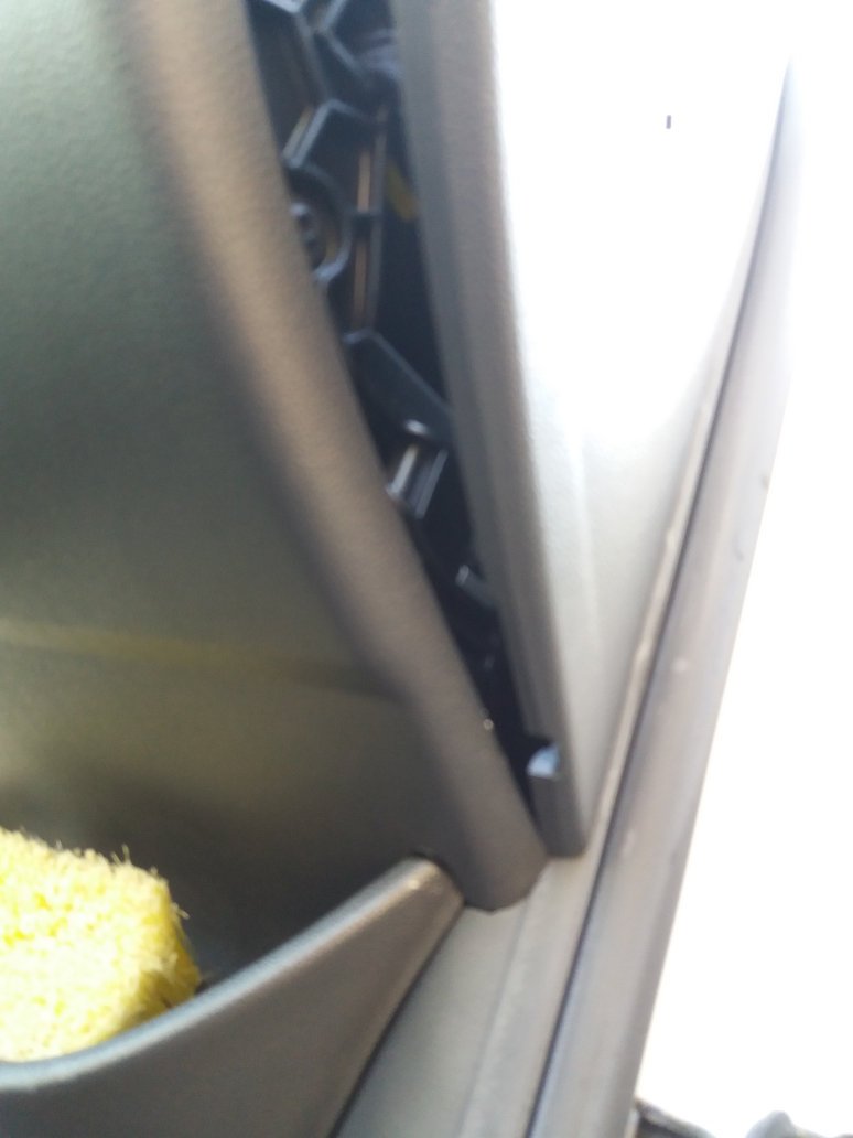

  7. Walia posted a gallery image in Skoda Citigo

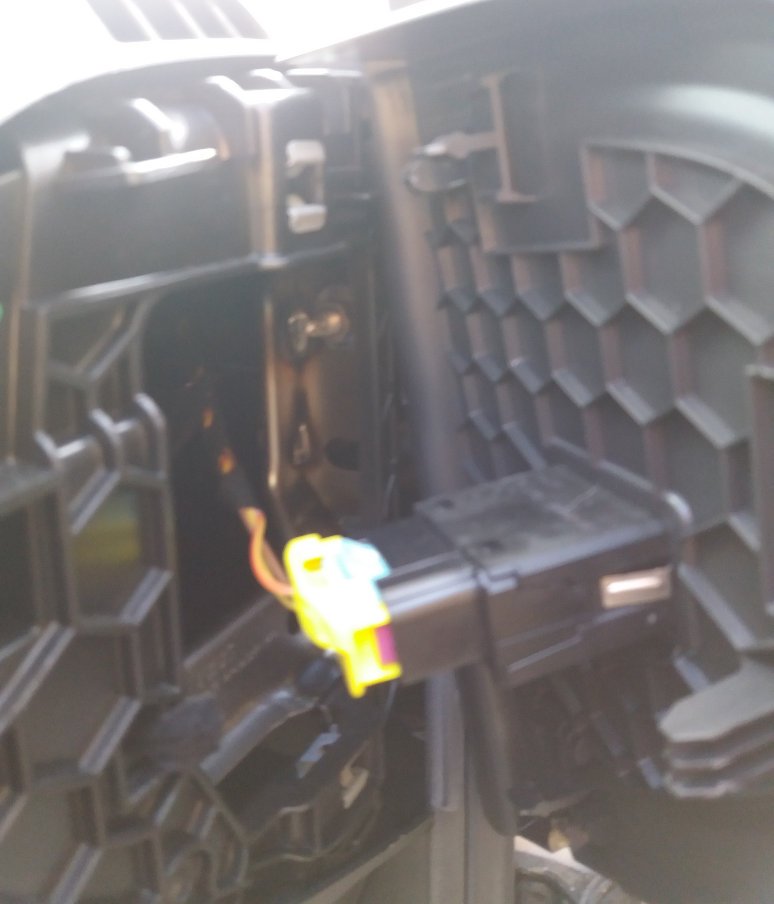

  8. Walia posted a gallery image in Skoda Citigo

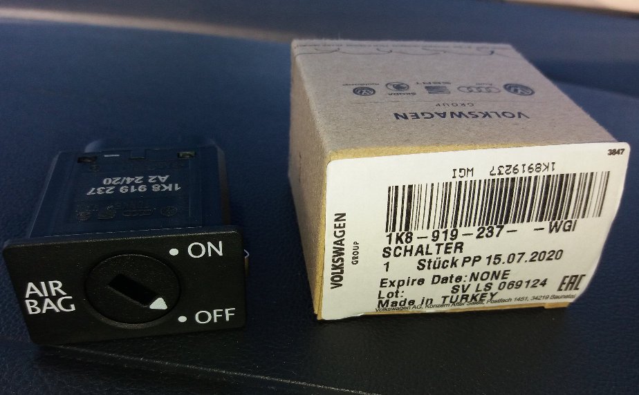

  9. Walia posted a gallery image in Skoda Citigo

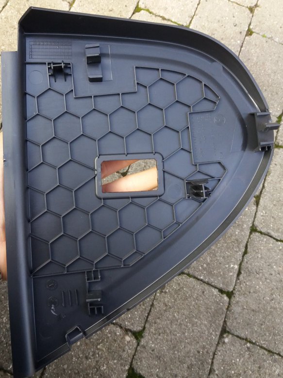

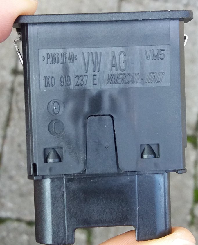

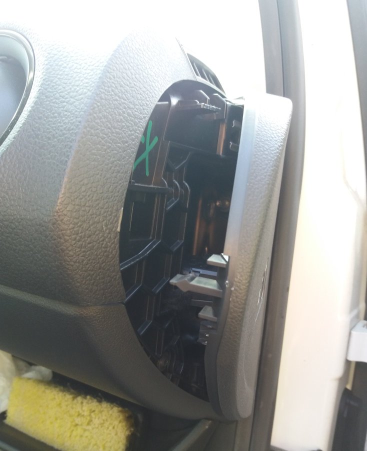

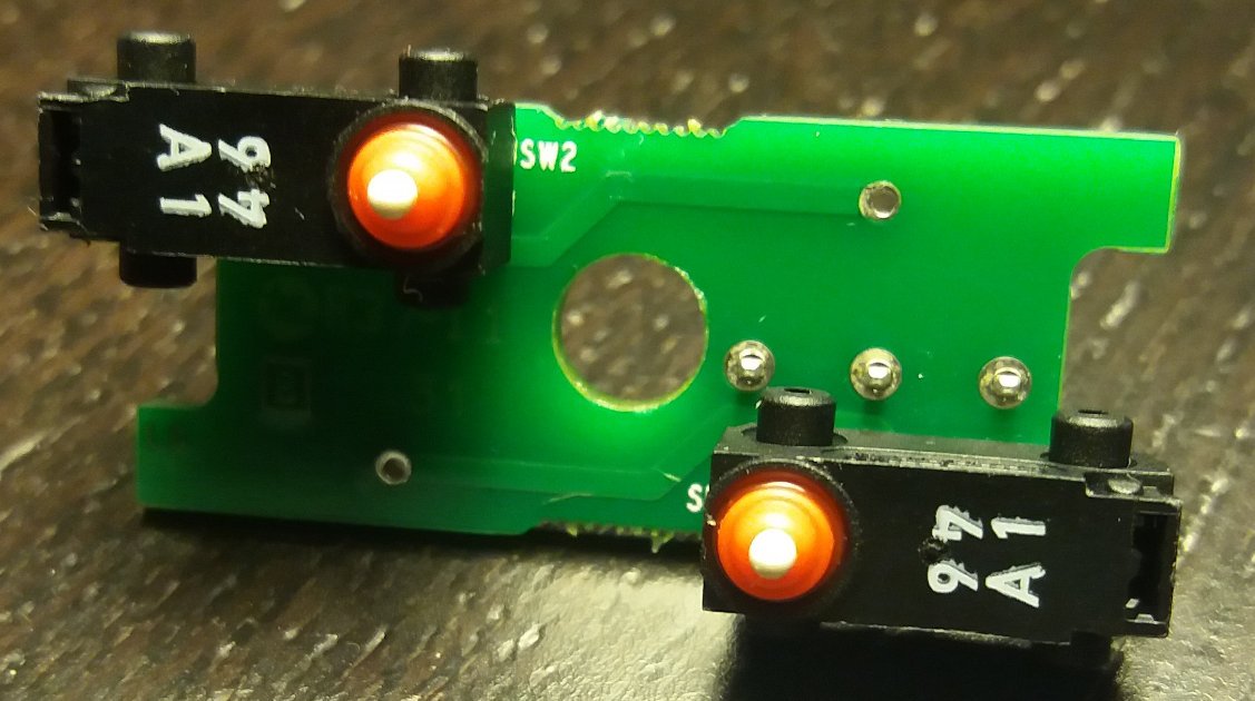

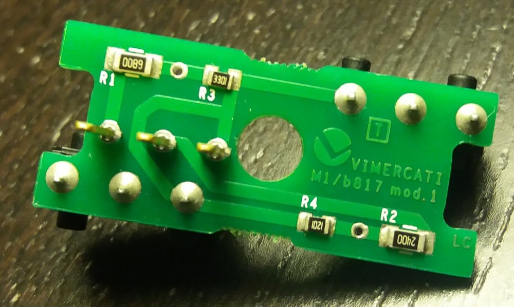

  10. Update: Clearing up the fault without replacing the part did not really help. It just reappeared in a couple of weeks. So I replaced the faulty part (The passenger airbag disconnect switch, in the passenger side, in side of the dashboard, just behind the door. The old one was a 1K0 919 237 E, but that has been replaced in the VAG catalogue by a 1K8 919 237. The part is quite expensive for what it is. Replacing it takes just 2 minutes: Open the side cover: It is just held by three catches, you can start from the bottom where there is a gap to make lever. You can use a wide flat screwdriver but beware that the dashboard plastic marks very easily. After you open the bottom catch you can open the front and top ones just with your fingers (it is not held too tight). The part hinges a bit on the back and you can pull it out. To release the connector from the switch pull the connector blue tab back. To release the switch from the cover push the two metal catches, and slide the connector through the front of the cover. Install the new part in the opposite order. Use a VAG OBD scanner to clear the fault, and you are done. Out of curiosity I took the old part apart: It has a small PCB with 2 switches that are pressed when in the "off" position, released in "on", and 4 resistors.
