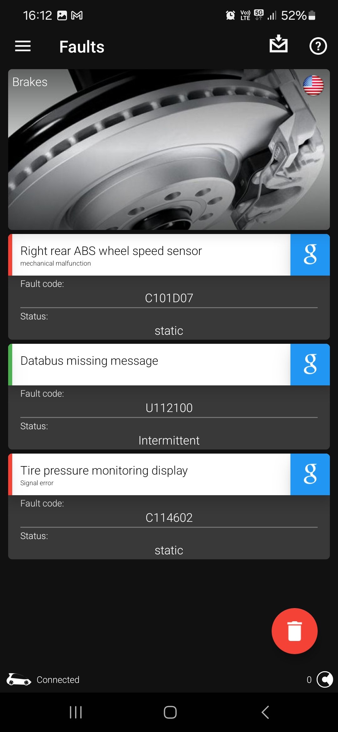

  1. Hey all Just to update, fitted new rear-right ABS speed sensor, so far all good with approx 2000km since the fix Cheers!

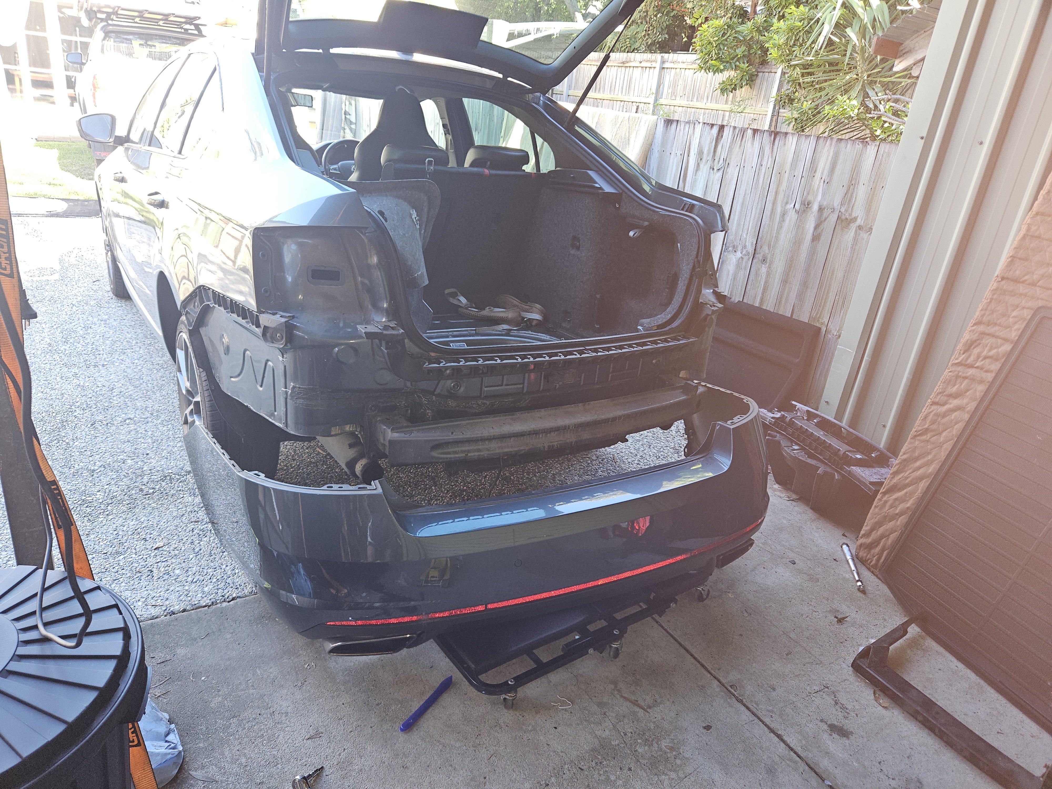

  2. Hey dude! Sorry only just saw this Mine was a genuine Westfalia towbar with the wiring harness so it was very much plug and play, and the mounting holes in the chassis were already there Not sure about non-genuine I'm afraid! My Octavia also had the towbar/trailer prep from factory so I didn't have to worry about wiring in the loom from the fuse box etc. Essentially, all I did was jack it up, pull off the tail lights and bumper, fit the towbar, plug the harness in and then bolt the bumper back on 😄 didn't need any special tools although a bumper removal kit is handy!

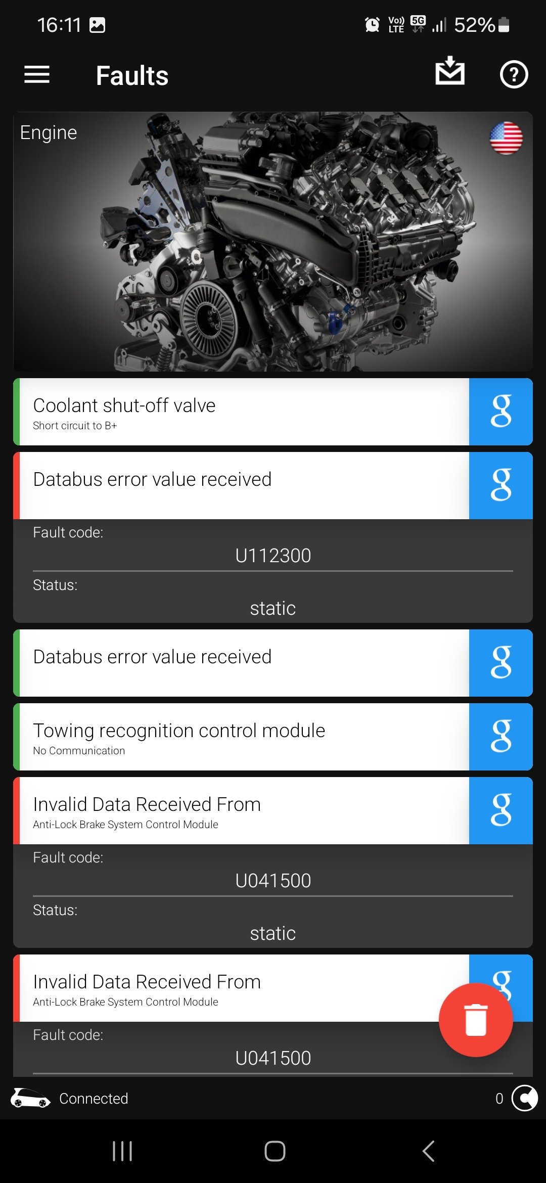

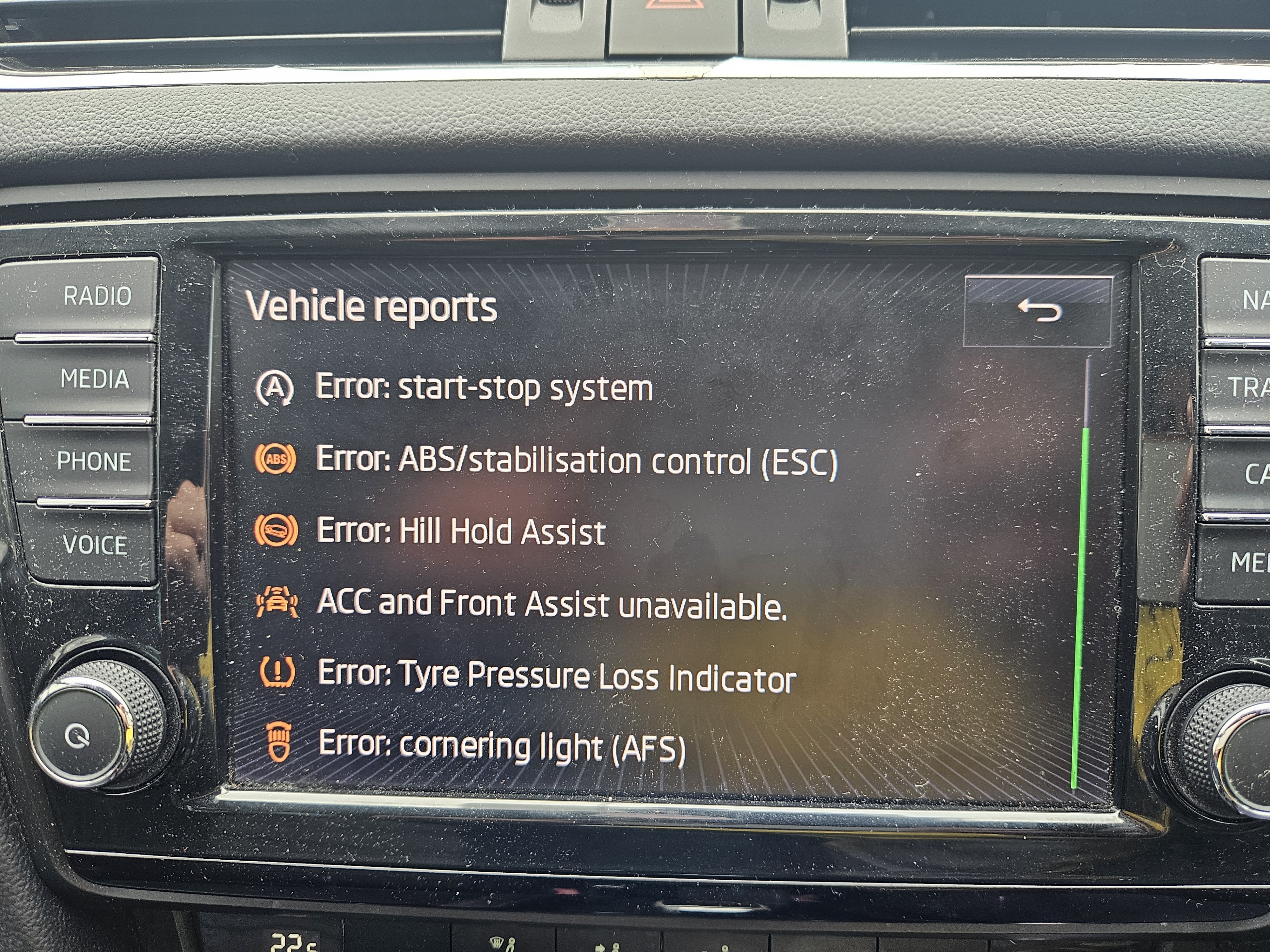

  4. Hey all I intermittently get a bunch of faults occur at the same time, usually it disappears after the next time I start the car. (Octavia Vrs Mk3) Doesn't appear to be weather dependent, and doesn't seem to have a pattern Anyway, based on the fault codes, I'm thinking it's a faulty ABS sensor that then triggers the other faults, either that or some strange Canbus issue. Any thoughts, before I pull the trigger on a new ABS sensor?

  7. Legend! Thanks a bunch for that, much better prices 😎

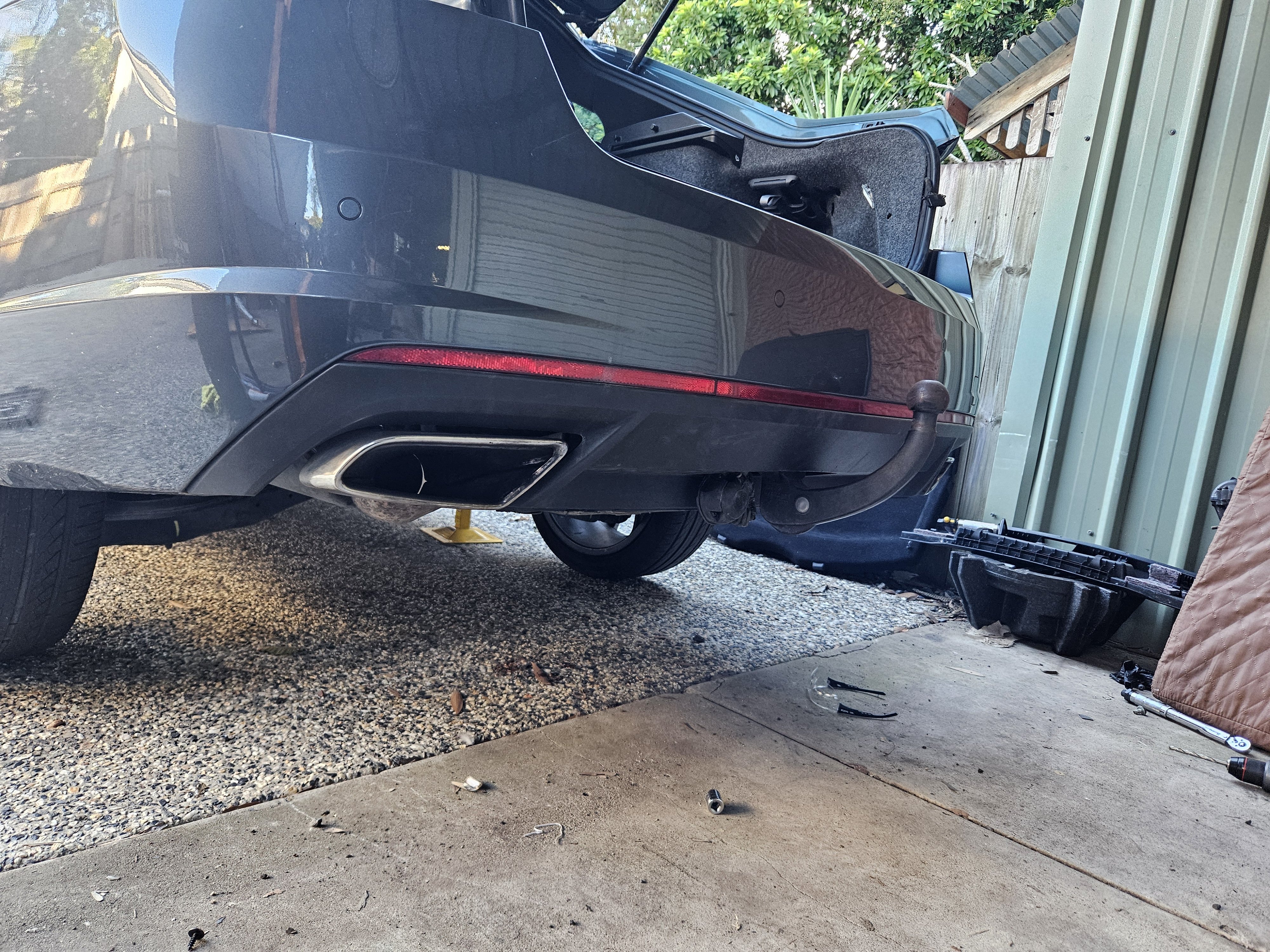

  8. Well it's been a few months, had a broken thumb, but today finally got the tow bar fitted 👌🏽 The person I bought the tow bar from said the keys are dirt cheap, just a standard key that is used on things like roof racks etc, google shows me keys that are like £75+ ?
  9. Stroke of luck, bought a second hand towbar from Ebay in Australia, has the genuine wiring harness, and to my suprise on delivery it's actually a Westfalia towbar too! $500 (£260) all in delivered, worked out well! I'll fit it myself, and i have OBD11 so I can activate the coding for it. Only thing is no keys for the detachable towball so I'll have to look into that at some point.
