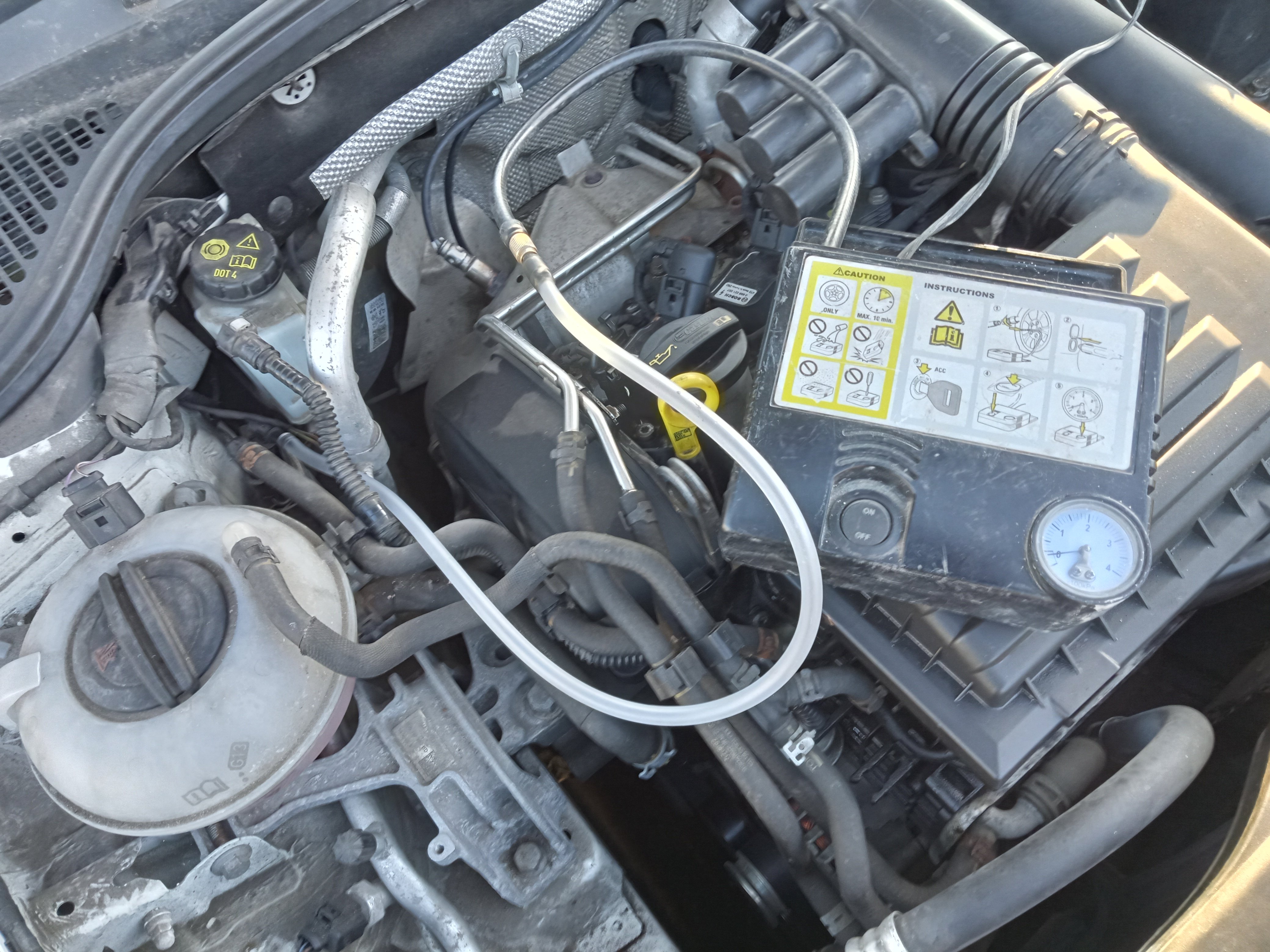

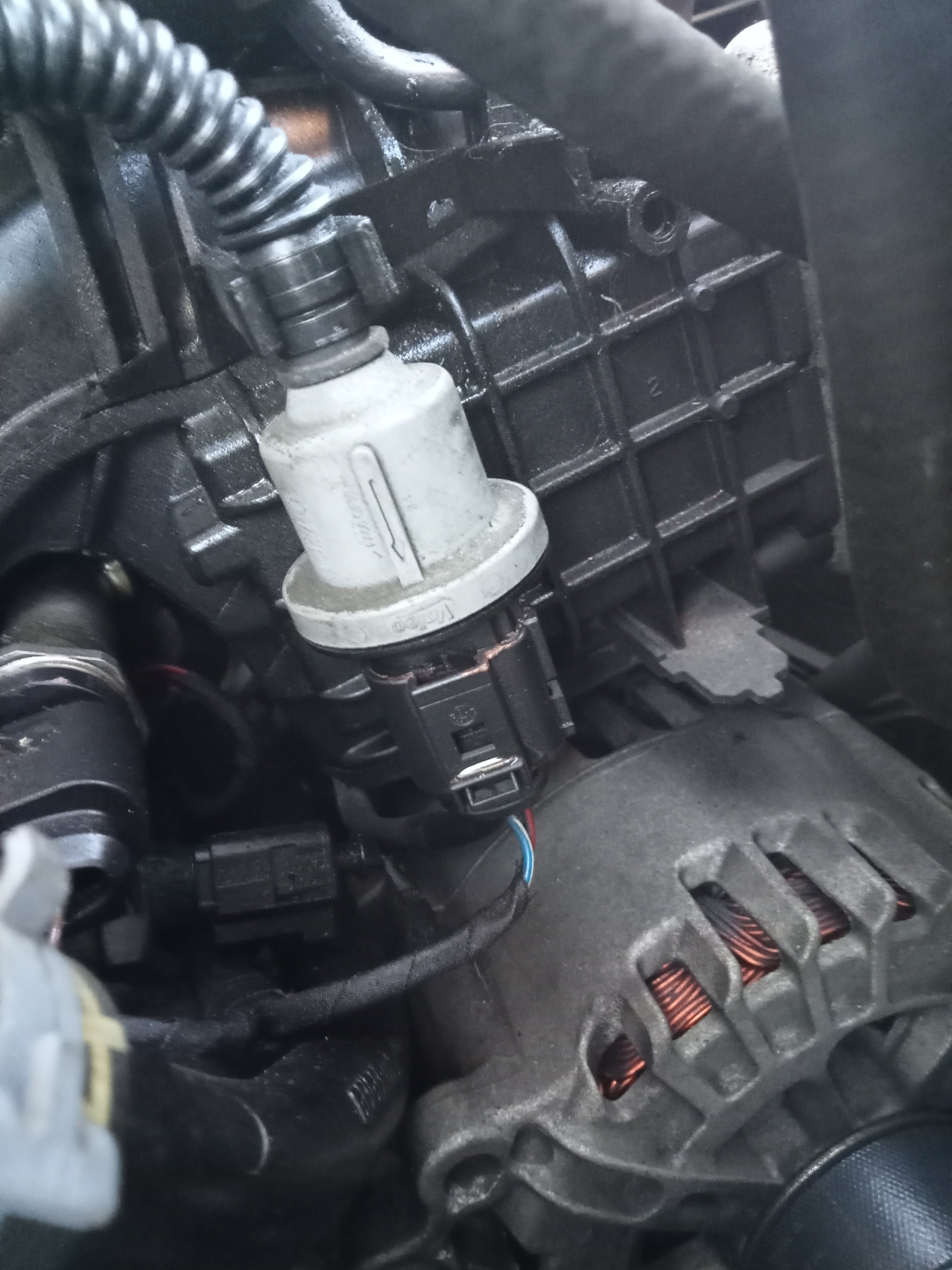

So with the pipe repaired, and engine fully up to temperature. At idle the purge valve solenoid is constantly being energised, rapidly fluctuating, and opening and closing (repeatedly) roughly twice a second. This seems excessive? Also interestingly with the pipe broken and open to the atmosphere, the tank still pressurised.
Excessive pressure in petrol tank?

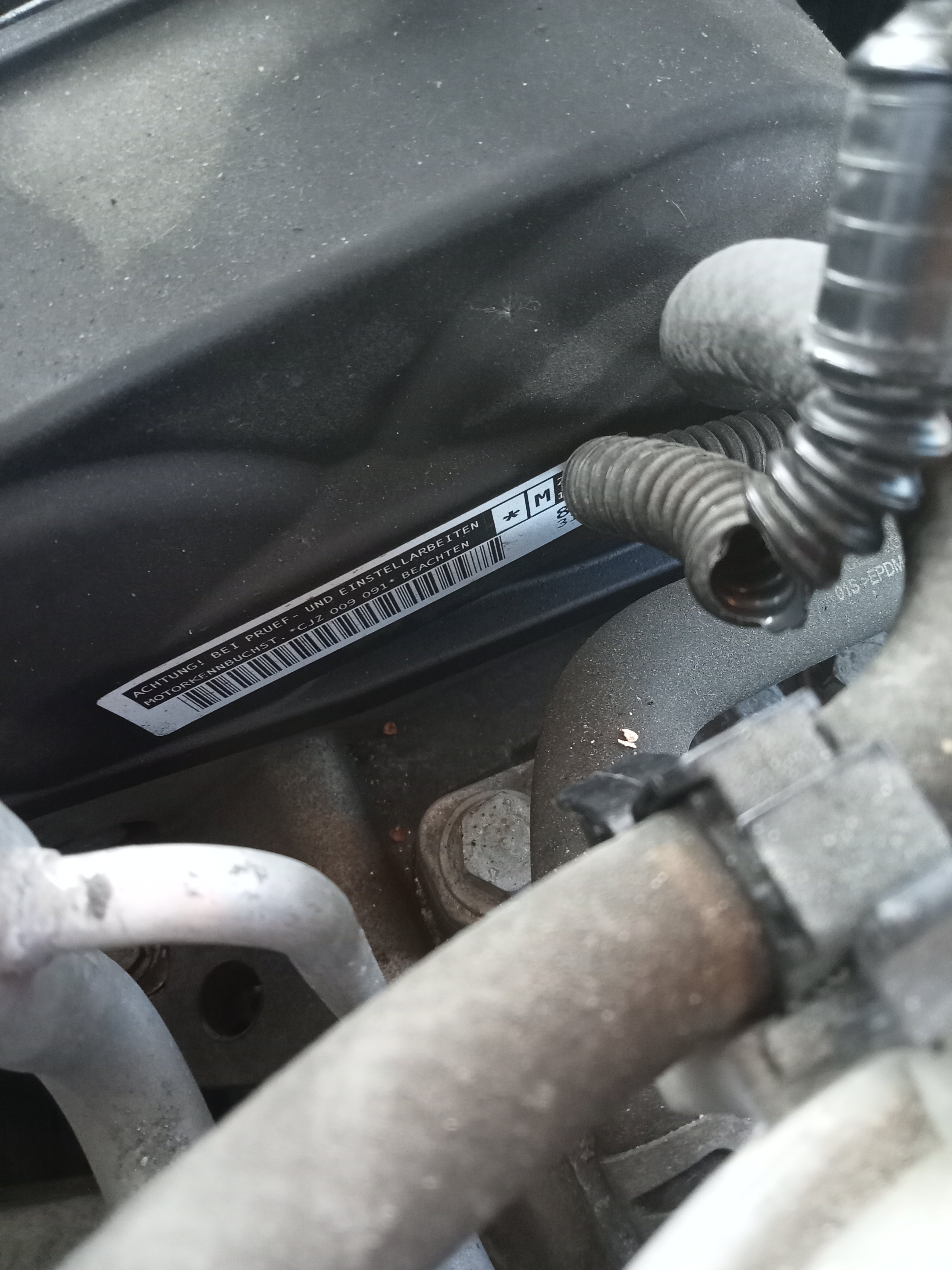

Just thinking I haven't checked for a blockage in pipe from the valve to manifold, so will have to check that aswell. Of course this happened while removing the pipe, Arrh why plastic😠 and not rubber.
The pressure is only building whilst driving, because I opened cap last night, then again this morning and there was no pressure. I say pressure as it only seems to be about 0.3 bar, it seems like there may be a relieve value somewhere in the EVAP system (see bellow) I was able to replicate the pressure in the tank by forcing air back into EVAP line, but it wouldn't go above 0.3 bar. No fault code for the purge valve, and it does have an arrow on it suggesting that it may be one way. Tested it and it doesn't pass air either way, but this was with the engine off, so it shouldn't anyway under that situation. So at this point I'm concluding that either, the valve is operating correctly, but when opening allowing manifold pressure back to tank. OR The valve is never opening, so never venting petrol tank vapours. (But I believe this scenario should throw a fault code) I'll have to take the car on a longer journey to see if I can get the value to open and repeat the tests.
Thinking on it, I've already pressurerised the inlet manifold and found no leaks, so it can't be going backwards. Although that was with engine off, so solenoid should have been closed.
At first I did expect a vacuum, obviously due to fuel usage, but it's definitely pressure, because it blows the cap off. I've seen the possibility of an EVAP system fault already, of course it looks like the charcoal canister is hidden behind the rear wing somewhere, and not in the engine bay. Which way do you think it might be: Solenoid valve not opening to suck tank/canister vapours, Or pressure being sent back to the From manifold to tank/canister I've already located the draw from canister to intake manifold, so will remove that with engine running and see what happens. I do get intermittently and randomly "lean off idle condition" fault code.
