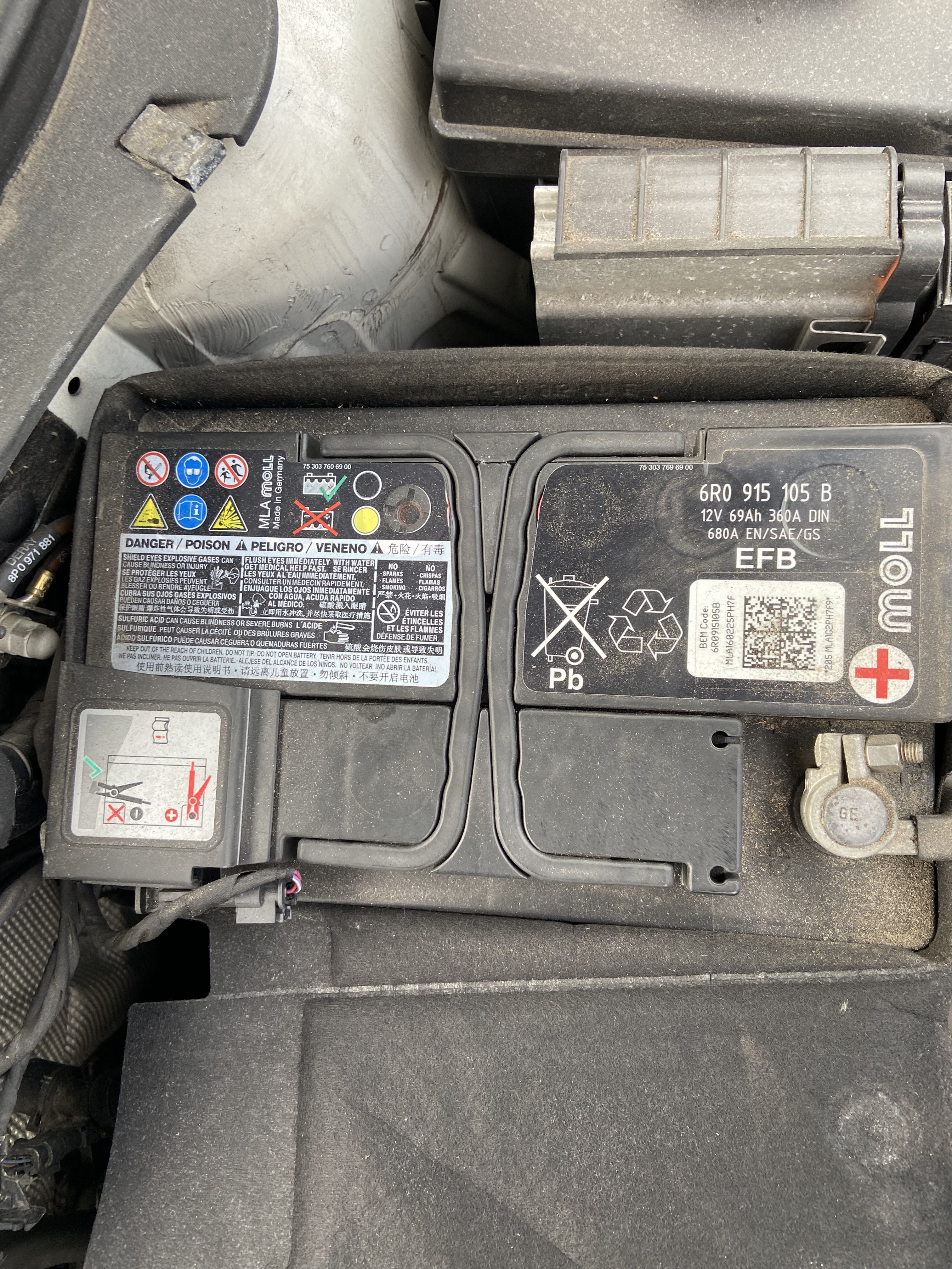

  7. Thank you BillyParker for advising to set type to fleece as I would probably have chosen Binary - AGM. Car started this morning, went to work (about 18 miles) with radio off etc, but at the end of the day it was completely dead so car left at work until I get a battery. 🤬
  8. Many thanks Carlston and Bap33. I may be able to borrow an OBDeleven to do the coding.
  9. Many thanks Carlston, My existing battery is an EFB battery, is it ok to fit an AGM replacement battery instead?
  10. Good evening, Just tried to start my Superb and battery is flat to 10 volts. Probably due a new one as it is over 7 years old. It is a Moll EFB battery (see attached photo). Can anyone recommend the ideal replacement please. Your help would be much appreciated.
