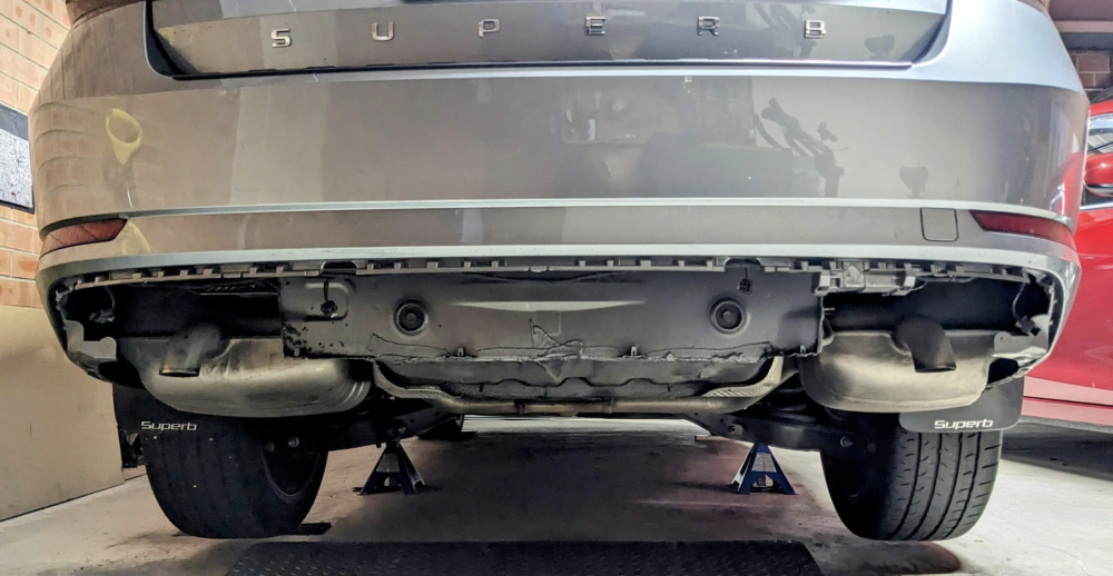

Can anyone tell me how to physically get at the rear sensors on my superb estate 2020 model.  One has dropped inside the bumper and I need to glue it back in?  Thanks, Chris
the easiest in my opinion and the official method is to remove the rear bumper, not too hard to do either
Many thanks.  can you recommend a suitable video please?
I think ApertureS answered your question in response to your original post.
If you have small ramps or any mean to raise rear wheels by 4-5", you can lay under the rear bumper and you can access to the sensors. If it's one on the opposite side of the exhaust outlet, you first need to unscrew a kind of small undertray.
Of course, if you have thick hands or Schwarzenegger's arms, the official method is highly recommended... 😁
Edited by Bap33
Thanks for the 'heads-up' on how to get to the sensor.  I have ramps and long, skinny arms, so I'll give it a go.  Many thanks, Chris

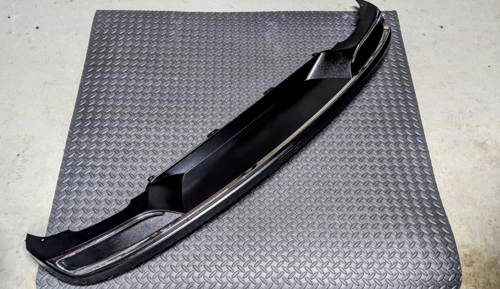

The rear parking sensors r located on the lower diffuser section.
U can easily remove this bit alone without removing the entire rear bumper.
It's got 4x torx screws underneath, and then clips across the top, and either end.
Thank you so much!  I wasn't looking forward to trying to get the main section off.  I'll have a go at the job with a lot more confidence.  Thanks again. Chris
