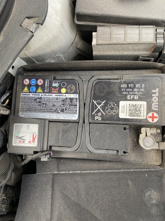

Just tried to start my Superb and battery is flat to 10 volts.  Probably due a new one as it is over 7 years old.  It is a Moll EFB battery (see attached photo).  Can anyone recommend the ideal replacement please.

My existing battery is an EFB battery, is it ok to fit an AGM replacement battery instead?
28 minutes ago, Spacehopper7 said:
Many thanks Carlston,
You can fit AGM instead of EFB.
AGM is better quality than EFB and should last considerably longer.
You might have to code the new battery, although you would need to ask someone else about that.

It's an easy 5 minute job on OBD11. If you fit a AGM, change type to fleece, and change capacity as it will probably be higher.

Of course If the capacity is higher than original, change that also, and change type from EFB to Fleece which is the name Skoda uses for AGM
