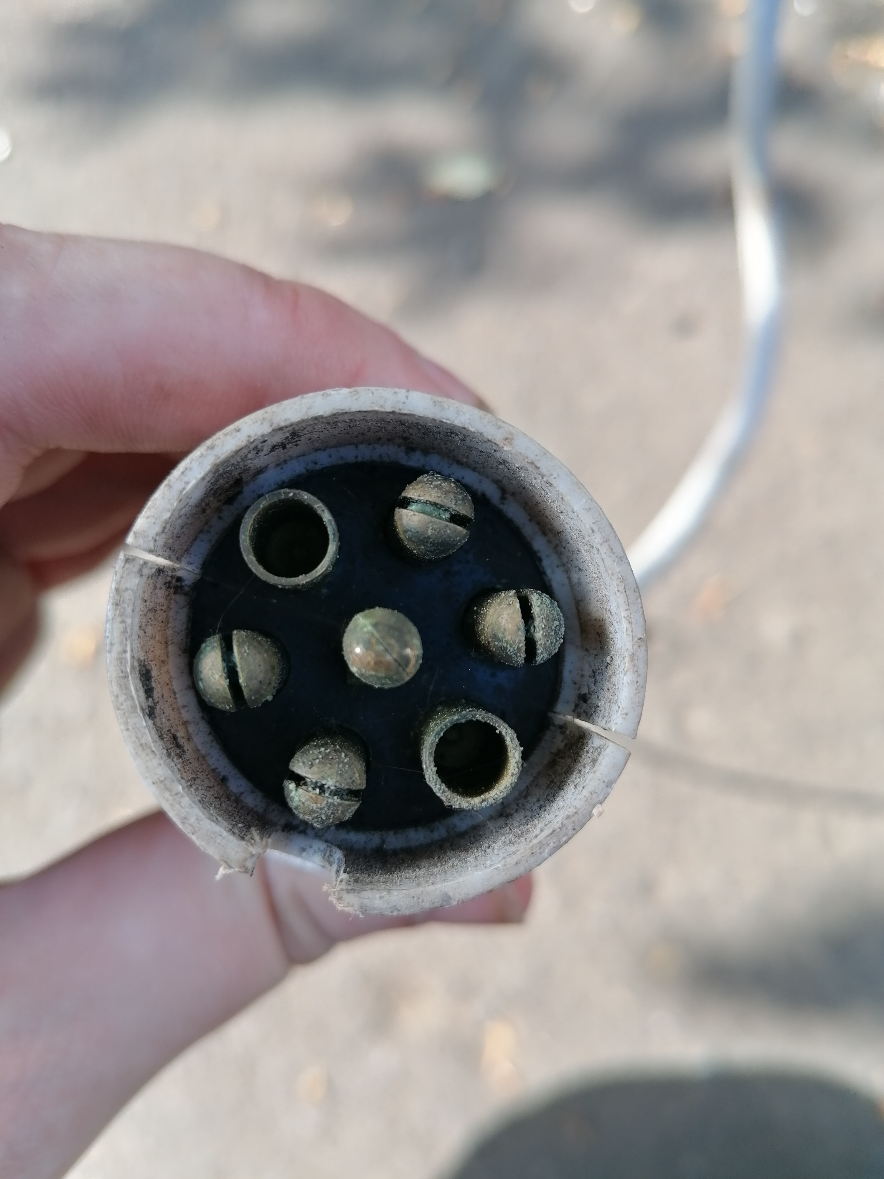

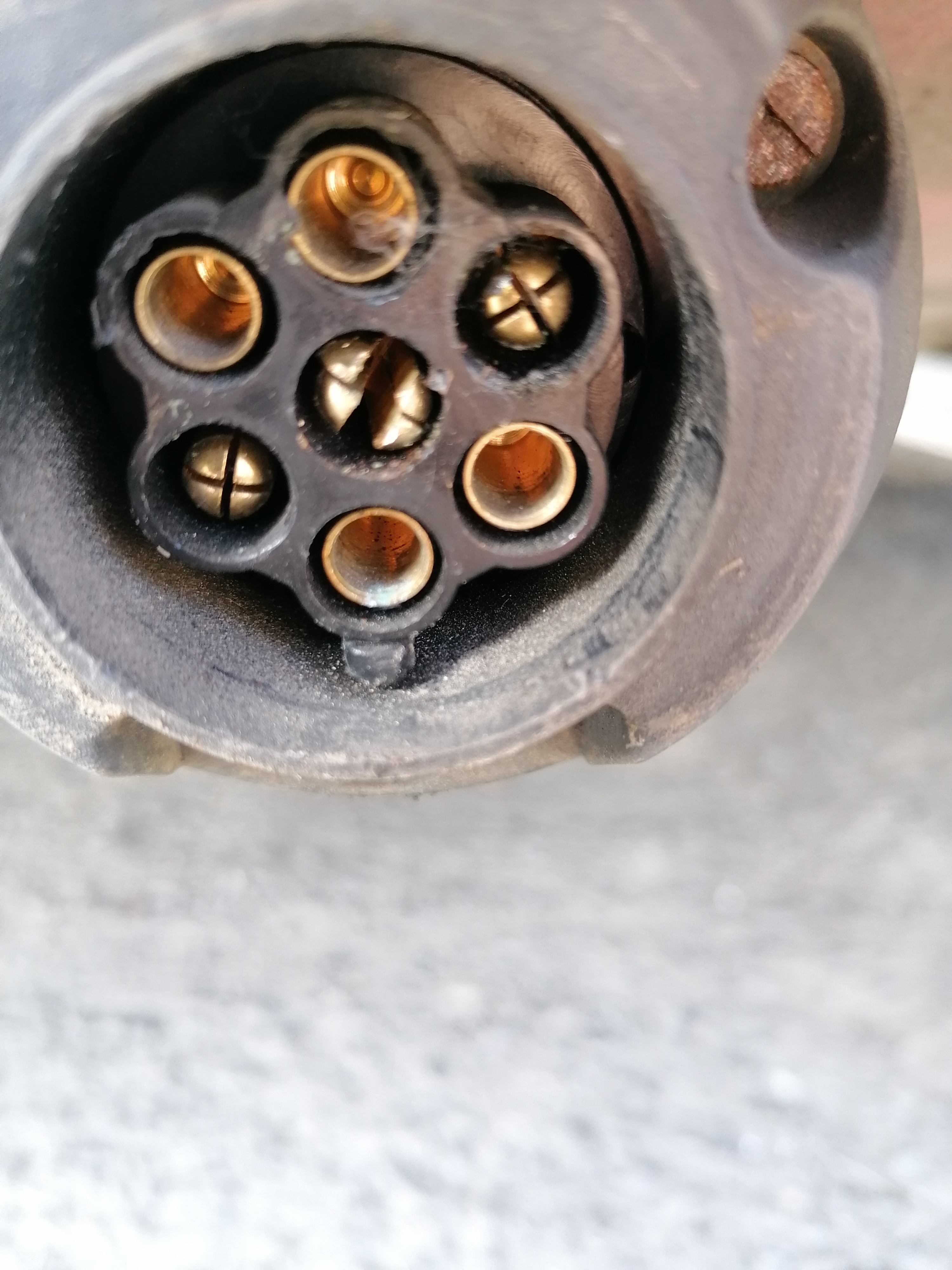

  11. No idea if it was working as the relay was removed back in 2017 it was buzzing all the time due to water ingress so I removed it. I had never needed it as I've not had anything to tow until now. Installed a new relay today and everything's working but the when you turn the lights on all the sidelights come on. But the brake light come on instead of the rear lights and when you press the brake they flash. I'm ssuming this isn't correct. Not Fan of electrics lol
  12. I've found the correct one on the caravan side and wired in the rely everything is working on the caravan. Indicators. Side lights but when the lights are on the brake lights come on and when you hit the brake pedal they flash. Is that something to do with the 12n socket? Thanks Luke
  13. Just brought a caravan and refitted the towing relay. Last one got water damaged. Gone to plug it in and the sockets don't match. Anybody know what adapter I need for this? Cheers Chris

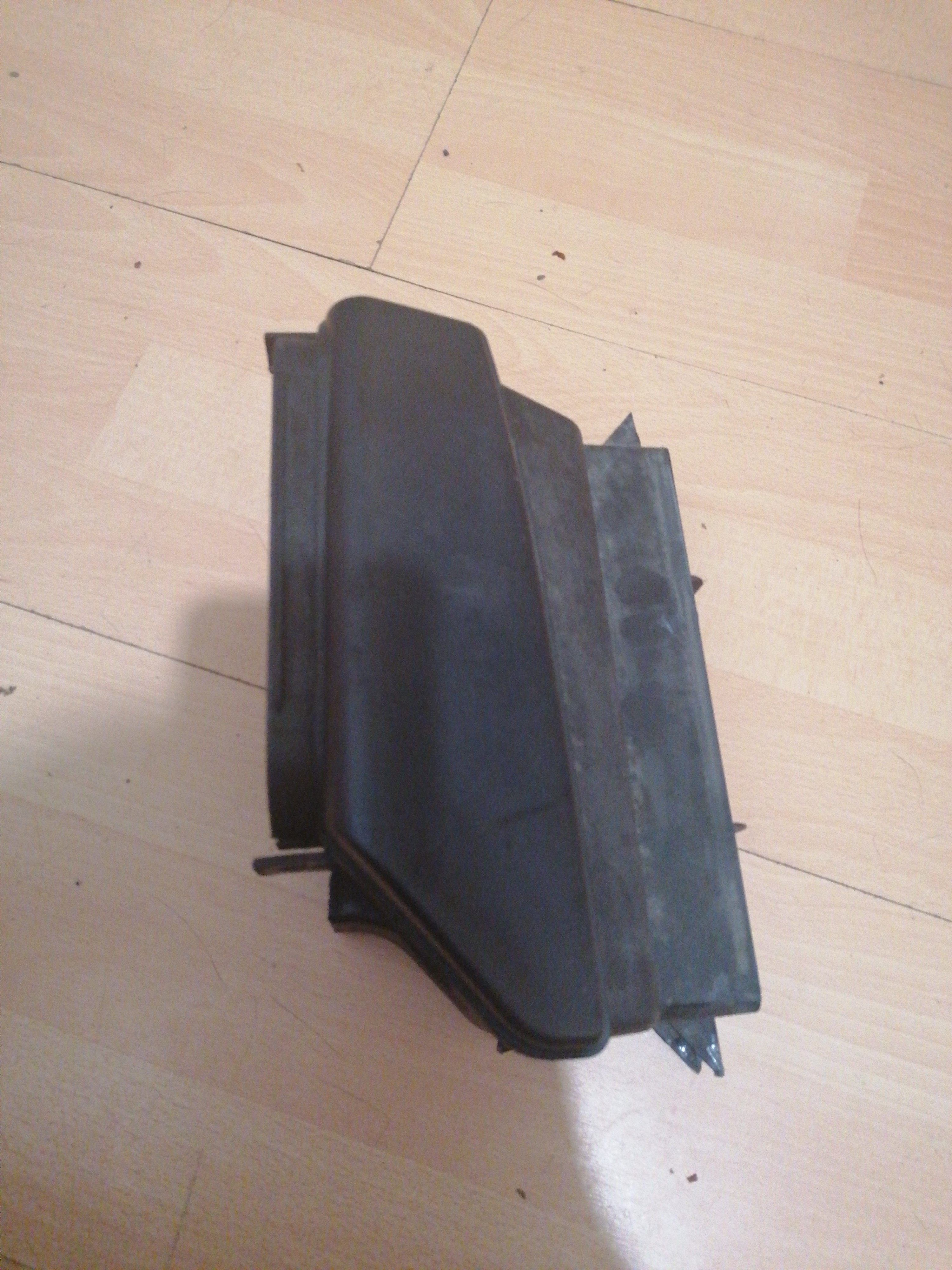

  22. Anyone know the part number or part name etc of this part of the intake from an 07 vrs tfsi? Much appreciated
