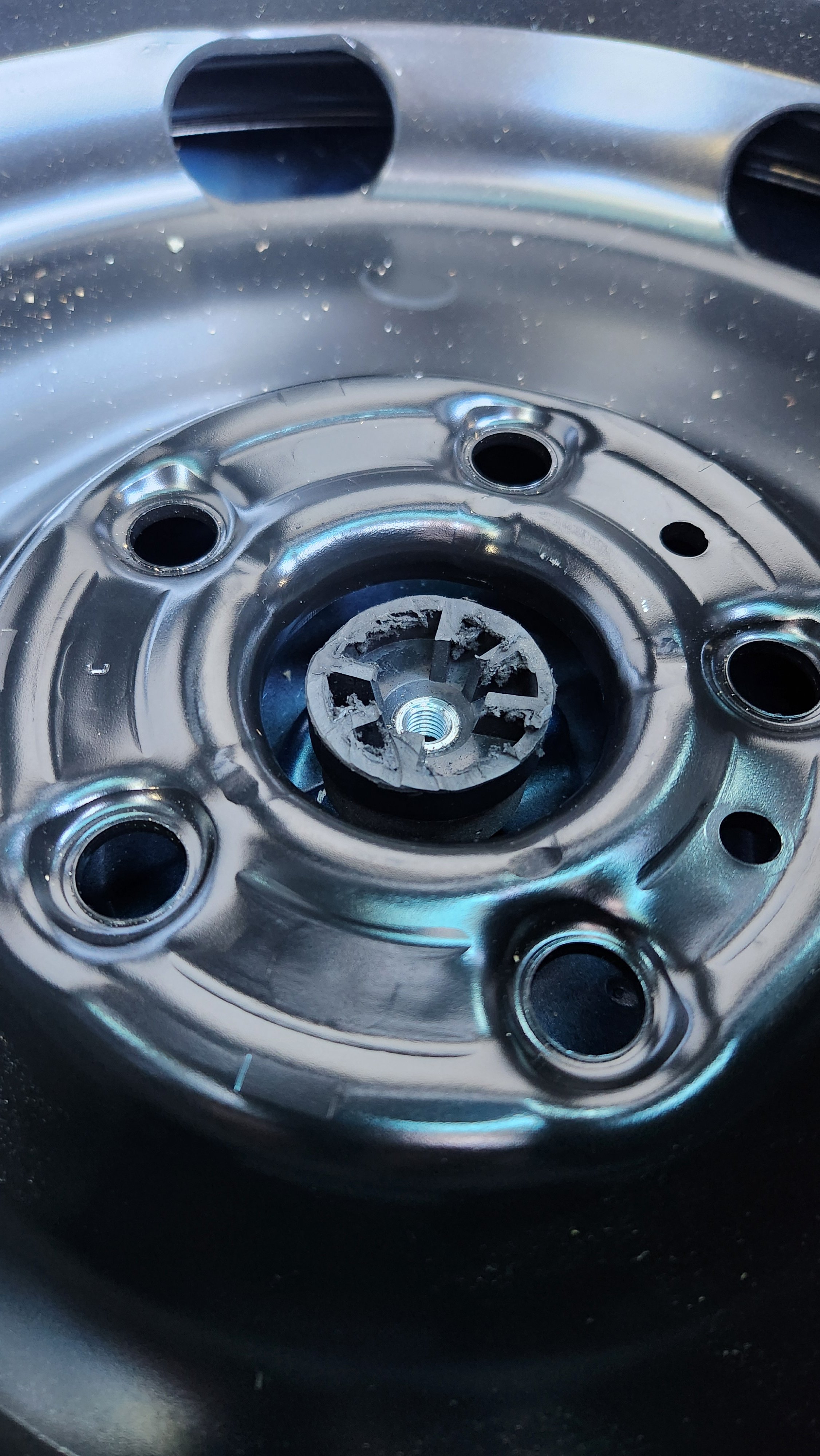

  5. It doesnt really matter what the rim is. If you measure from the inside wall of your rim, to the top of the wheel hub, then that is the distance you need to pack the woofer up. Plus how much the driver membrane sits above the outside wall of the rim of the woofer. My measurements wont help as it depends what yours are.

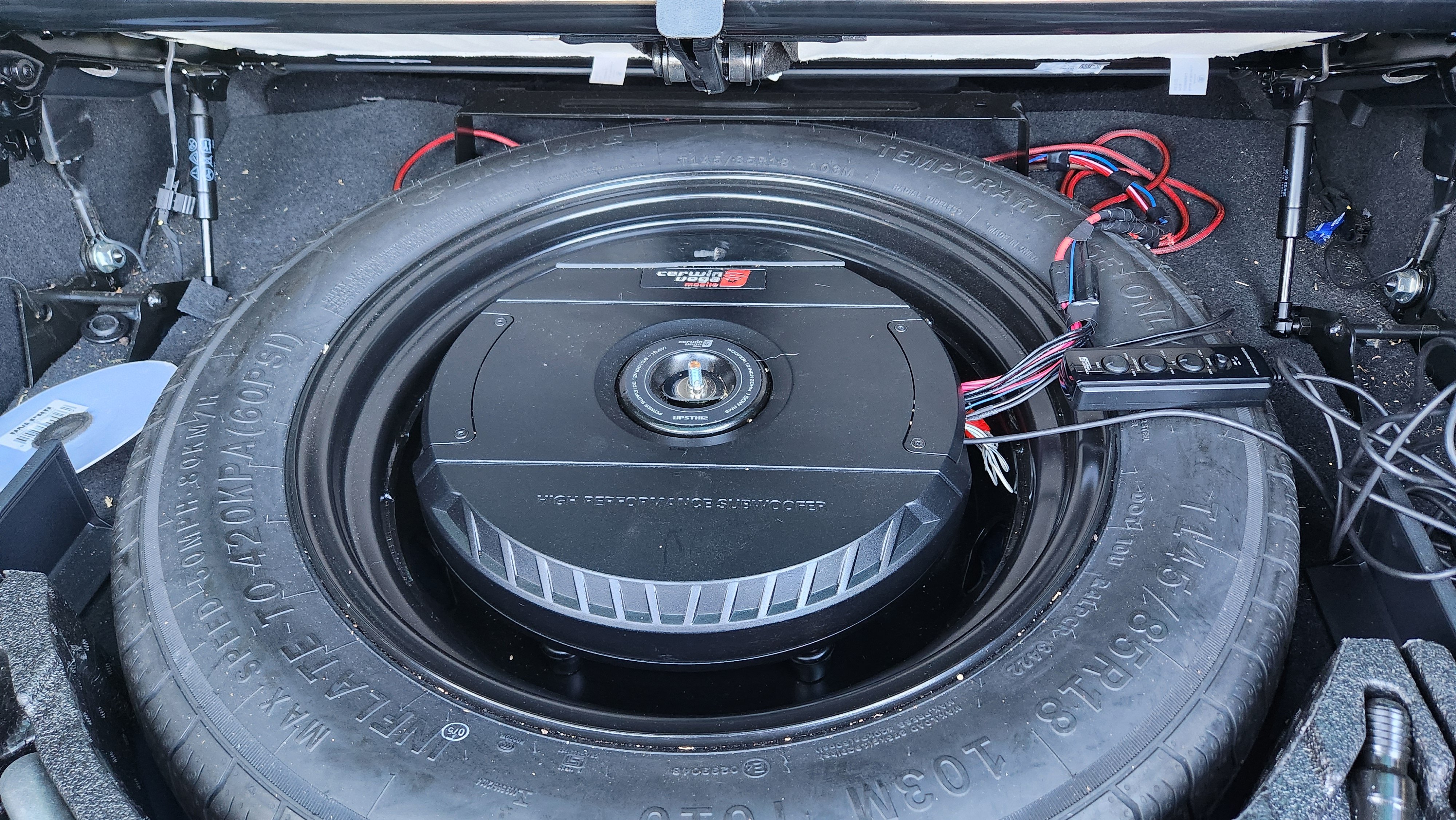

  6. You can see the cut down centre piece which comes with the woofer for VAG vehicles. I measured the size of the rubber feet carefully so they were high enough to lift the membrane off the inner part of the wheel rim but low enough that the 3rd seat row doesnt hit. Your wheel rim may be different. It shouldnt be, but it is posssible. It might be some trial and error to get the right size rubber stoppers. I looked at all sorts of things to support the woofer to get the right height. Layers of gym mat flooring cut in a circle etc.

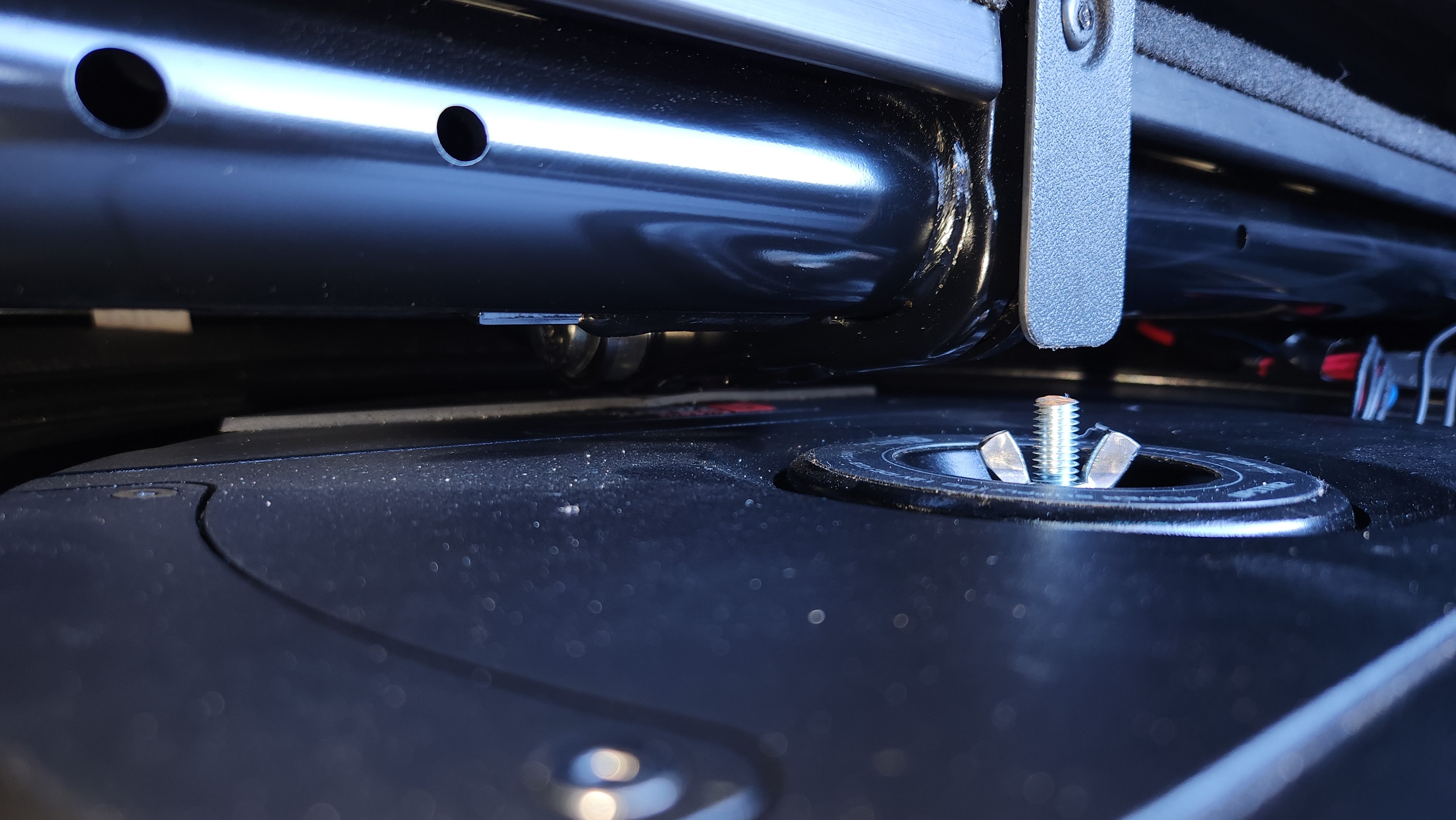

  7. Sub in place gap between sub and seat bar

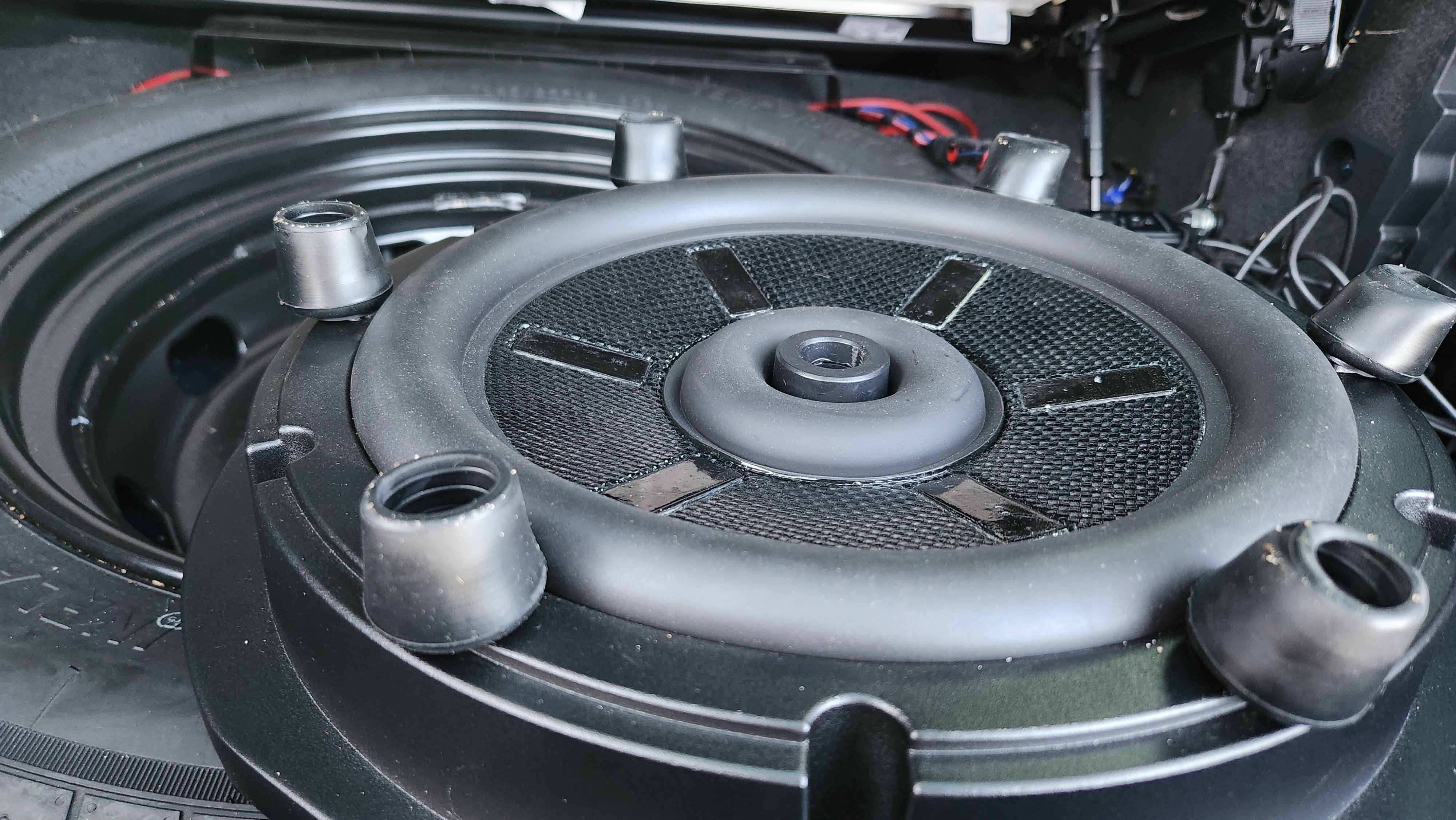

  8. The power wire path is described above. From fuse box distribution bar, through grommet in firewall, into footwell in the front of the car then used an electrician pull tape by pushing from the rear boot inder the carpet through to the footwell along the side of the transmission tunnel. I used similar to https://sydneytools.com.au/product/wattmaster-elmf4-4m-pull-through-fibreglass-rod-feeder-cable But mine was 15mm wide by 3mm? Thick. You tape/attach your power cable (and turn on wire if using low level speaker wires) to the tape and pull back through. Now for the subwoofer. I pulled the lower ptotective enclosure off the sub to expose the driver. I got 6 x 22mm rubber chair feet. https://www.bunnings.com.au/surface-gard-22mm-black-round-rubber-external-chair-tip-4-pack_p4050072 And made a small hole by poking a smaller phillips head screwdriver through the bottom of the foot. I then pushed the screw from the enclosure into the foot and through the hole so the thread pokes out the bottom. I then screwed the rubber foot on to the sub. So now when sub is in place, it sits on 6 x upside down rubber feet. The feet sit on the inside of the upside down spare wheel. There is a few mm between the middle of the spare wheel and the woofer driver. You then use the spplied woofer tyre bolt and plastic centre piece. NOTE !!!!! You HAVE to cut the plastuce centre attachment piece that locks into the floow of the car down so that it doesnt poke into the woofer speaker. I dont have a passive shallow cerwin vega to try to fit, but this may provde better clearance. Need to mount an amp but when when you have power back to the tyre well a mono block amp would work well. But all up, the speaker is protected inside the spare wheel. The sub is low enough that the 3rd row of sets support bar doesnt hit the top of the sub. It looks like it is supposed to be there. I will send a photo when i am back near the car. Its all snug and pumps proper 12" bass. I am still tweaking the gain but Metallica Sandman proper rattles all the mirrors. And you can now hear the treble and bass from Doppenberg.
