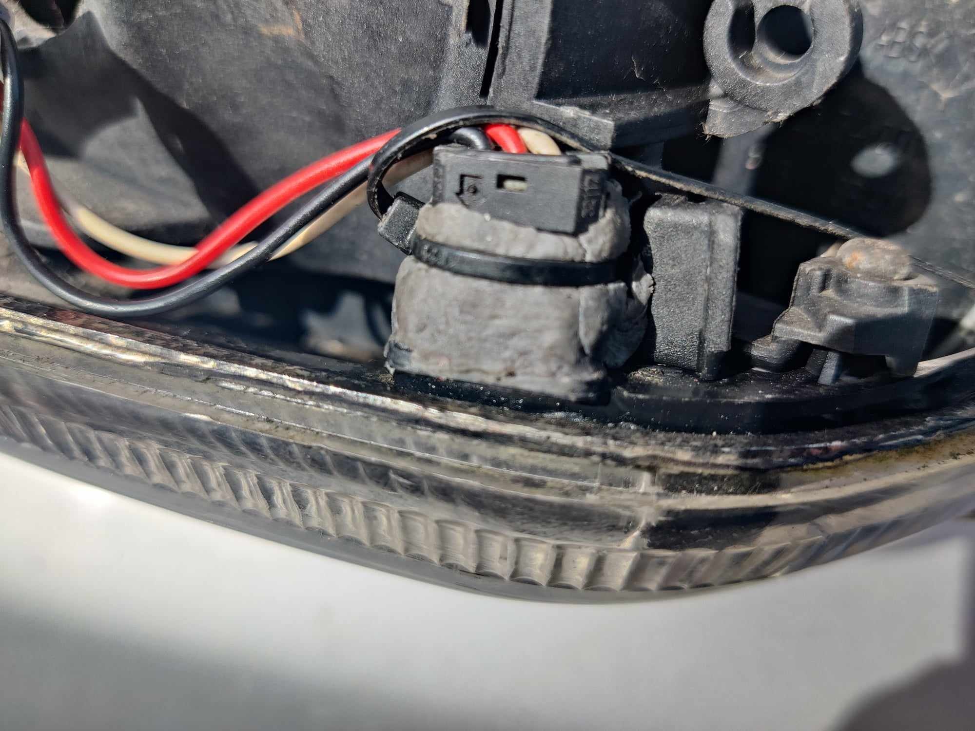

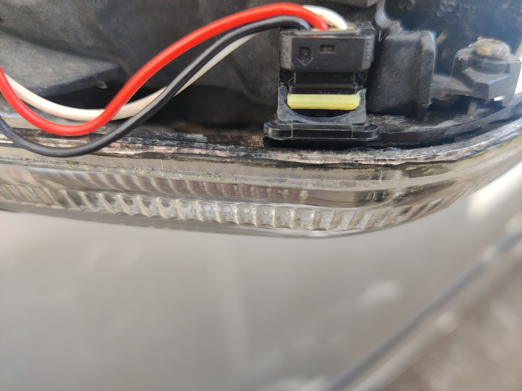

  1. Resurrection for hopefuls - check that there isn't damage at either of the plugs or their connectors. I used some kwiksteel & a tiny cable tie to repair the socket on mine.
  2. Eventually I found that the trigger that releases the large electrical connector, also behind the left headlamp, was broken & wasn't really holding the halves together. Cable tied together, all faults cleared, car runs really well again. Thanks all.

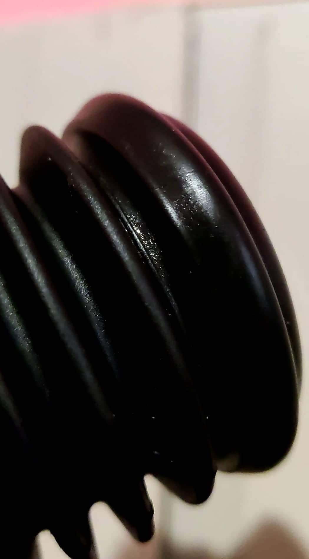

  8. Cheers. The gaiter was too small, and as you say there is limited space to play with. I'm very pleased, I'd almost given up hope. Nice cheap MOT pass, can't be bad for an 18 year old car. ☺️
  9. Thanks, I know nothing. Fortunately my sister-in-law devised what I will call the much simpler condom method. I rolled the end inside out, butted the gaiter up to the housing and pushed the lip back over. Sweet.
