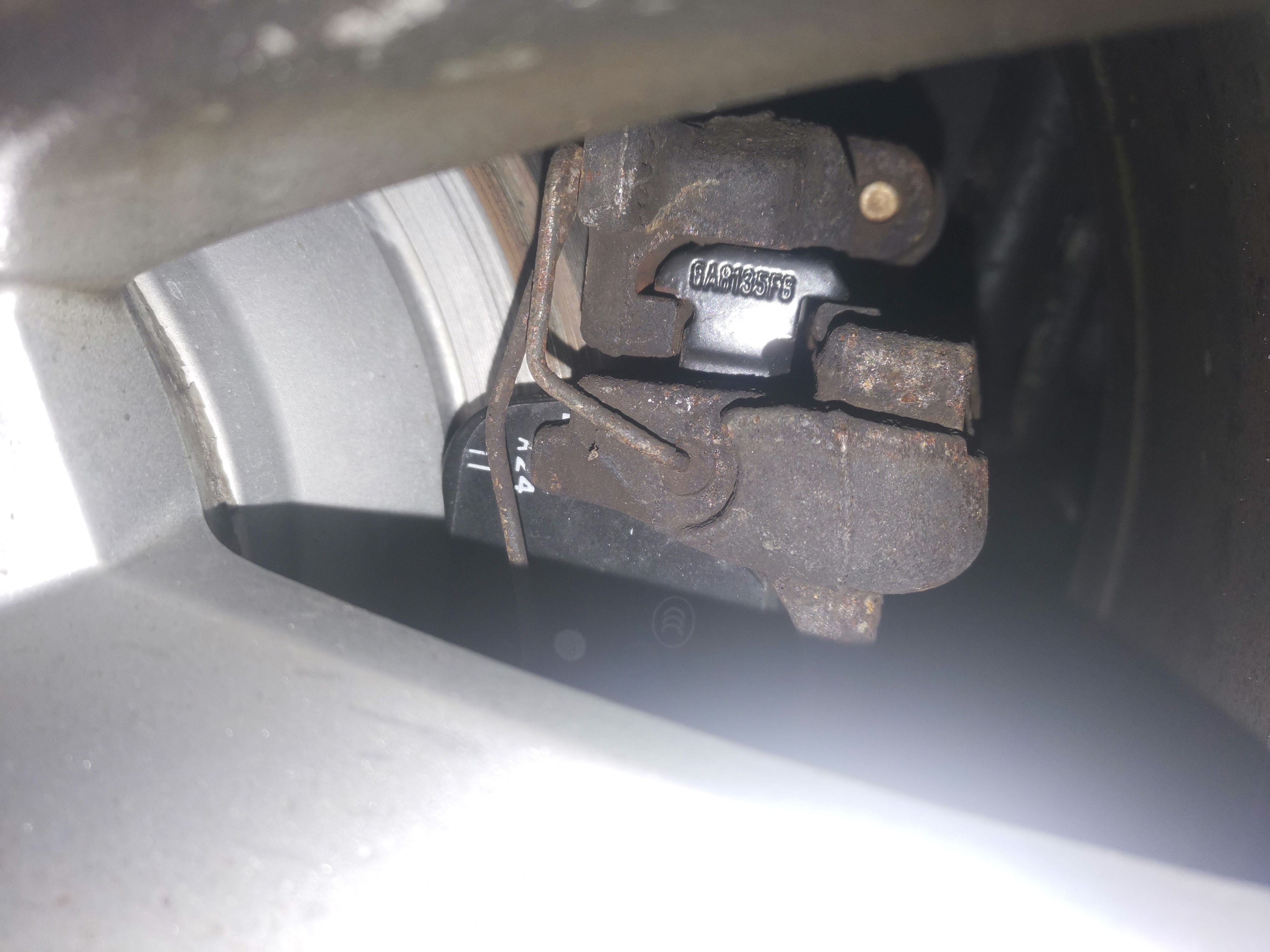

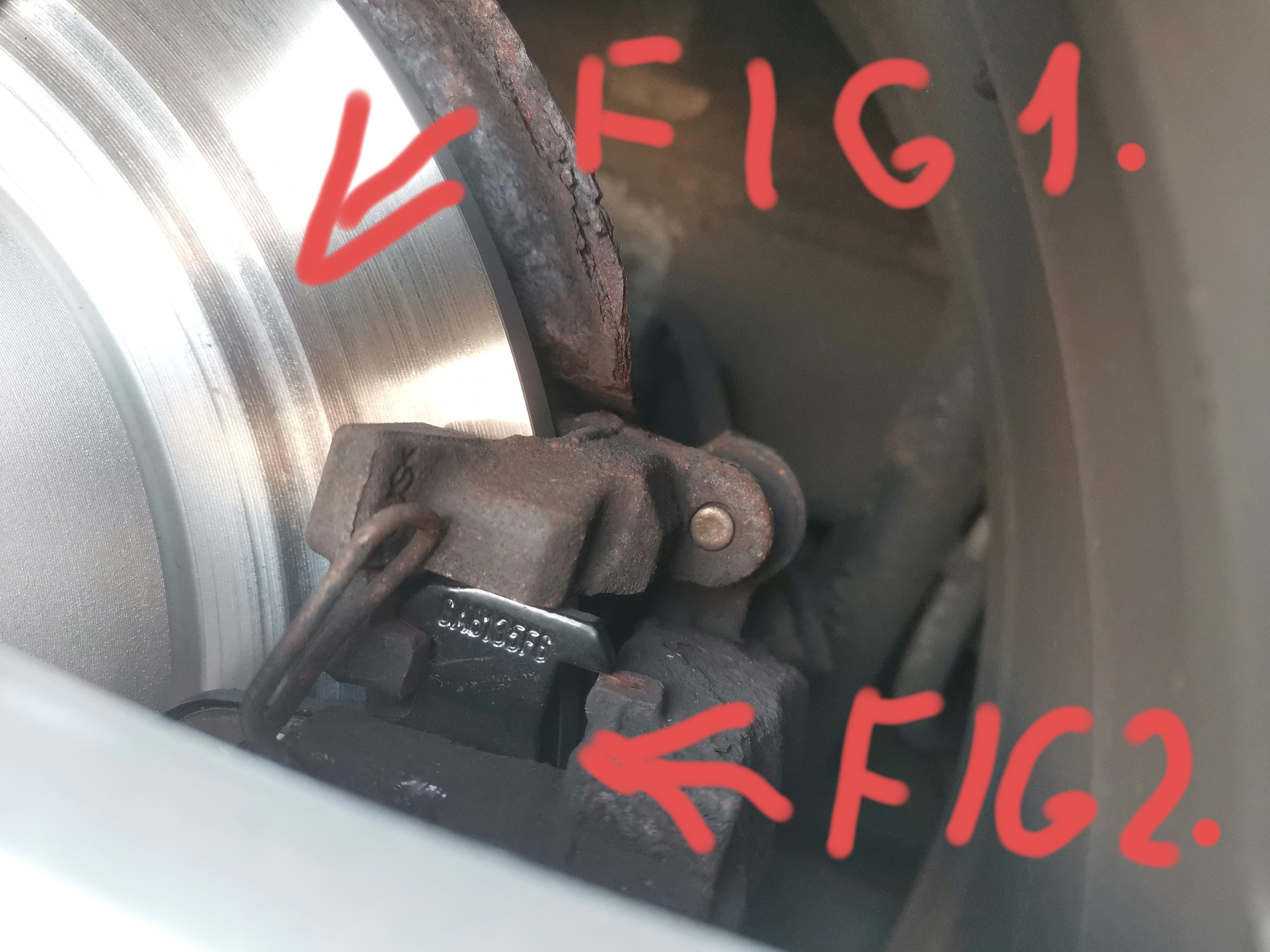

  1. @inspectorman , thank you for your reply! I probably sorted my problem now. Pads should be correct, I've found similar pads here, with same number: https://www.skoda-parts.com/spare-part/3q0698451m-brake-pads-rear-ate-ceramic-30850.html @D402 thanks a lot, You are my life saver! I was able to adjust springs through the wheel and took the car for short spin. Now I even think brakes are more responsive. I owe you a pint! 🍻
  2. I replaced my rear brake pads and discs. After few 1000's of miles discs are still worn just a little, as you can see from picture, there is still paint left on disc, (fig1 on picture). Also, when i drive slowly on stoney road, I can hear rattling from pads. When I release electronic handbreak, I can freely move pads, there is quite a lot of movement up and down. Pads are TRW ga8135fg from vw parts dealer, so rhey should be good for my car. But for me it looks like the gap on fig.2 on picture is strangely big. Any help, please?

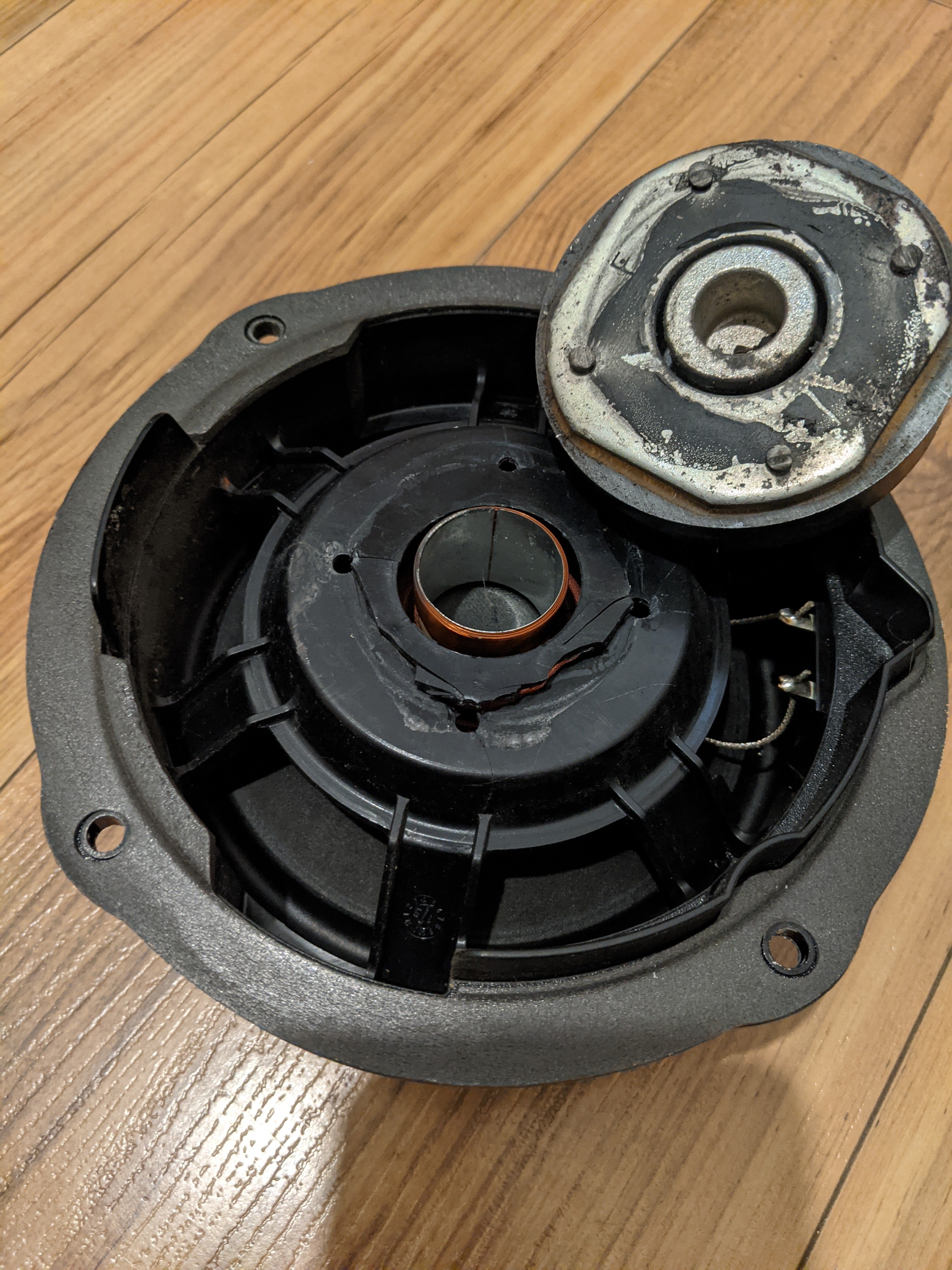

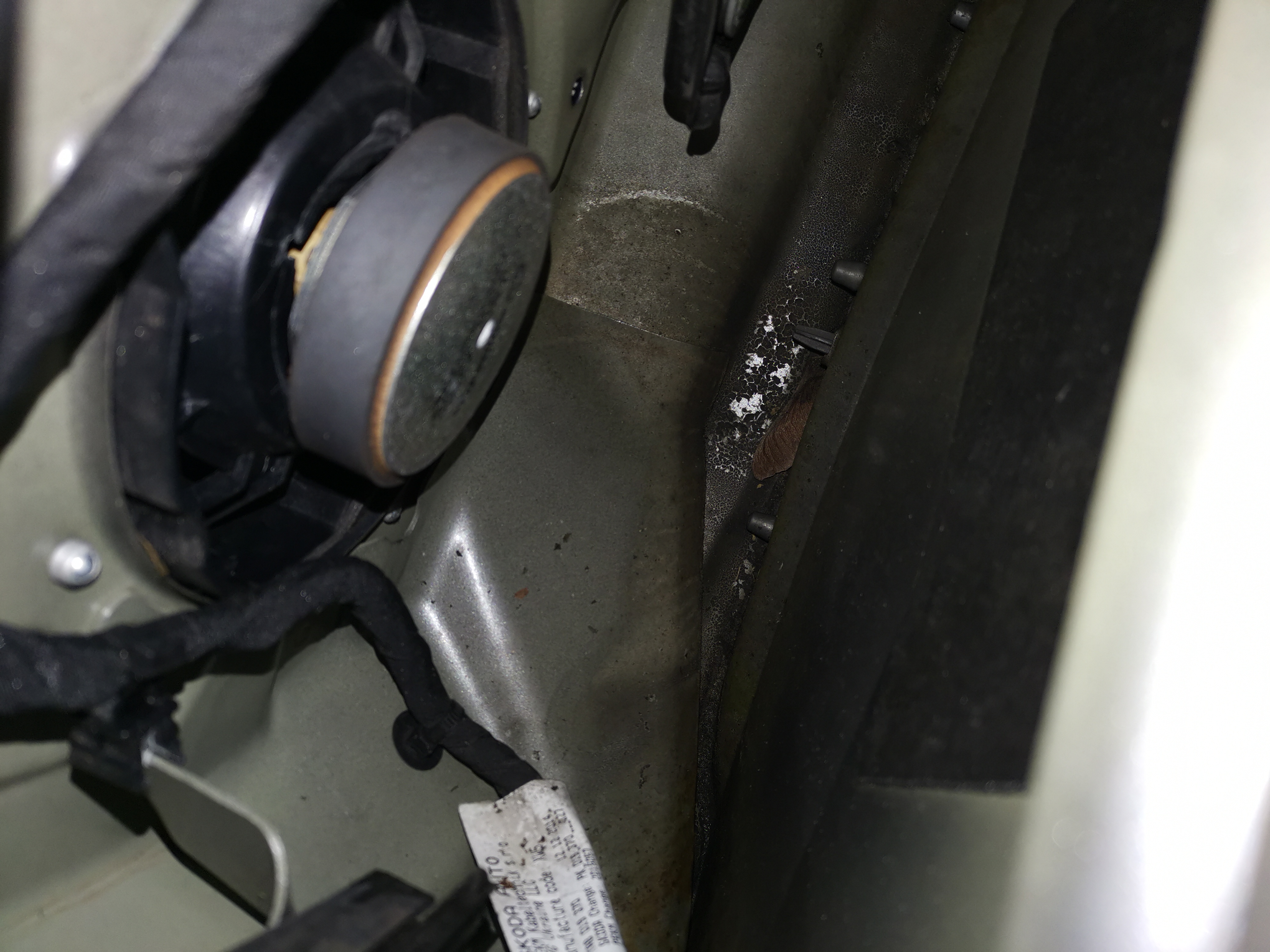

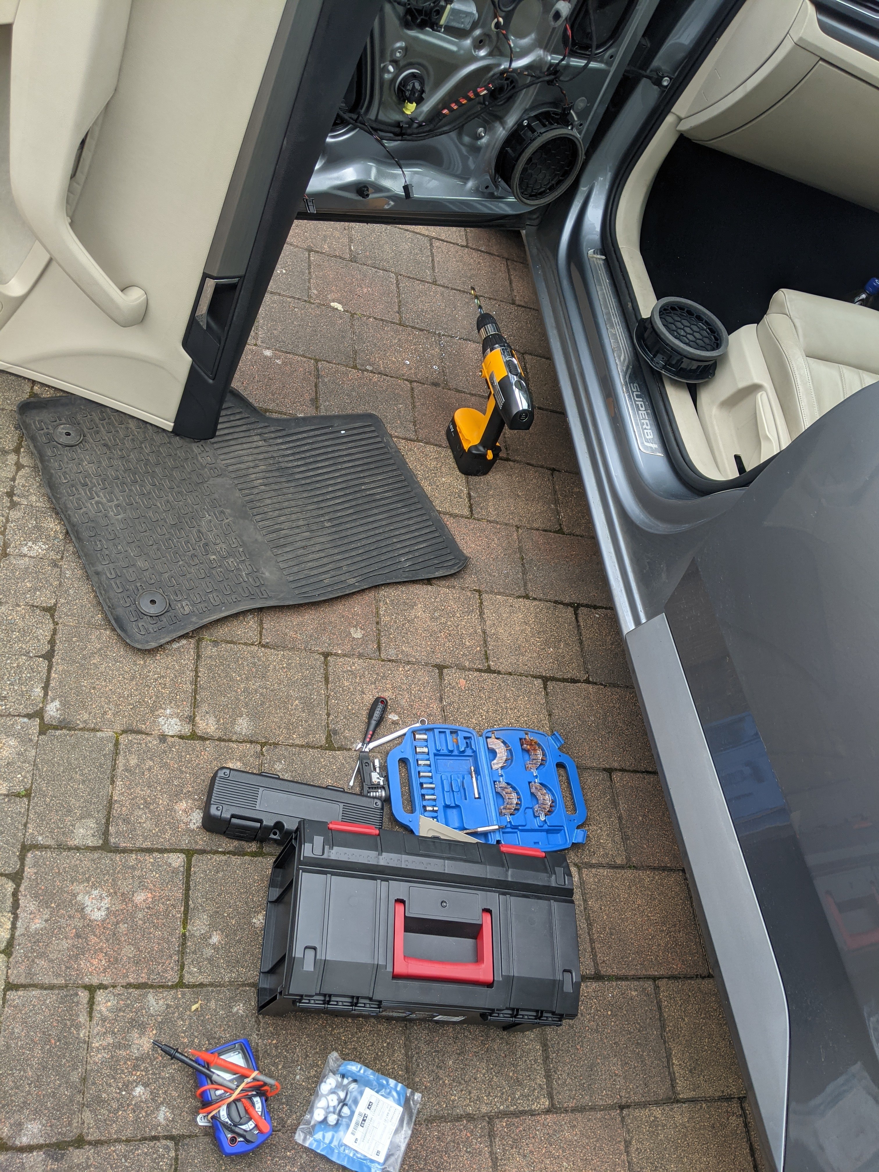

  3. Few times I refused customers (aka d***s) and they slammed doors really hard. My theory is, this can make micro tears in plastic and some random high volume music will finish the job. Lol, for few months I had big piece of fabric squeezed behind speaker inside of the doors, to push magnet back on place and it worked temporarily, until fabric got wet . This week I was finally brave enough to use rivet gun for first and probably last time in my life.

  5. Hi, I recently replaced my front speaker and I am surprised how it can be fragile, magnet just fall apart. Not sure, if this happened because of loud music, degrading plastic or slamming the door. If your speaker starts to play badly, it can be time to replace it too. I followed YouTube video how to disassemble doors. Needed: new speaker,spare plastic clips (because they often break), drill (to remove old rivets), rivet gun with rivets (preferably thicker and longer) and washers (maybe not necessary), 10mm wrench, screwdriver and patience.

  10. Hello! My left front speaker disintegrated, back magnet just hanging out. I am looking for replacement and found this: https://www.ebay.co.uk/itm/373082901603 I dont speak german much, do you think thats ok for my 2016 superb? Its normal audio system there, no canton.
