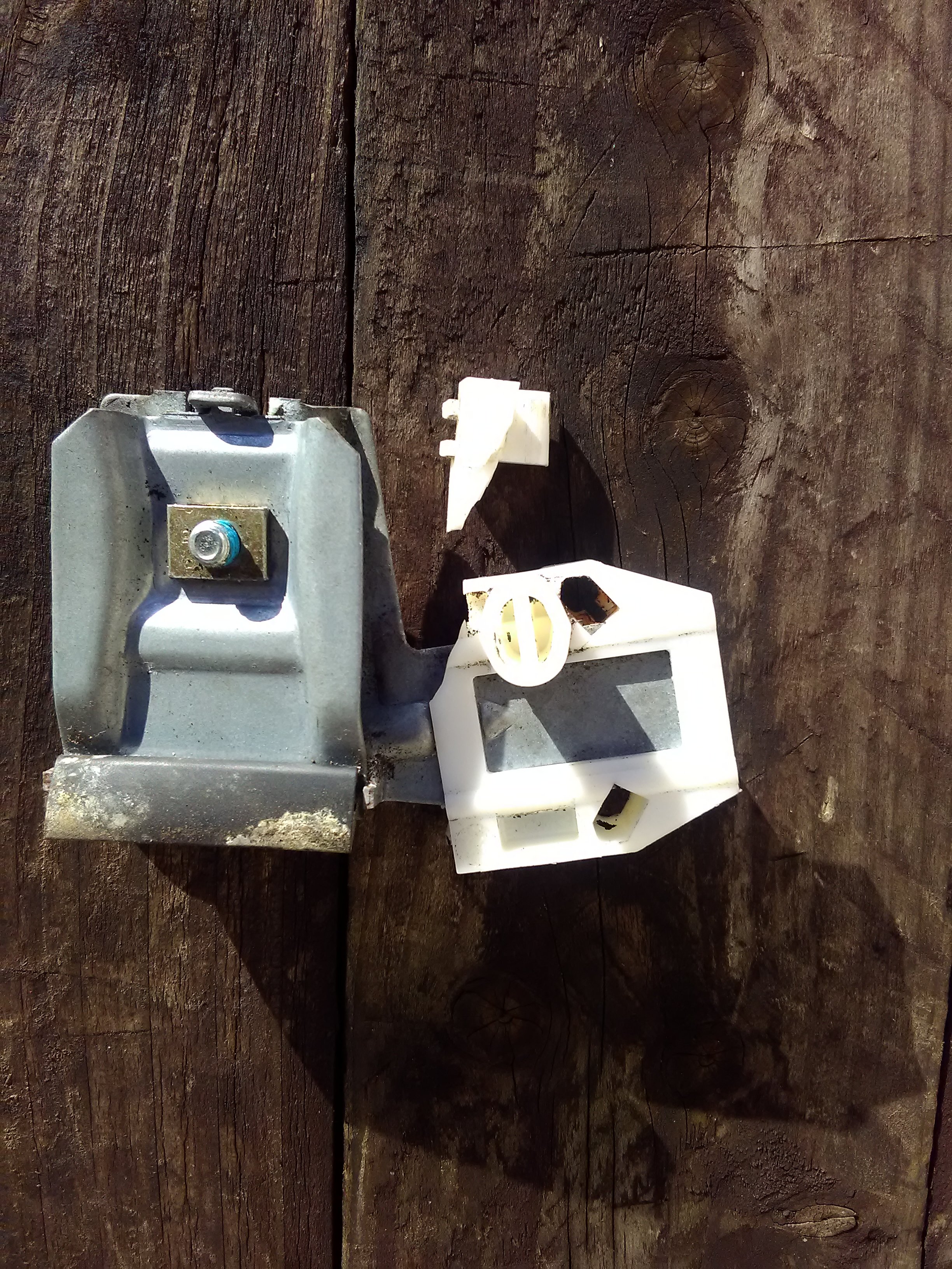

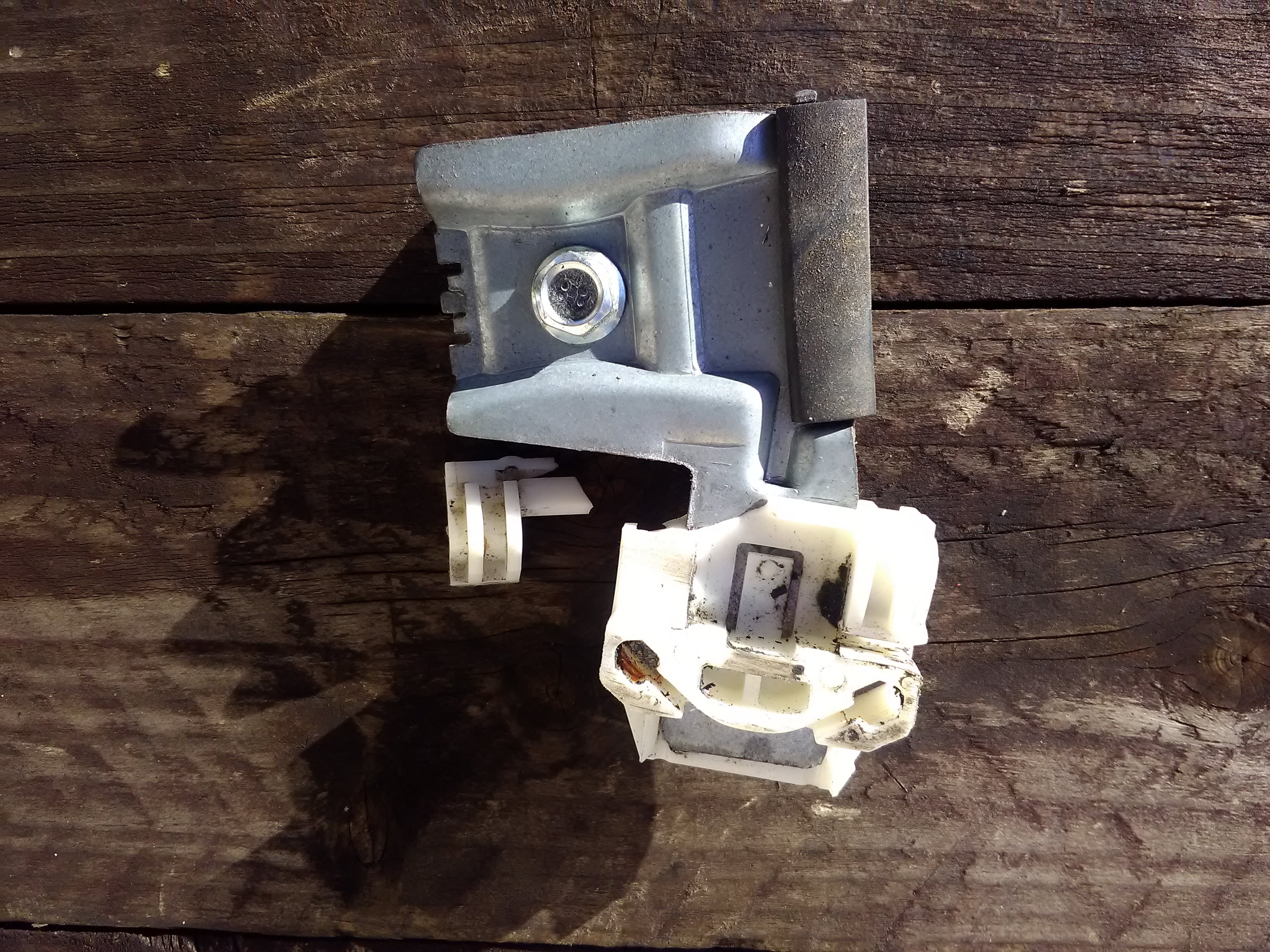

  5. Wow, that is a bit of a bargain! Too much of one? I'm surprised at how cheap they are though. Well, after a tad of a struggle & a lot of learning on the job - including unintentionally stripping & rewiring the regulator & cables! - we got the old clip plastic welded & back in place, drilled & re-riveted the carrier & door back together. Need to seal it up again properly at some point, but see how it goes. All working again so far, but with the expectation of just seeing how long it lasts and carrying a good roll of duct tape in the boot πŸ˜‰Take it from there... Maybe whole new carrier with regulator is the best and easiest way, it seems. Thanks.
  6. Ah, thanks. Don't look the same without the metal bits attached - but comparing them with said clips they may well be. I'll message them and see. Appreciated.
  7. Windows on the poor old Rat Skoda have been fine, then suddenly a few days ago, on raising, driver's side did a nasty bangy clunk, fell at an odd angle and refused to rise. Motor still working, managed manually to get it back up and secured with tape. Stripped down (butchered???!!!) door and carrier today, and found, as expected, the front of the 2 steel/ally and white plastic clips which the window's held on with at its base has lost a corner of the plastic. Don't know what these are technically called, struggling to locate a replacement set (E Bay doesn't apparently have "compatible" ones). It's a Saturday, so the main dealers are shut (!!!) Any clue where I can get some? (Online / by phone) Pretty urgent to get it sorted, hopefully can bodge back up as a DIY job, trying to plastic weld or glue as a temporary measure, but expect new ones are really needed. (Then the other side will doubtless go idc...) Thanks. Will try to attach photos if I can on an edit from another device in a bit.
