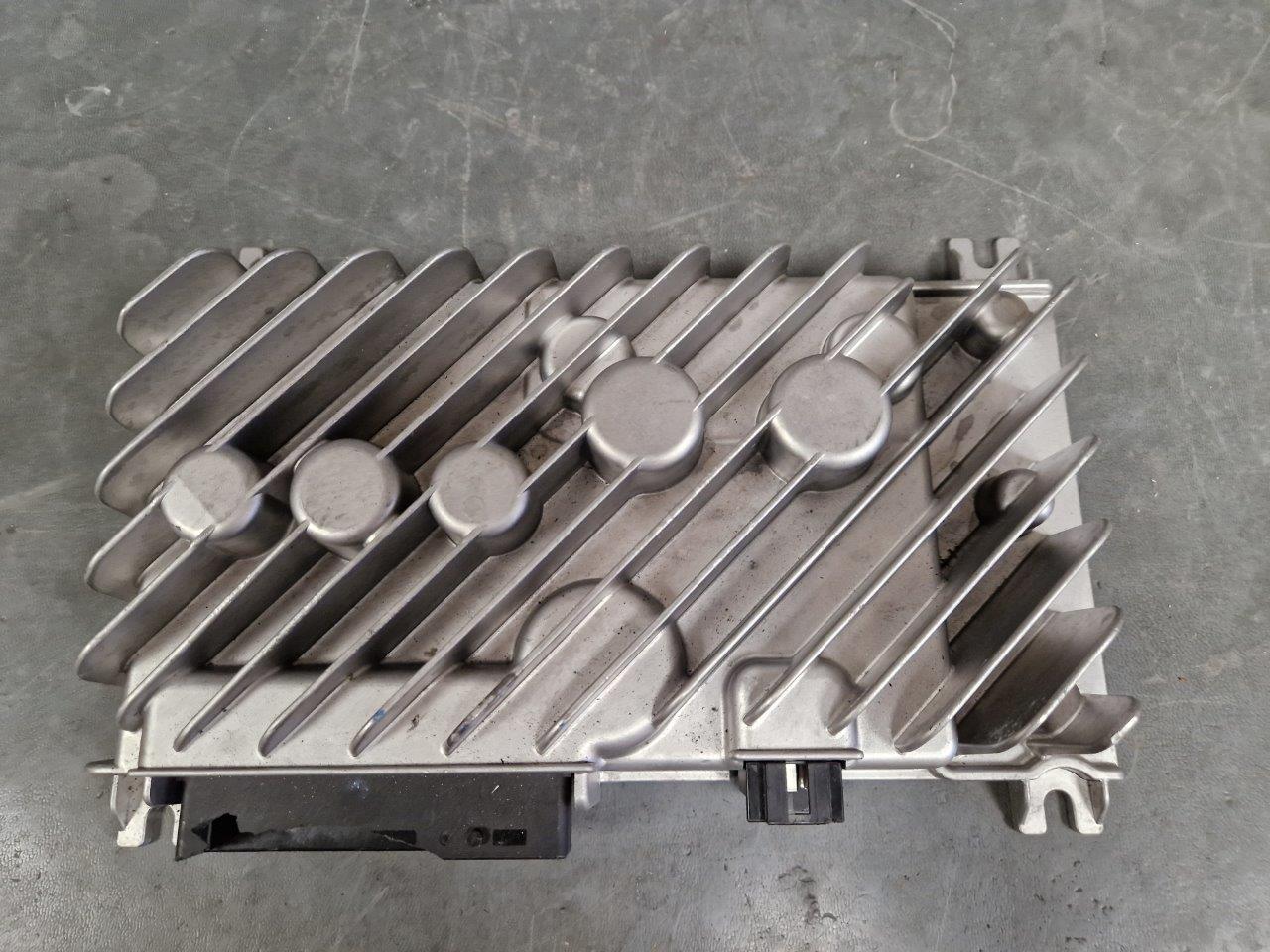

  3. 100W for 8Ω is 3.5A but 100W for 4Ω is 5A so there only 42% more current for the same power. Max power for 4Ω for FDA802 is 150W and 6,12A so without to much volume for the sub it should work just fine. Thanks for the image. That explains a lot. Will see how the sub will perform in the car. That is why I have 2x4Ω coil in the sub. At first I was planning to buy 10TW3-D8 but that is an expensive sub and not good for such small fit-box. Would be a waste of mony. 10TW3-D8 Qtc- 1.065 , MP 250 D4.3 PRO Qtc- 0.876.

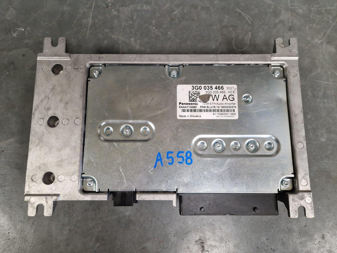

  10. New Superb 2.0 TDI 147kW. Wheels are from.... Passat B6.

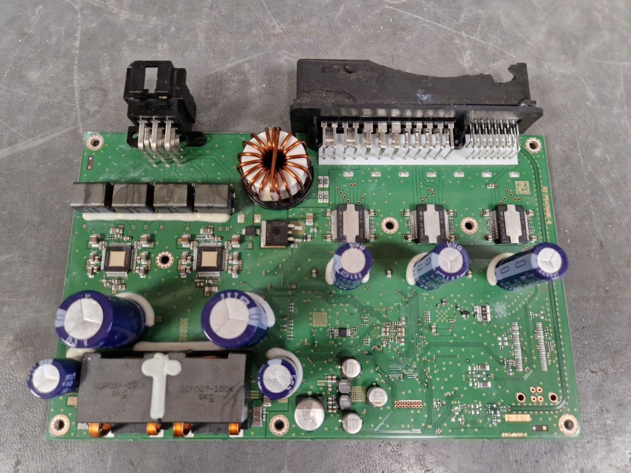

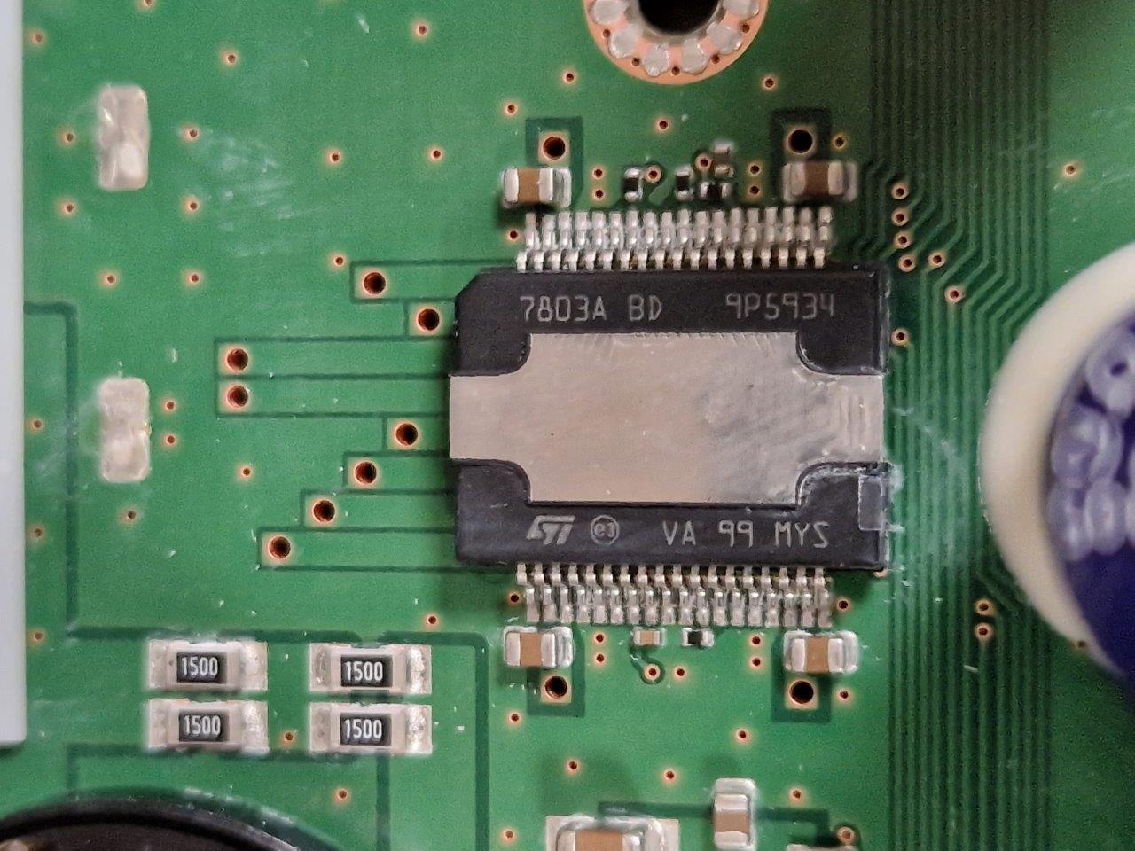

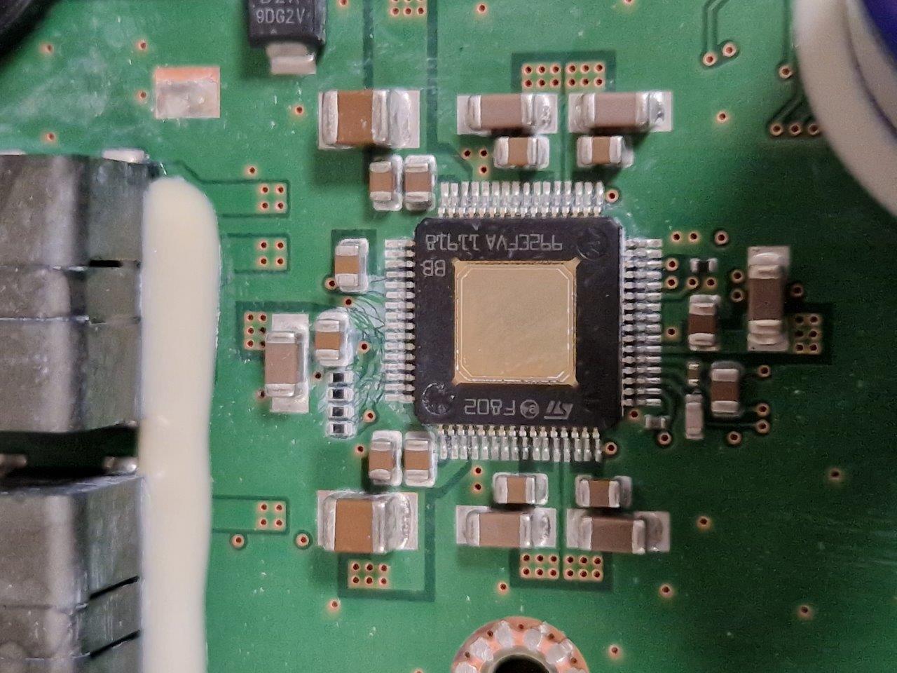

  11. Hello everyone, I decided to create a topic about canton amplifier 3G035466. There is similar topic on Octavia forum but there is a 3Q0035466A amp. Speaking of speaker ratings for the Canton system in the Superb...... Some photos attached. So, there is 3x TDA7803A nad 2x FDA802. TDA7803A is a quad channel amplifier capable of deliver – 4 x 27 W 4 Ω @ 14.4 V, 1 kHz, THD = 10% – 4 x 47 W 2 Ω @ 14.4 V, 1 kHz, THD = 10% FDA802 is a dual channel class-D amplifier capable of deliver– 2 x 120 W /4 Ω @ 35 V, 1 kHz THD = 1% (2 x150 W /4 Ω @ 35 V, 1 kHz THD =10%) – 2 x 140 W /8 Ω @ 50 V, 1 kHz THD = 1% (2 x180 W /8 Ω @ 50 V, 1 kHz THD =10%) Link for datasheets: https://www.st.com/resource/en/datasheet/tda7803a.pdf https://www.st.com/resource/en/data_brief/fda802.pdf FDA802 is capable of driving 4 Ω speakers but on 35V. I cannot find any full datasheet so no characteristics is available. But judging by the main capacitors voltage (63V) probably it is powered from 50V so 4 Ω speakers might be an issue. I will test that soon. So info from a Skoda brochure should be quite precise. 610W is and RMS power.
