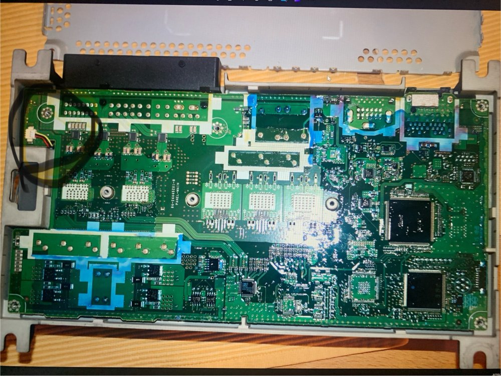

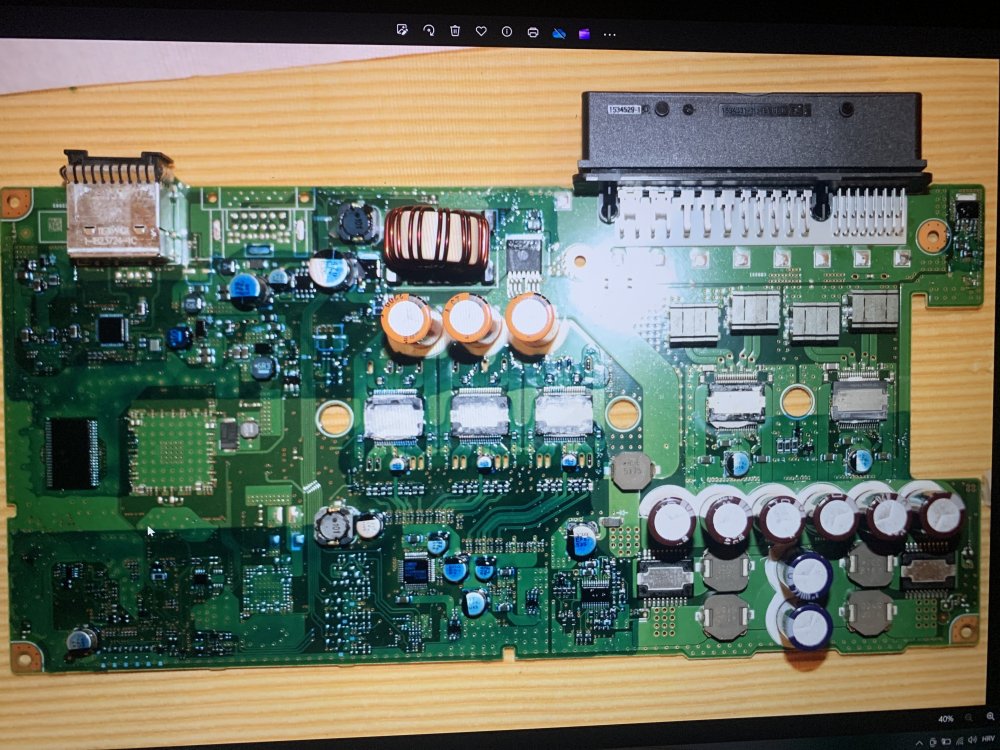

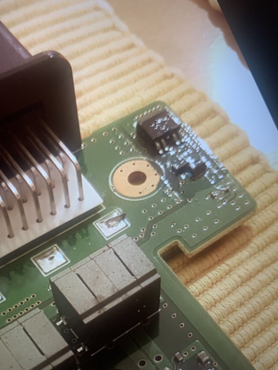

Hello everyone,
I decided to create a topic about canton amplifier 3G035466. There is similar topic on Octavia forum but there is a 3Q0035466A amp.
Speaking of speaker ratings for the Canton system in the Superb......
Some photos attached.
So, there is 3x TDA7803A nad 2x FDA802.
TDA7803A is a quad channel amplifier capable of deliver – 4 x 27 W 4 Ω @ 14.4 V, 1 kHz, THD = 10% – 4 x 47 W 2 Ω @ 14.4 V, 1 kHz, THD = 10%
FDA802 is a dual channel class-D amplifier  capable of deliver– 2 x 120 W /4 Ω @ 35 V, 1 kHz THD = 1% (2 x150 W /4 Ω @ 35 V, 1 kHz THD =10%) – 2 x 140 W /8 Ω @ 50 V, 1 kHz THD = 1% (2 x180 W /8 Ω @ 50 V, 1 kHz THD =10%)
Link for datasheets:
https://www.st.com/resource/en/datasheet/tda7803a.pdf
https://www.st.com/resource/en/data_brief/fda802.pdf
FDA802 is capable of driving 4 Ω speakers but on 35V. I cannot find any full datasheet so no characteristics is available.  But judging by the main capacitors voltage (63V) probably it is powered from 50V so 4 Ω speakers might be an issue.
I will test that soon.
So info from a Skoda brochure should be quite precise. 610W is and RMS power.

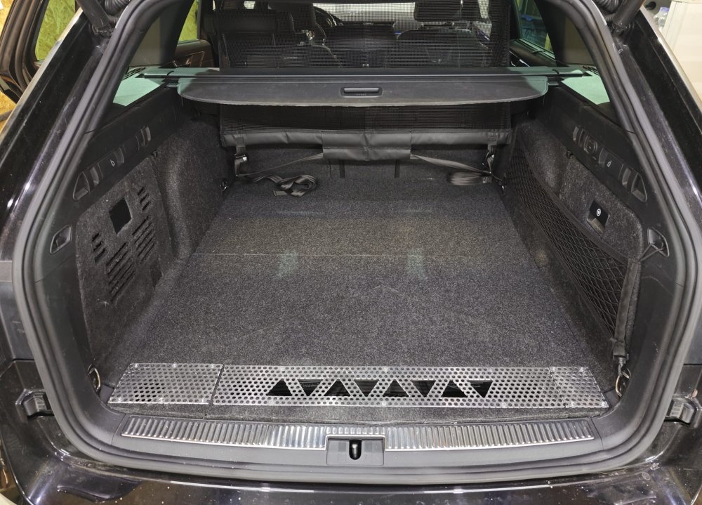

SDX is a 10" driver in a 28l sealed box behind the driver's seat. Drops beautifully. I tuned it in the summer at around 75dB levels, not 90+. Dayton measurement mic and AudioTool makes lots of things possible.

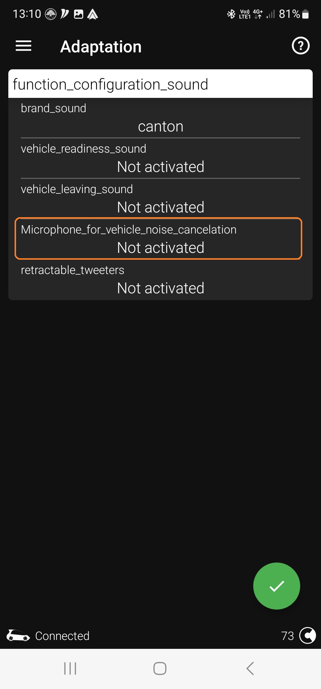

has anyone come across any information,
what equipment must be installed, to activate this option?
changing of first parameter in this screen, didn't give any noticeable changes

@MartiniB no idea, i haven't tried active cancellation or convolution with a phase-opposed version of the "standard" road noise at specific speeds, which would probably work well. Still have to find a way to implement it, the DSP i have probably can't. Source interference is hard with Spotify....
and for the record, Android Auto doesn't use BT for the sound, it uses Wifi Direct in the more modern versions, and I suspect a different codec in the cabled ones. which explains why it sounds different to BT.
There is no noise cancelling technology in the Superb. Simply not implemented. you also don't have a chance to use it to eliminate road noise as this kind of noise is not predictable.

@Paikesejanku sure it does. But the noise filter is causing some weird distortion, independent of the source
@Wacholek cannot imagine that the same amp is used in other VAG with noise cancelling. You need also several mics with corresponding input jacks and a lot of processing power.

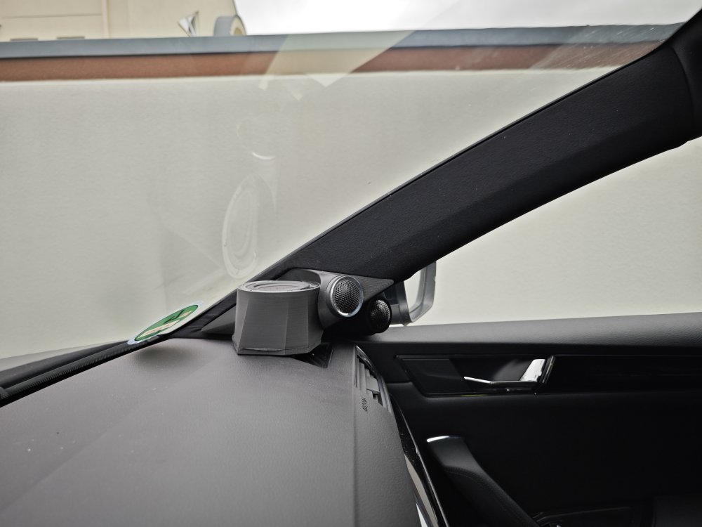

After all I ended up replacing all the front speakers and using a DSP processing all the channels and aftermarket AMP to repower them,

 - CSS SDX10 in 30l sealed. Weighted, double-baffled box behind the single seat. (fake) Speakon connector. That's 25mm of xmax and power handling of 400W... yeah, right, it's been happily eating 1kW for over 2 years.
 - SounDigital 1600.1 4 Ohm feeding the sub, so that's capable of 1.6kW, but i have the gain relatively low, so I suspect much less output. Power is fed down the driver's side (and I am assuming it's a 16mm2+ cable).
 - DSP is MiniDSP C 6x8. Fed at high level from the front outputs. There is no high pass filter on this setup that I can recognize; seven rings is a real test and it simply can't reproduce the *really* low stuff, most is fine. It's tucked behind the display with the USB cable fed into the glovebox.
 - fronts are powered by a Soundigital 4.100, 66W / channel, fully active for the fronts. Crossed over at 3kHz IIRC, need to check
 - Front system is a Helix S 62C.2, no crossovers in use except on the DSP
Fronts are limited to above 80Hz with the sub set up,  without it they are allowed full range. (It's uncomfortable to sit in the back with the sub up, so I have a setting with the rear speakers on and the sub off).
All TA is done in the DSP, as is the EQ. Everything is on 0 in the head unit; DSP off, full front. I have some whitenoise tracks if someone wants them, from 3kHz to 20Khz, and from 50 to 5000. Haven't got around to tuning the sub properly, but it's pretty good as is.
Levels are dialed in so they are within 1dB per driver from the driver's seat. TA is accurate as i can make it, I don't remember the software limitations.
Those part are interchangeable. Since there is an option in the coding so it is ready for this function. It is possible that there is another module just for the microphones. This one would make all the calculations and measurements. Head unit would be just to play it in the speakers. I do not have any schematic for Audi and I would not bother to look for one, but it might, just might, be possible.

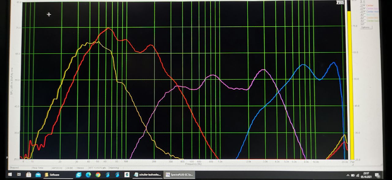

9 hours ago, spacelord said:
Also, how do you achieve the sub going deeper than 30Hz if there is a high pass filter in the sub signal?
How do you know that there is a high pass filter?
I will eventually test the signals from all channels. Will see how those crossovers are set.
I still believe that there is enough good in that factory Canton system.
Well, I know this because I measured the electric output of all channels. There is a 12db subsonic at 30hz and low pass at 50 or 60-5201718597259473961_121.thumb.jpg.4cebfa9aab0b3b01b56ce1f0fb9a584d.jpg

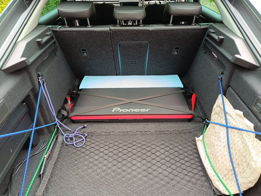

@brettikivimy system was previously an esx DSP on top of Canton, channelwise processing, a musway eight100, Eton csp16 and Eton Onyx mid in OEM places, Sub a 2*5" Eton Sub in BR enclosure Tuned to 28 Hz
Now i have an esx DSP Amp, a esx vx2000 mono Amp and 3*Arc 8 in sealed enclosure on the same Front, but mids and tweeter in a pillar. I sum up the Canton with a JBL fix82 for DAB tuner and do direct streaming via USB for the Android
Thanks for the image. That explains a lot. Will see how the sub will perform in the car.
