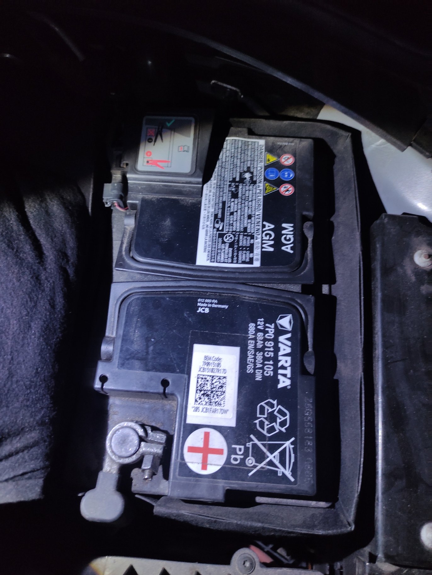

  1. I, too, needed a batter. Ended up get a Dash Cam, left it plugged in, and the 12 volt is always on, so run the battery. It never did recover. Anyway, 10-year-old battery. Replaced with an almost identical Varta. Made sure it was AGM too Old one new battery A7 Varta Silver Dynamic AGM 096 Start Stop Car Battery 12V 70Ah (570901076) (tayna.co.uk) The only difference I saw. Are negligible (in my opinion). 68Ah to 70Ah and CCA from 680A to 760A. I experienced a few errors, tyres/ ACC/ park pilot/Stop /Start. But after driving a few miles and restarting. All working fine. The Stop/Start finally kicked in. It's not worked for over a year. Spoke to a few garages. Who stated all they would do regarding the battery is update the serial number or date. So. it is worth paying £45) for this?

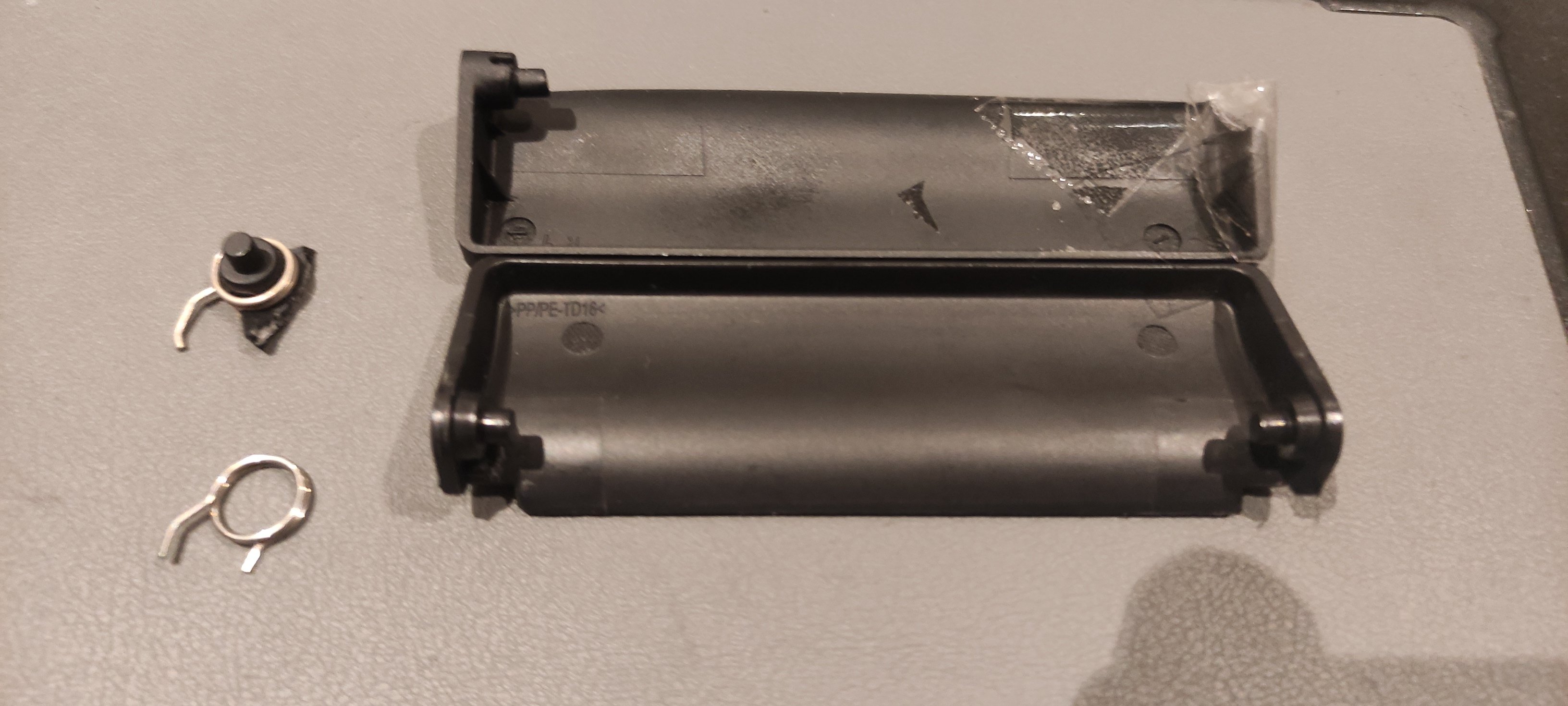

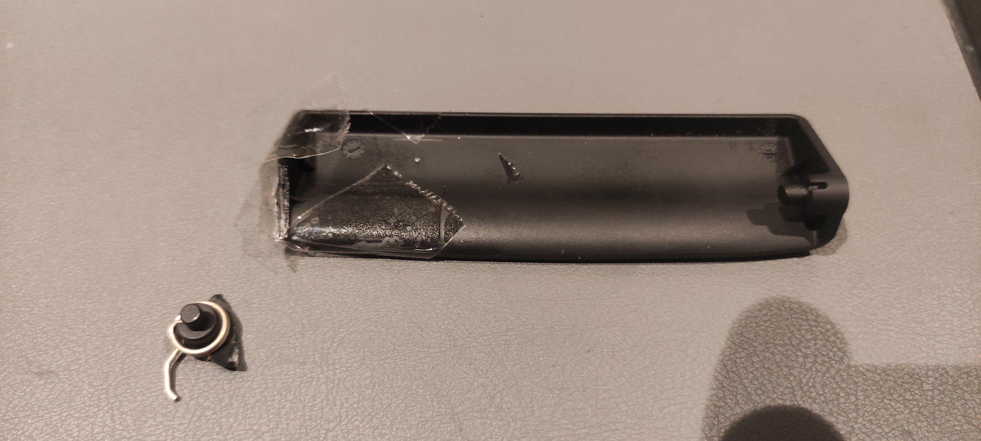

  2. Replacement from Ebay. Slightly narrower. The spring is different. Once fitted it failed to keep closed. May just have to glue it.
  3. Mine has also gone. So, it would appear to be poor quality. Car is 7 years old. I purchased a replacement for a left hand drive. Assumed it would fit. But too small. It attached but struggled to keep it closed.

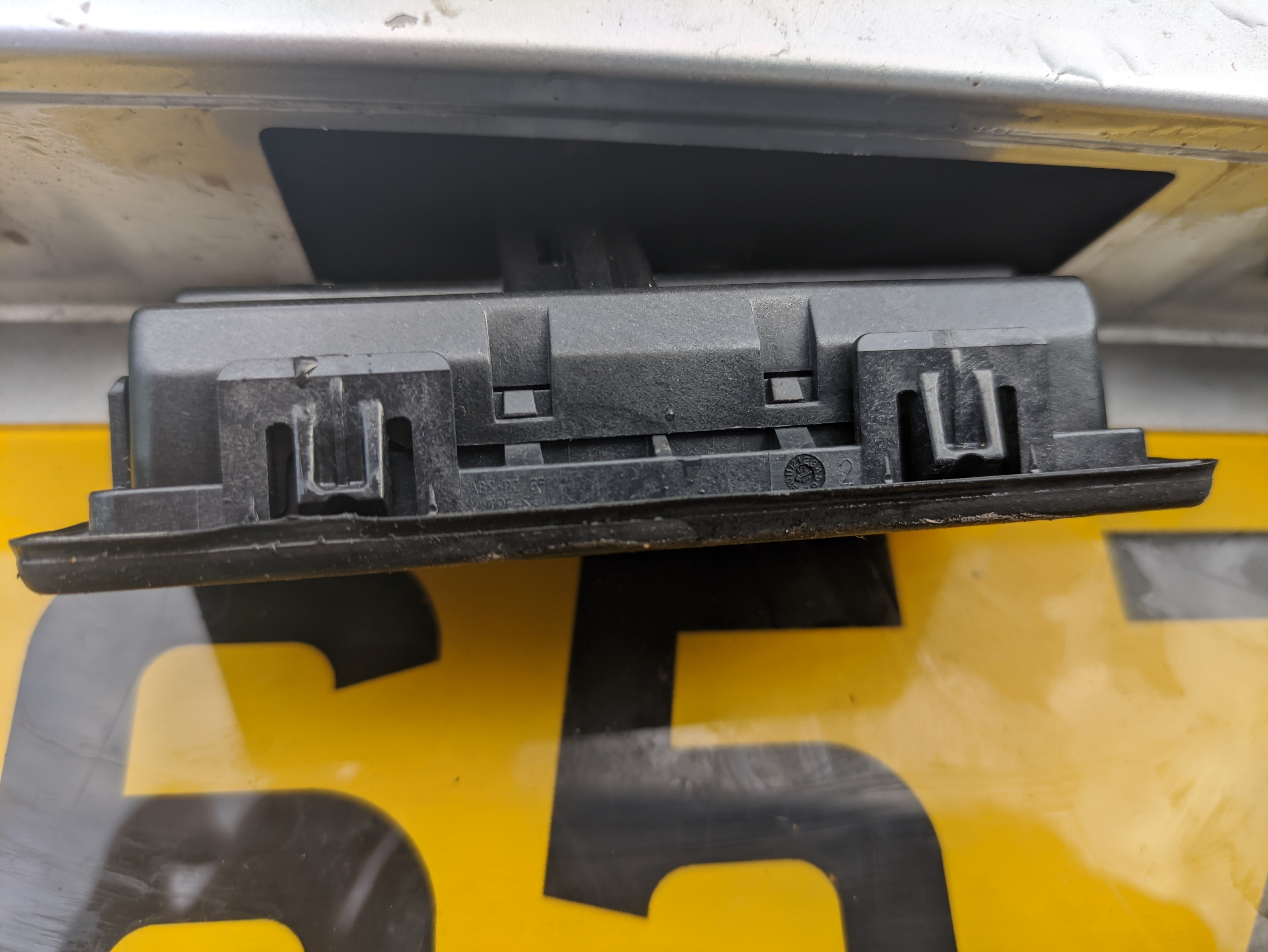

  4. Great help on this forum guys. I ordered the same part 3V0827566 for my estate. 40 pounds on ebay. Fitted it today, 5 minute job. Slightly different to remove so have put in photos in case it helps others. I too used trim tools to lever out.
