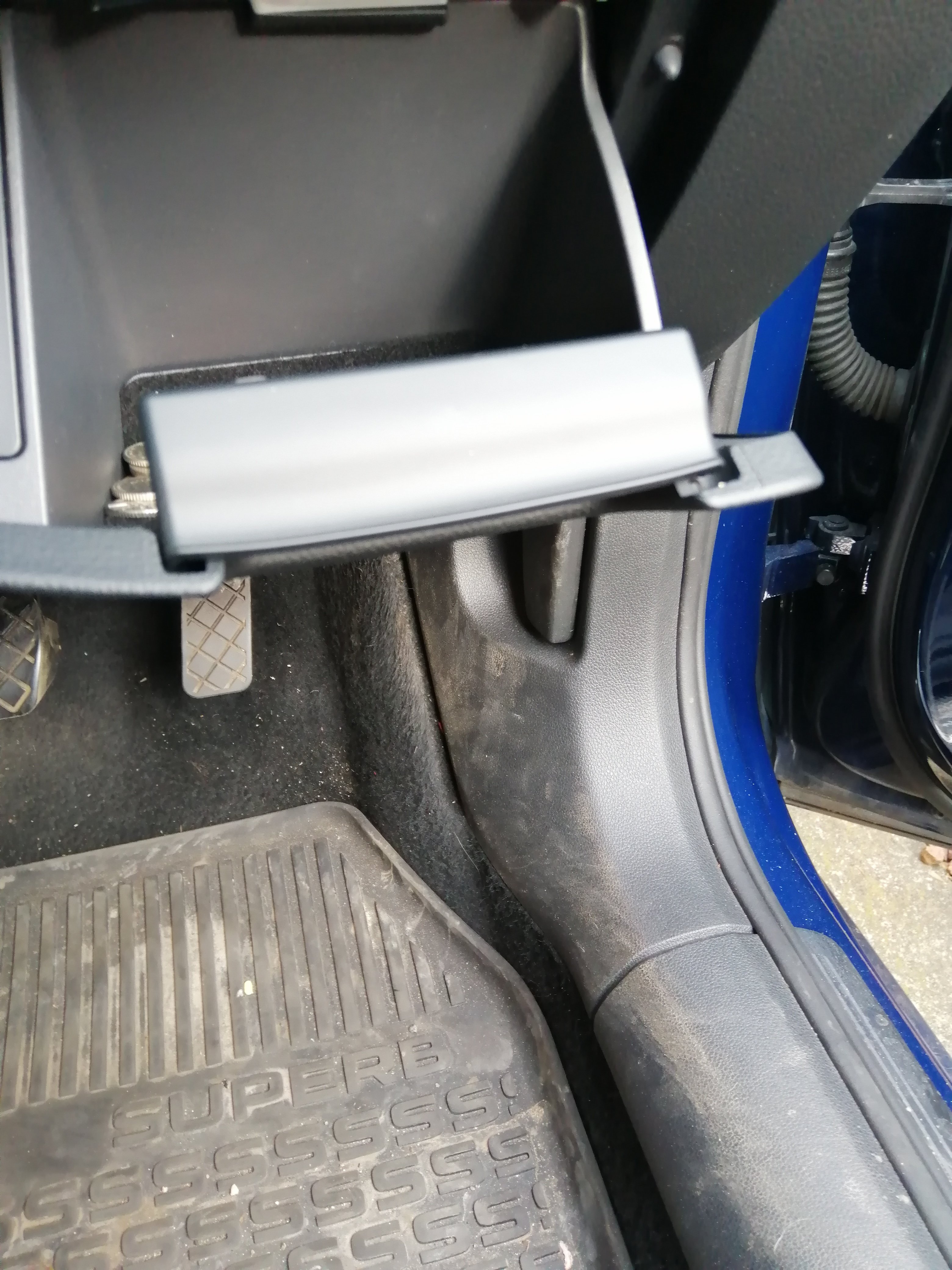

coin tray on the right hand side of the stearing wheel

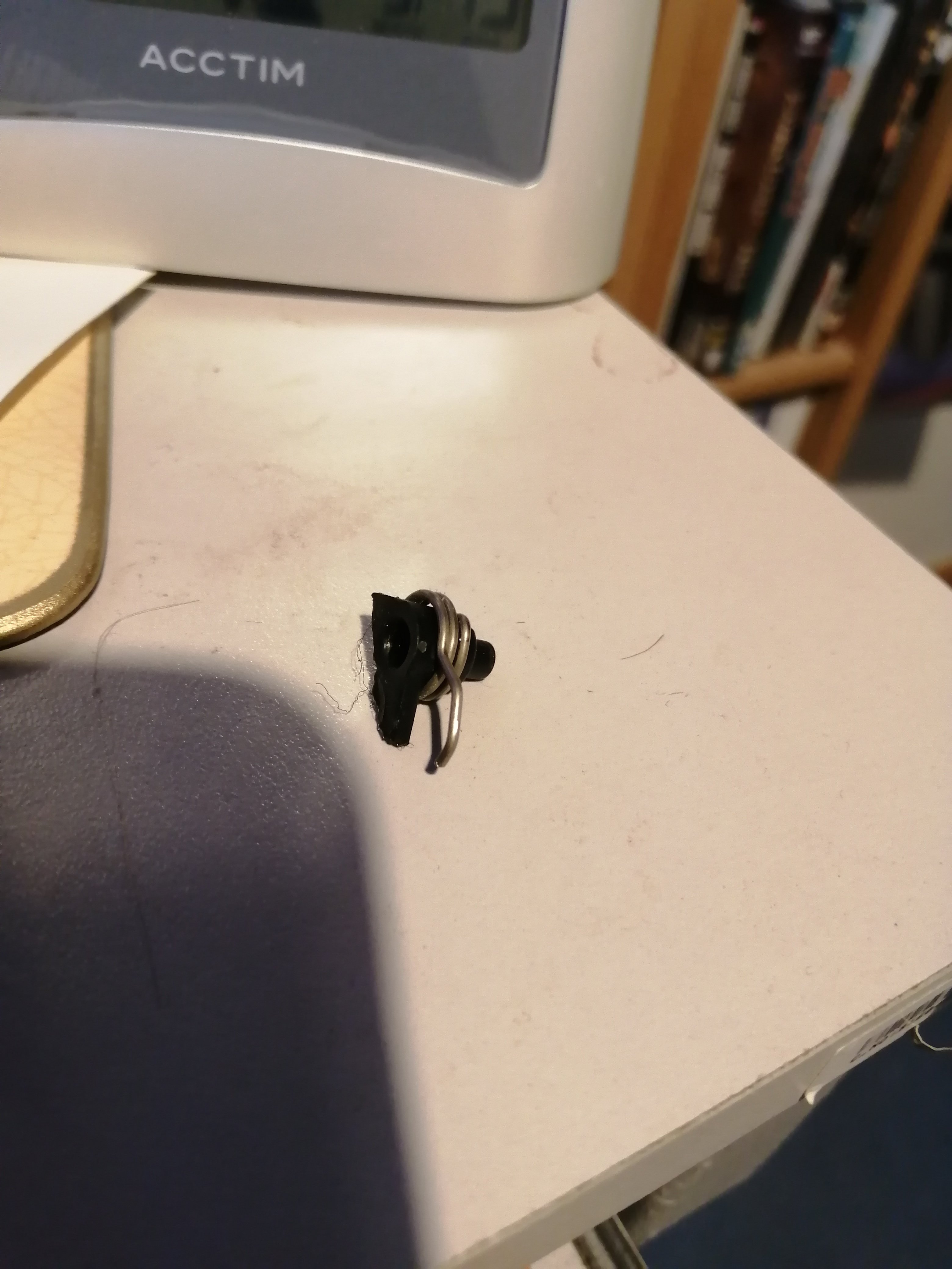

my coin tray is held shut with blue tack because the plastic post on the opening tray broke can i get another opening piece of plastic only if i buy he whole tray  at the cost of £180 come on skoda  what a ripoff

The clip is broken
Plastic opening catch cannot be bought separately

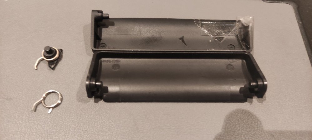

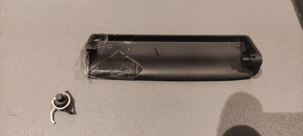

Epoxy it back in place?
Well it's worth atry
Bought my car and it's an ex Taxi-- the tray catches were well worn so I ended building it back up using layers of superglue and plastic... No way was I paying Skoda anything for a replacement.
I don't use it so I just keep it shut took a few coats and a big bit of wood to use as a wedge..
Used a really good quality glue can't remember what it was but apparently it works under water...

I broke mine exactly the same way.  Just got a replacement from someone breaking a Superb on Ebay, was £20 for box and catch including delivery if that helps.

Mine has also gone. So, it would appear to be poor quality. Car is 7 years old.  I purchased a replacement for a left hand drive. Assumed it would fit. But too small. It attached but struggled to keep it closed.
Replacement from Ebay. Slightly narrower. The spring is different. Once fitted it failed to keep closed. May just have to glue it.
