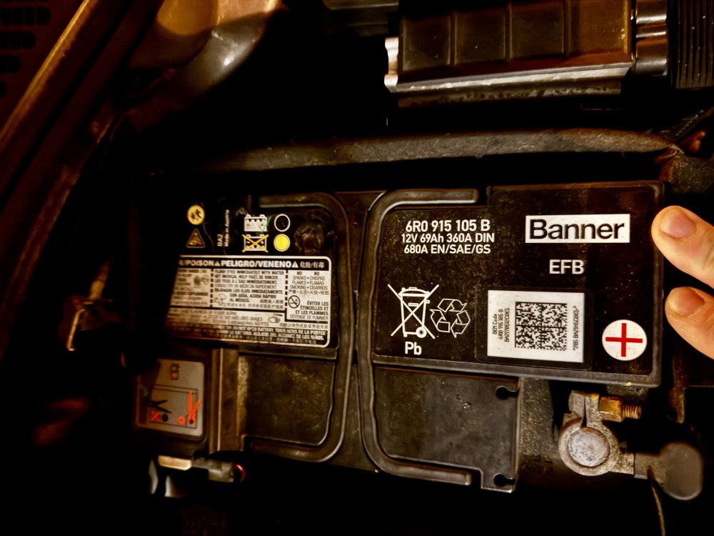

  4. @Warrior193 : if I take into account that my original Banner has lasted me since 2017 and I guess is still going quite ok, I tend to say EFB is pretty solid. My main concern is that, with the upcoming winter and as I don’t usually use the car, I’d get into trouble when wanting to drive one morning… this is why I would consider replacing the battery now, when I’m not under pressure. And to maybe avoid having low voltage errors. And, what are the minimum values for battery health, SOH, voltage etc. when one should consider replacing an old battery. For example, it the shop says battery is stil around (let’s say) 65%, should I change it?
  5. I’m the first owner of the car and bought it from the Skoda dealer. Never changed it. Of course I’ll go and make the proper coding, but I was wondering if AGM is worth the money and to figure out why one of the shops mentioned that for non-frequent use EFB is better. Also, I guess either Exide or Banner would be ok - found some 70Ah - 760A as I recall so a tad more than my current one
  6. So, my 2017 O3 1.4 TSI still has the original Banner EFB battery. 120k km so far, mostly long ad rare drives (could be almost 2-3 weeks of car just sitting). S/S does not work unless in summer and after a very long holiday drive, but otherwise car starts with no issues and no warning about low voltage. Tries measuring the voltage after almost 2 weeks and it read 12.3V (I know therte are other important metrics involved, don't have a smart battery tester). So, as winter is approaching, instead of buying a jump-starter like 70Mai Midrive and then having also to replace the battery, I'd go directly for the battery change. And, if you agree with me 🙂, should I stay on EFB or go with an AGM battery? (one local shop told me to stay on EFB if I don't drive the car more frequent, but I'm not sure this is true). And, second question, Banner or Exide? Thanks!

  14. 7 1/2 years old Octavia here, 95% long trips, but with longer periods between. S/S is still active but only after longer trips. Battery voltage is 12.4 checked with a multimeter) and whenever I don't forget toc check in Skoda connectlite, I see the same value - when stopped, ofc. No other electrical issues so far. I'll see if I have the time to replace the battery before winter time or wait until spring... Thanks for the information here to know what to ask for coding, as I won't go to the dealer (checked prices and for a replacement it's almost double for OE and +50% for other battery type they can install (I think Exide). When the time comes I want to go with Varta AGM and I see that there are some decent garages that have the new A7 type, so technically the battery should be newer and not "suffer" from improper storage on their shelves.

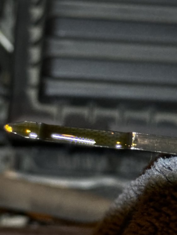

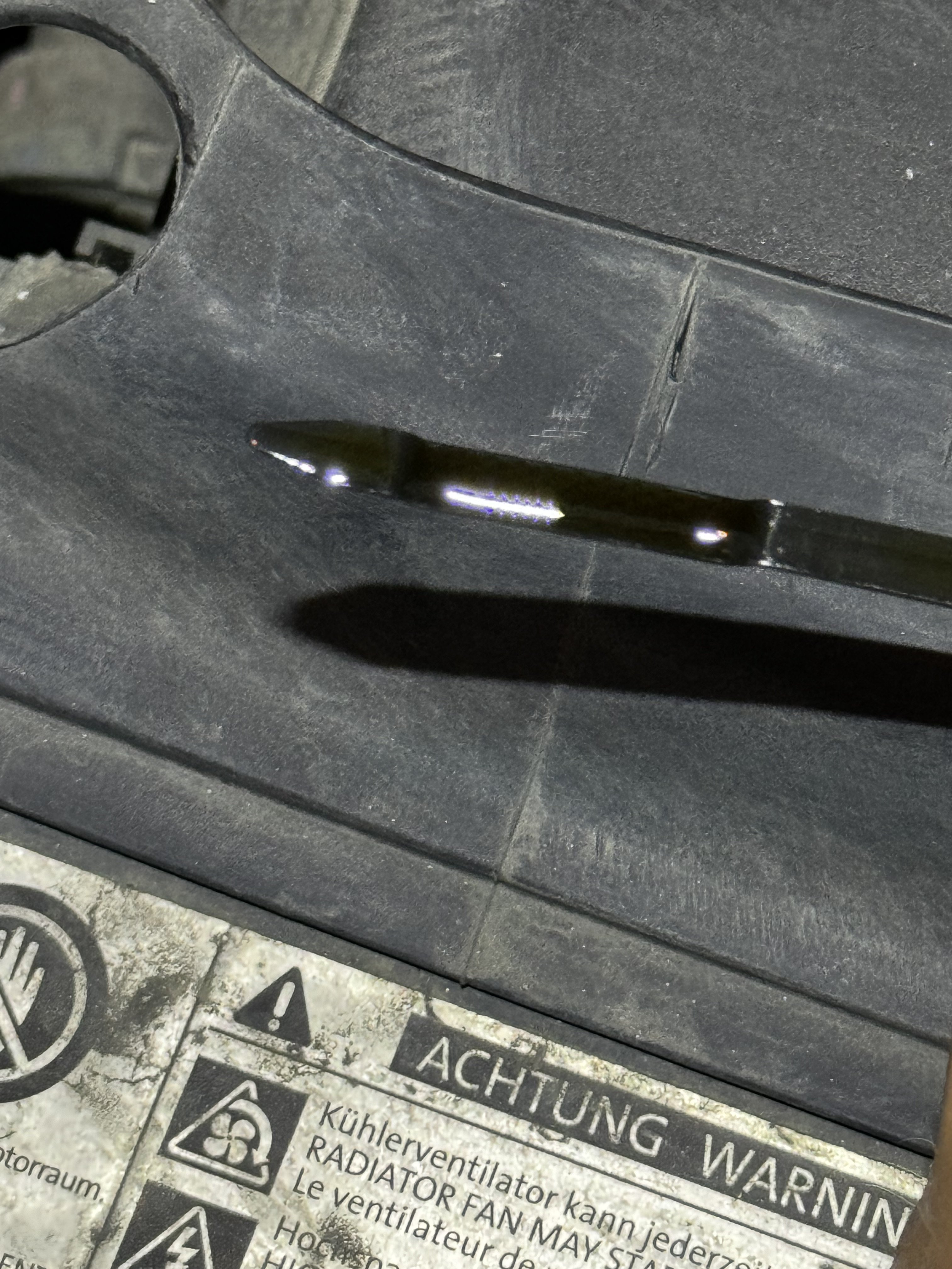

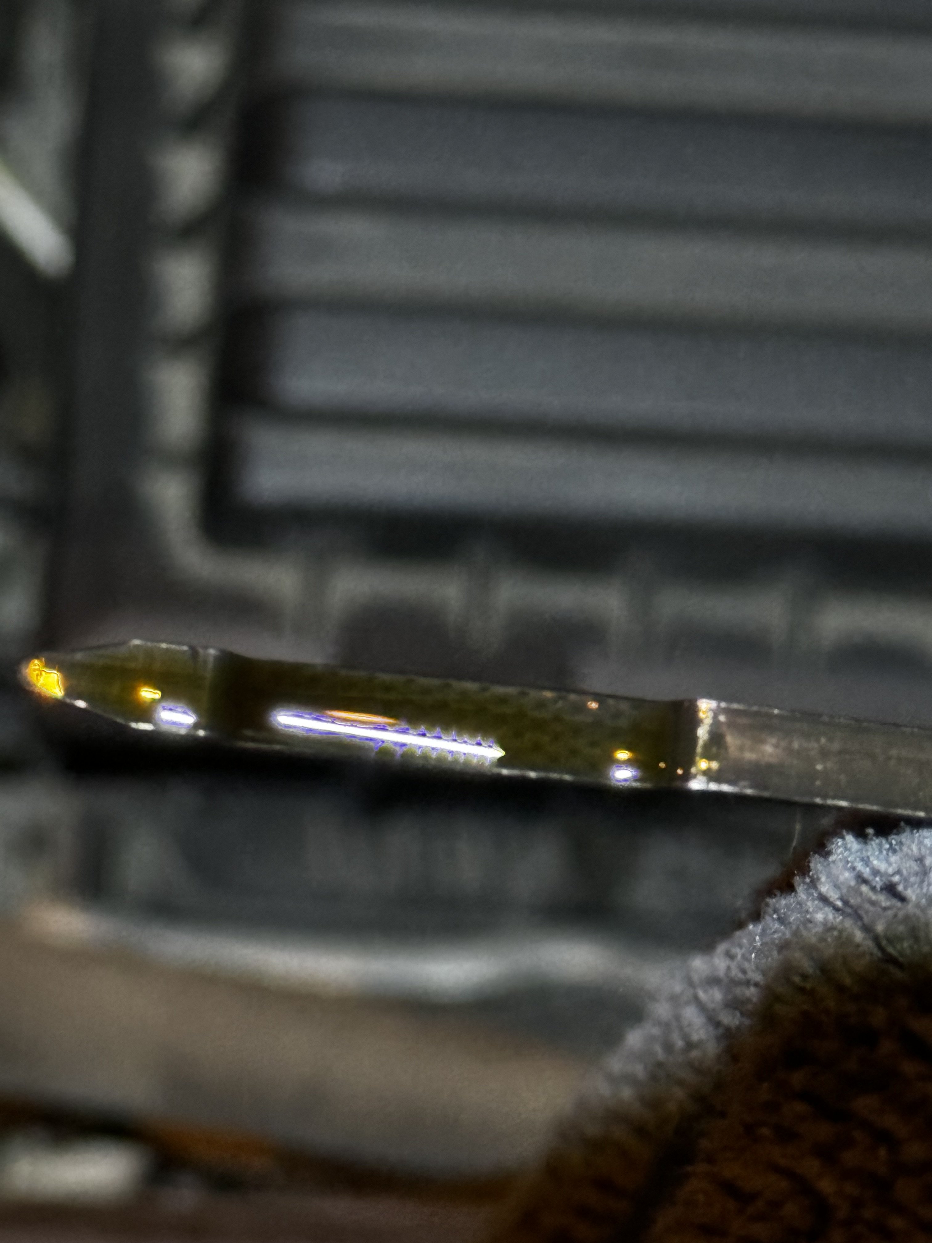

  20. This is how it looks. Should i worry?
  21. Ok so this means now they’ve put too much. They said that the program shows for 1.4 tsi 2014-2017 4l but they added also 250 ml to te at max. I’ll wait till tomorrow to check again but after leaving the service I saw it was just over the max line
  22. Hi! Went for the 1st oil change after warranty at a (rather reputable) service outside dealership. Just wanted the ouil change. First they only ordered just 4l of 5w30 Mobil1. And were like it’s too low. I said that the dealer always ordered 5l and only consumed a bit from the 1l can. Mechanic went to speak with somebody and came and added round 250ml. But now it seems like the ould is just above the max line - and I only checked with engine just after running so maybe when it cools down it may be more? (My parking spot in not leveled, I will try tomorrow to go park somewhere else and to let the car sit for 2-3 h before checking again) But just wandering why they only ordered 4l of oil - what the manual says? - I’m pretty sure that always the dealer put more than 4l.
