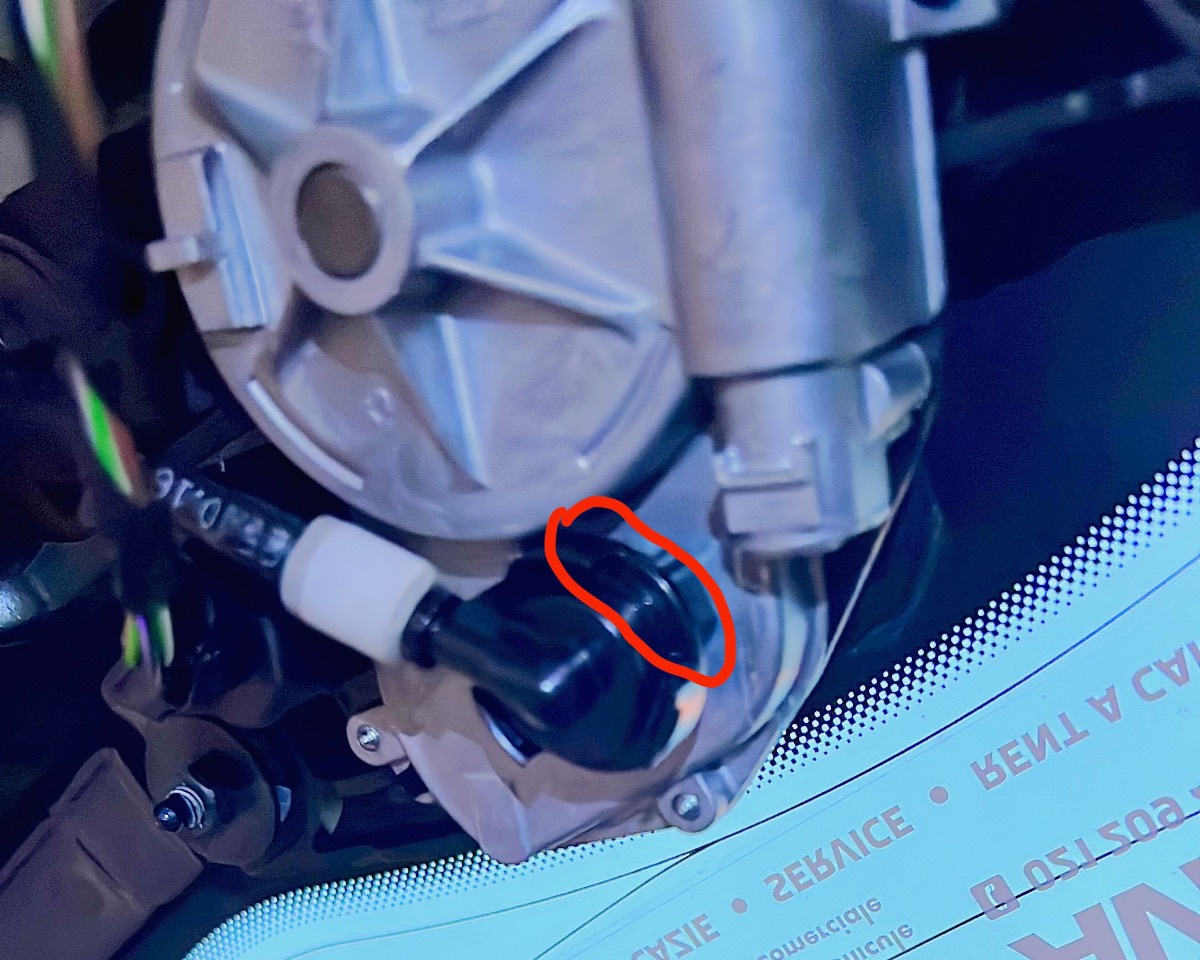

Today, after a drive through town, I noticed that I had a little liquid in the trunk. Looking more closely, it was the protective cover of the tailgate that was wet. I managed to unscrew the whole cover and the liquid is gushing out next to the plug from the motor - not the white coupling, but the black one attached to the motor.That plug moves as if there is no grip between the 2 parts . Video here: https://imgur.com/B8vnBnT Liquid flows normally from the wiper and the rear camera, but it also drips quite a lot here while functioning. Will a new motor be needed? or is there something that can be done.. Thanks

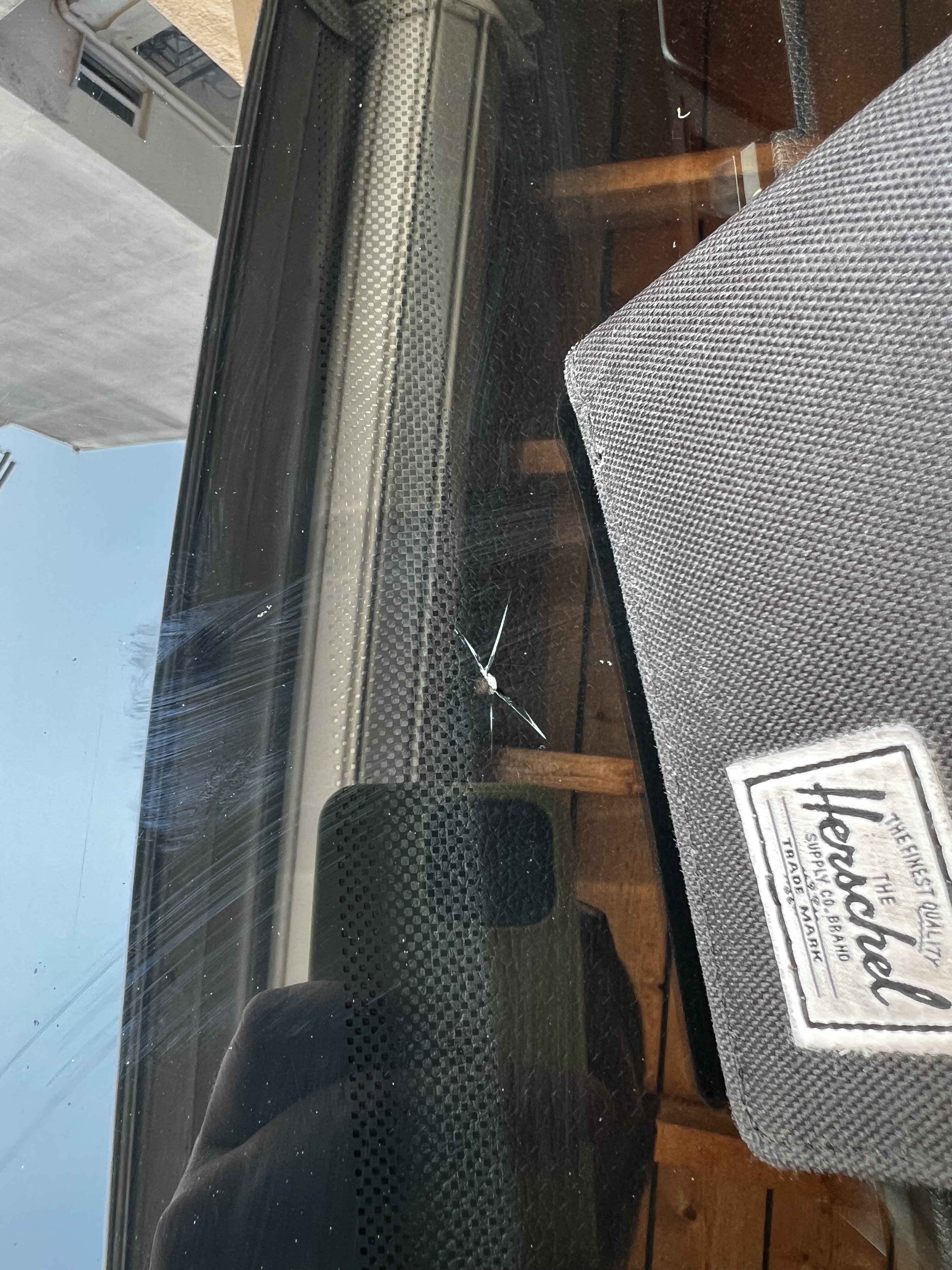

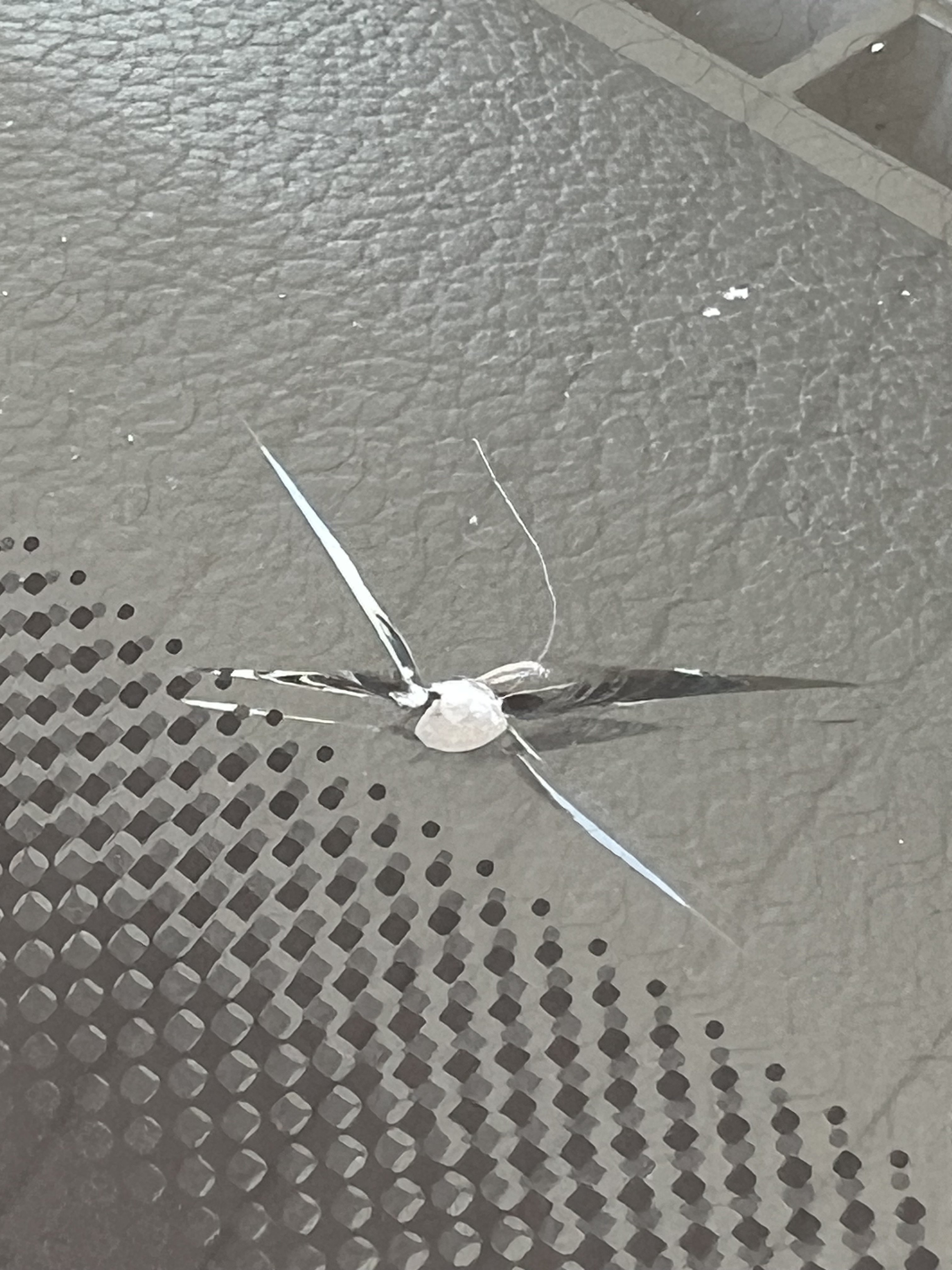

Whilst deiving on the highway (in a foreign country, on the way to the holiday hotel) managed to “catch” a stone and this happened. Have spoken to a guy and said it’s not 100% sure a repair would work. On top, is there a problem as the windshiled is heated (can the wiring be affected)? So, what do you think - can it be repaired?
