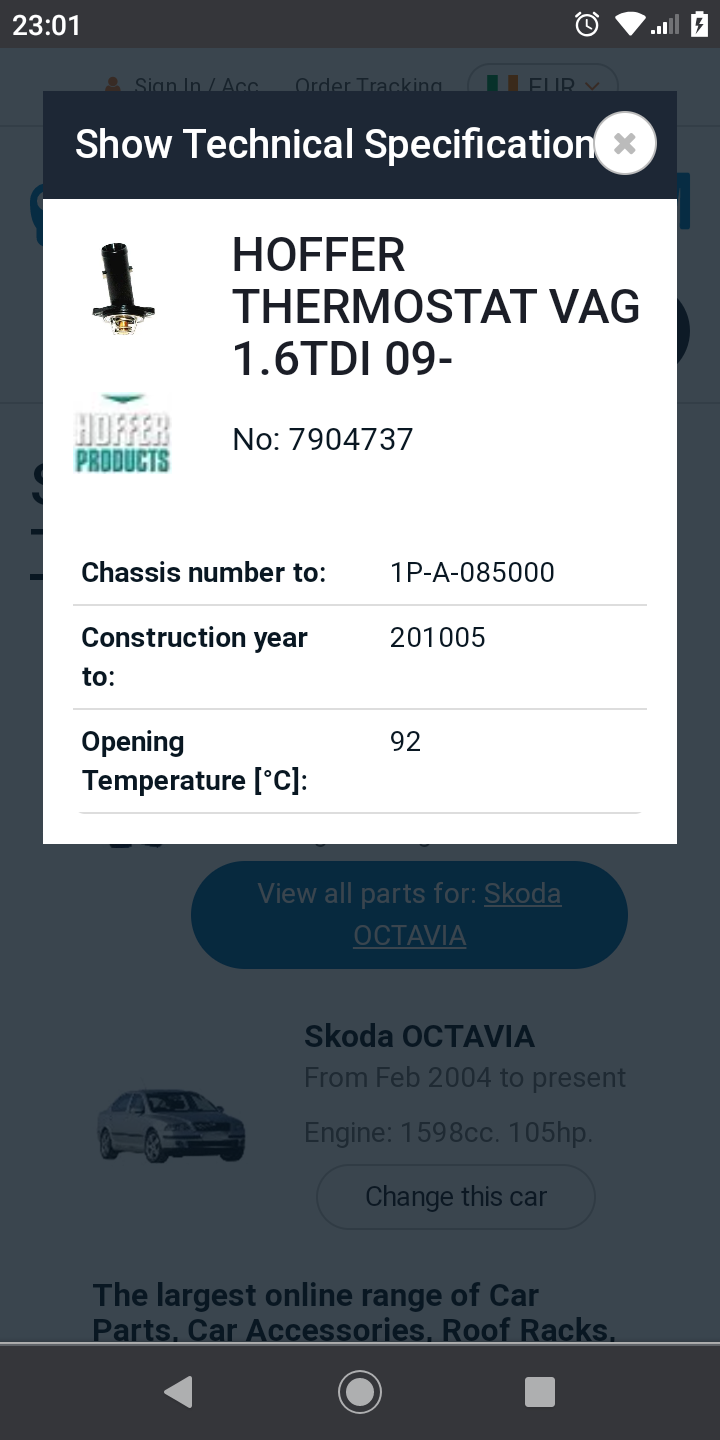

  1. So update , got the egr replacement skoda part cause it was throwing up a fault and going into limp mode . and a non skoda part thermostat and the temps are reaching normal ,90 for the coolant and , around 100 degrees for the oil , cost 750 euro for the whole job and a heard it was a headache doing it 🤣 8 or 9 hours I think
  2. Yea that's what I was thinking it shouldn't be going up and down constantly does that part look something like this
