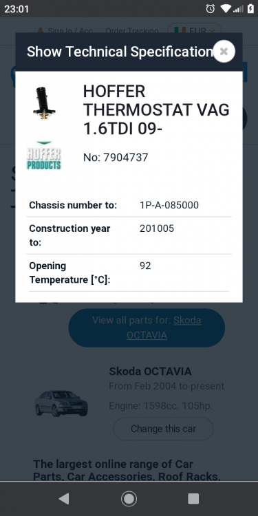

Yea that's what I was thinking it shouldn't be going up and down constantly does that part look something like this Screenshot_20210220-230108.thumb.png.106fb8e7523c9a926d0a6ae3fe03ceb1.png

So update , got the egr replacement skoda part cause it was throwing up a fault and going into limp mode .  and a non skoda part thermostat and  the temps are reaching normal ,90 for the coolant and , around 100 degrees for the oil , cost 750 euro for the whole job and a heard it was a headache doing it 🤣 8 or 9 hours I think
