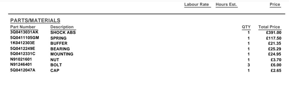

I got this list from my local dealer but sourced the parts from elsewhere for obvious reasons. Actually not everything, I got top strut mount with bearing, springs, shocks,  dust covers, and stabilising bars, think about £600 so far , plus about £200 worth of new tools.
I assume the buffer is the foam stop you mentioned Screenshot_20240517_073918_SamsungNotes.thumb.jpg.3c0e4877bda7cff26395d6383cb44afc.jpg

Dealer prices were always stupid but your £600 made me fall of my chair, I did mine 2 years ago, new struts were £30, maybe £34 each from an Ebay seller in Ireland, pair of new  top bearings and mounts IIRC £20 from a private Ebay seller who didn't use them, springs I have only ever paid around £17 each from Lesjofors, the foam bump stops were less than €2 from Autodoc.
I can see how things have changed now, I was looking at rear brake discs last night, mine I replaced 4 years ago and the inner face of one is scored prematurely after 55K miles, I noticed last night while changing the prematurely worn pads, now I know why!
I paid around €15 per disc last time, most are 3 or 4 times that price now and I had to look really really hard to get down to €25 each.
Monroe DCC Shocks were £130 each from GSF, (£260 total)
Springs, top mount, bearings, dust covers, came to about £330 from Eurocar parts.
I couldn't see how I could do it much cheaper tbh, I think it must be inflation since you did yours last.
I forgot to mention the stabilising rods that were recommended to change , that was part of the Eurocar part bill
