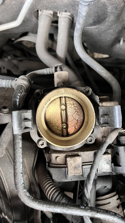

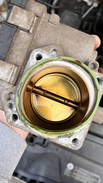

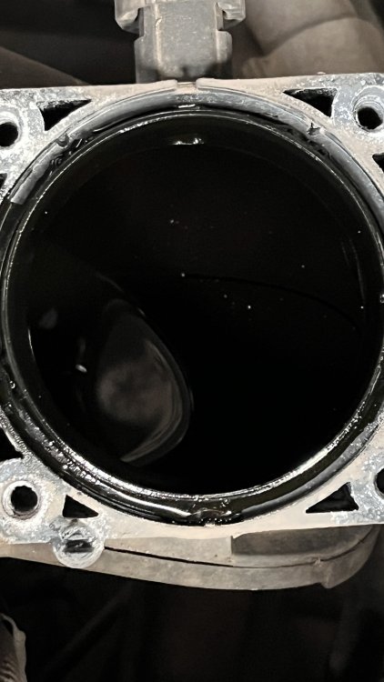

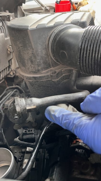

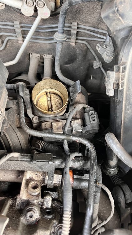

Additionally, i cleaned the throttle body yesterday. You should have seen it! Underneath the tb is a pool of oil! This has dirtied the tb. There is also oil that has got onto the engine area. Possibly through a pipe which looks like some sort of overflow outlet (see photos).
For a few years i have smelt what smells like fuel or exhaust fumes coming, through the interior fans, quite quickly after idling in a static position or reversing. I thought it was part of the exhaust that needed tightening up and I'm sure it was made better when i asked a previous mechanic to tighten things up before. Lately I've not smelt it so much but now I'm wondering if it is this pool of oil?
Could this oil be too do with the pcv valve (i think that's what is called)?
What do people think about it all after reading this info and looking at the photos?
Sorry Tb top
Dirty tb bottom
Underneath tb with oil pool
Done kind of outlet, possibly how the oil has come out onto the engine?
Oil all over the engine
