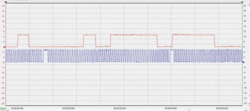

Hi, I also have an engine CBZB 1.2 tsi, and Im nervous about if the chain rattles to much, It only has the strong rattle at sartup for 1-2 seconds, and the it quiets down, but off course Im still able to ar thhe chain rotating. Mine is from sptember 2010, ad the engine control is a simos 10.10, but i simply cant find the value for chain elongation you are writing about. Eg. your chain was 3.4 degrees out. Is it only in newer versions of engine control this is possibe ? I have other values, relating to adaptation between crankshaft and camshaft, and therefore they say something (nut i dont know what) about the length of the chain. Anyone can explain whet these degrees means ?- No One can tell me how these values from camshaft timing relates to stretched chain 1.2 tsi
Yes it looks like this and the signaledges must come from the camshaft sensor - but pls. clarify what the amount of degrees referring to ?- No One can tell me how these values from camshaft timing relates to stretched chain 1.2 tsi
But those values are more or less static. They dont change when reving engine, so the adaptation is like very slow changing, which also seems right as the chain elongates very slowly. But whar i would like to know, is like, what is "intake_camshaft_adaptation value_signaledge 2" = 5 degrees. Is that how far from crankshaft reference position that this mark is on the camshaft ? But then it makes no sense that signaledge_3 is only 0.5 degrees. I would really like to know what im reading here ?- No One can tell me how these values from camshaft timing relates to stretched chain 1.2 tsi
Thanks for telling me that - but can you also tell me what these adaptation values in degrees is reference to ?- No One can tell me how these values from camshaft timing relates to stretched chain 1.2 tsi
Hello Everyone, Im really hoping that a technical expert is able to answer this question. For the 1.2 tsi CBZB engine, stretched timing chains is an issue. And the timing between the crankshaft and the camshaft is depending on the chain has the correct length. I was told by skoda that the ecu is monitoring the phase between the 2 shafts, and if its to mych out of phase, it will turn on engine light. BUT im also told that the engine in fact is capable of running pretty normal even if chain has jumped 1 or 2 teeths !!! I have been looking all available measurement points in the engine ecu, and the only thing i find which obvious relates to this, is 270 X_Intake_camshaft_signaledge_position_adapted_value_Edge2 to Edge8. I think it says something about how much the ignition should be adjusted, by comparing the signals from the crank and camshaft. But whst tdoes the values really say ? In general poeple on the net agree that bigger vaues are not good. My chain has just been measured by skoda, and it is NOT too long. I had another car with the same CBZB engine 1.2 tsi, wich were also mesured chain was NOT to long, also attached. Obviously there is difference in how much addaptation needed for the two engines, Im just sooo courious what this adaptation means ? For my engine it says in another measurement that advance timing for cylinder 1 is 8.5 degrees, and the adaptation values is as follows:- 1.2 tsi sounds like conrod knocking, but workshop inspected they were fine ? Pls. listen
